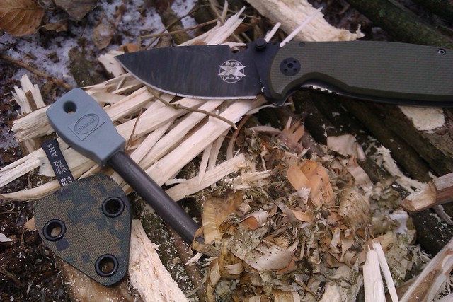

Recently I have woken up to what a difference that a hard squared knife spine makes in using these rods. I used to primarily use a piece of snapped off hack saw blade, which does produce a shower of sparks for me. A few weeks ago I spontaneously bought a tiny Shrade Sharpfinger, well the Chinese version anyway. When I used the thick sharply squared off spine on this knife I damn near fell on the floor ! Great huge gobs of longer lasting thicker burning chunks of rod flew off. What a difference ! I had previously heard of the squared spine tip and tried it more or less with mixed results. I don't like chewing the blade coating off the top of some knives so I took a file and removed the coating on a few knife choils. I recently did this to my ESEE 6, then did the adjacent sides just enough to expose a clear squared edge. It works well. Did the spine on a few Moras as they were uncoated, sure helped. Recently one of the fellows here woke me up to scruffing up my materials such as damp, frozen grass or whatever. Makes sense on multiple levels. Exposing as much tiny fiber as I can helps me with a rod outdoors. I did the pj cotton balls years ago and try to use natural local materials now if I can.

When using just standard dry wood shavings making a large "fluffy" pile with lots of holes for the sparks to go into works best. Not sure which type of rod you are using, and could you duplicate your tinder pile in a pic?

The shavings need to be much thinner and finer than that. Try scraping wood dust with the spine or edge of your blade.

The Polecat has given good advice, the shavings need to be really thin, and some woods work better than others. If you have birch around you, look at how thin the outer most layers can be, the stuff that looks like very thin paper. If you want to scrape some into dust, you'll need a fair amount and something to keep it off the ground, like a layer of dry bark. The moisture in the ground can/will transfer into your fine tinder shavings or dust. Even some aluminum foil will work as a moisture barrier. Keep trying, it always looks easy in the videos, but I doubt anyone started out with instant success. Once you've mastered the basic technique, you'll need to move onto doing it in wet conditions...now that will drive ya nuts!
