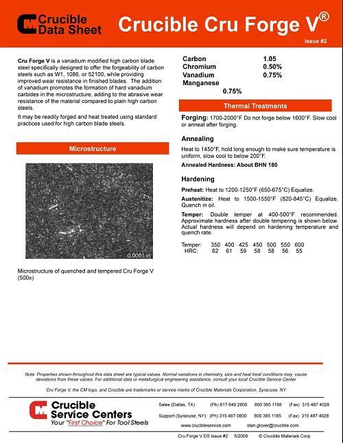

I am trying to decide whether I need to invest in som ht foil or not.
I just HT'd a Cruforge V adze at 1550 for an hour with no foil. The scale flaked clean off with 30 seconds of a wire brushing. Is there a metallurgical reason to use the foil, or is it just to keep the blade from oxidizing?
That flake is the carbon that is no longer in the steel, so you will need to remove this soft layer to get to the hardened one. A foil well wrapped prevent this.
Pablo
Oxygen in the air at high temperature oxidizes carbon which goes off as gas . It oxidizes iron which forms scale. However the steel loses carbon, producing decarburized steel.
1550F for an hour will certainly cause serious decarb --you don't want that !!

I normalized the blade a couple times. Then soaked it 1 hour at 1550 before quenching in AAA.
Two tempers @ 400 degrees one hour each and cooled to room temp each time.

I'm understanding this a little better now. I soaked it for an hour because the data sheet doesn't state any soak time, so I did so to be safe. Would 10 minutes have been sufficient?
If you don't understand something, the best time to ask is before you do it.
The word you clearly didn't understand is "Equalize". That means to bring the steel up to that temperature step until the whole blade is all equal to the oven temp. That takes a few minutes. Most people set equalize steps at 10 minutes when programming, just to be sure. Five minutes is actually more than enough.
So, the instructions say to pre-het the oven to 1200-1250F and put the blade in. Hold it at that temperature until it is also at 1200-1250F. Next you ramp the oven to 1500-1550F and hold it long enough to assure the entire blade is 1500-1550F. They you remove the blade and quench in oil. After this hardening, you temper for one hour at 400-450F, remove the blade and cool to room temperature ( just run water over it or dunk in a tub of water), and put back for a second hour at 400-450F. Cool off again and it is ready to clean up and finish.
Your adz is fine. You will have to sharpen back the edge a good bit to make sure you are in the good steel, but the main surface having more than the average amount of decarb will not matter on an adz.

Your shaping looks good! With an hour soak, I'd worry about massive grain growth. Simplifying things (because that's where I understand them :) ), the coarser the grain, the weaker and more prone to breaking the steel is. If you are concerned enough about it, triple normalize and re-heat treat. You can grind a bit to get past any de-carb that the extended soak caused after normalizing and before hardening if you want.

At those temperature the foil is not necessary, and will get in between quenching operations.
just allow for a bit of cleanup after ht or get some PCB protective compound to shield the piece from the athmosphere
Nice tool!!!
Grain growth is a factor of time and temperature. Temperature is a far greater driver than time.
(not real numbers, but for example) One hour at 1500F will grow a certain of grain size. 15 minutes at 1650F will grow the same grain size. Five minutes at 1750 would make the same result. It is really above 1650 that the grain starts to grow rapidly. I wouldn't worry about your adz.

With a set temperature the grain will reach it's solution % and not grow grains larger for hours (K.Cashen did a comparison soak time up to 5 hours to show the point)...what happens over soak time is that the carbon in solution will spread evenly all over within the grain.
With an higher temperature you'll dissolve more of the alloy keeping the grain boundaries pinned in place, and the grains will enlarge.
The solubility is temperature driven and for every temp you reach a saturation. Once you have reached the saturation point you get a quite stable configuration; for the grain to enlarge, it needs eating more material from the boundaries into solution. If those alloy elements can't be added to the saturate solution, will stay in the boundaries keeping them from moving.
I bet things will move quicker in primitive steels, like before the Al killing process, and i suppose a hypoeutectoid strictly binary iron-carbon steel will exibit a rapid grain growing even at lower austenitizing temperatures.
But for the steels we generally use the only long soak concerns should be about decarburization. Anyway 10-15 minutes is a good soak timing to start with, but it depends on the carbon placement in the microstructure we are austenitizing.

And steels with V and W in them will not exhibit grain growth at the austentizing temps we use. The V and W will pin the grain boundaries. Even at 1550°F (which I would not go that high), I wouldn't worry with grain growth on CFV, even with solid soaks. Steels like 1095, which contain nothing except the carbon and iron...grain growth is more of an issue...as there is no alloying to pin those boundaries.
