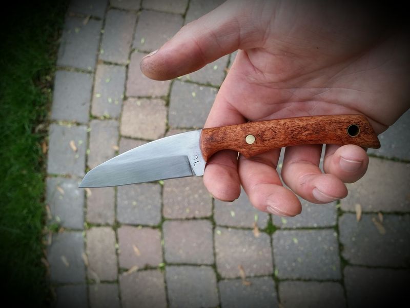

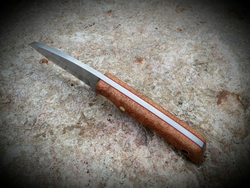

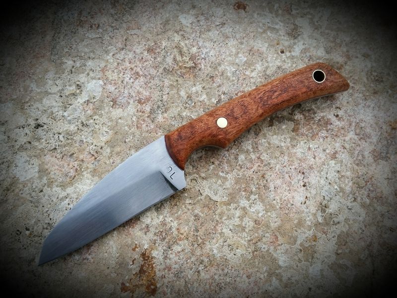

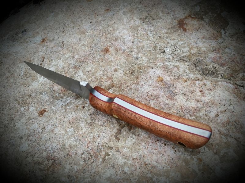

I've made a few knives before but have always had some assistance from others on aspects of it whether it was grinding or heat treating, etc. This knife represents a lot of firsts for me and is the first knife I have made 100% by myself.
It is my first design that i felt real ownership of, from concept to cutouts and several revisions. I've already tweaked it again after this one was made. but i really like it. The changes i made for the next one are a slightly longer blade and slightly longer handle and i also added a little choil. For some reason when i don't have a little choil I have more trouble getting my plunge lines to line up perfect, i think the choil adds a little extra reference for me or something.
The grinds were done by hand with files using a jig like Aaron Gough showed on his you tube video.
It was my first time heat treating my own blades, i made my own propane burner and used firebricks to mock up a little heat treat furnace.
The whole process has been very enjoyable and i have learned a ton by doing this, hopefully I can get better results each time.
The specs are:
2.6" blade, 6.8" overall (The new version is 2.75" and 7")
5/32" thick O1
Handle is stabilized mesquite and red fiber liners.
Thanks for taking a look, let me know all your feedback (good and bad)
It's a very nice job considering your stage of the game. You should be proud.
I like that you are using liners and stabilized materials and you seem to know something about edge geometry. I like what I see in the photo.
A couple of things will go far to improve the desirability of this knife. One is a nice logo and another is a tapered tang. These are small changes that will either take a few dollars in equipment or some effort at the work bench. But it will bump your work up to another level.
Great work. I really look forward to seeing what comes next of the bench.
Thank you for the feedback Lin! I've made selfbows and custom slingshots for years so I gained a lot of experience in wood and especially how important stabilized wood is to use, especially for my laminated slingshots that are constructed like a full tang knife. I stabilize my own wood too, one thing keeps leading to another!
I agree with the logo, I stamped my initials since i didn't have anything else and you can see the "D" didn't go well. :(
Can someone recommend a good place to get a stamp made?
I thought about the tapered tang as well since the balance of this knife ended up a little too much in the handle, but i wasn't quite sure the best way to do it with hand tools other than just winging it? I suppose the same jig i used for the grind could be used if i set it at a very low angle.
Thanks again!

Henry Evers makes stamps along with other folks. As for stencils, you will get a variety of responses. The stencils are used to electro etch the logo. I use a "personalizer plus" machine for mine.
I'm not trying to be closed mouth. I am not sure of the rules. Holler at me if you like by email or something. I'm glad to help.
