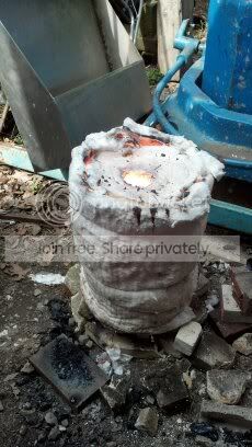

Into a Jeff Pringle special smelting furnace it went. These are field-expedient furnaces made of a quick roll-up of 2" high-temp kaowool rolled up into a "shell" and then a spiral of kaowool rolled up for the lid. All of this is held together with bailing wire and set on a stack of hard firebrick with a plinth of hard brick for the crucible. A quick iron pipe burner is stuck through the side and fed with a shop-vac and propane.

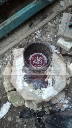

You can see the furnace (in pieces) here next to a cooling crucible:

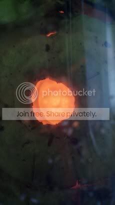

First Wootz puck of the event.
Look at those dendrites!
From a 2kg charge we ended up with a 1.9kg ingot. Not bad yield all things considered.

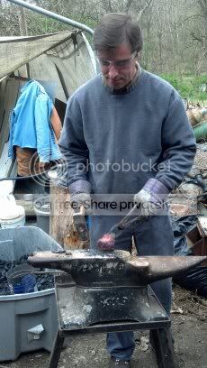

After 2 normalizing heats we cut a section off to test forge. Initial indications point to this being a forgeable ingot, though it will REALLY be a test of my patience to not destroy it. It sparks very well and seems to be quite high carbon.
