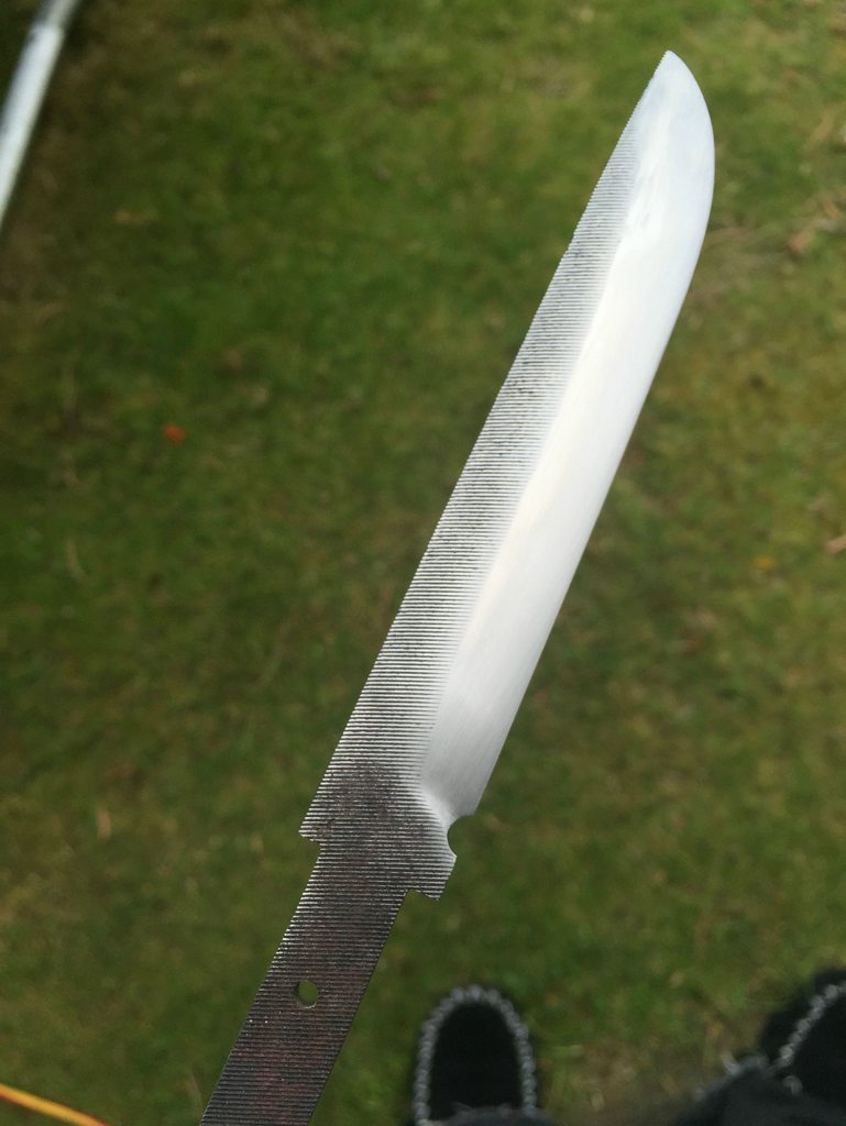

This probably seems ridiculous to a lot of you, considering the works of art I've seen posted on this forum, but I thought I'd share anyway. I decided to dip my toes into knife making by making a file knife with hand tools (I know, I know... But I had an small, old, tool-steel file that was rusted out and clapped out, so I thought it was worth having a go at it rather than forking out a crazy amount of freight for a cheap bit of 1084 or something and then finding I hated the process. I live in Tasmania, so--from my basic research so far--good knife-making steel isn't cheap or easy to source). I annealed it okay, although it warped a bit in the process and needed straightening (picked up a few tips since that might have avoided that). Then I started cutting and filing.
Jesus wept.
If time and energy were money, the number of hours and amount of effort I've put into this so far would let me launch a take-over bid on Jay Fisher. Most of the shape's been filed without even clamping it, as I've been really busy with annoying life things, and found it easier to make the time if I could just randomly pick it up and have a bash. On the other hand, it's extraordinarily satisfying to see this thing slowly take shape under my hands, and to problem-solve difficulties like not even having a vice (or 'vise', as I believe they call it in one of the other colonies). I'm only part-way through this first fumbling effort, and I think I'm hooked. Especially after looking at what some of the members of this forum have achieved in terms of blending functionality and beauty! Where I'm at so far is neither functional nor beautiful, but hopefully it'll wind up being at least one of the two, or at least help me get pointed in the right direction. Once I've got the blade done and backyard heat-treated and tempered, I'll make a mortised and single-pinned handle out of whatever local hardwood I can find scraps of (probably tassie blackwood, as I know I couple of people who use it and might have some nice, dry bits floating around).

Try and remove more material from the bevel.
If you have a steady work surface and clamps you can do it without a vice
Thanks for the encouragement, guys. It's been slow going trying to find the time to do this by hand (juggling kids, work, my wife's master's degree and the fact that my hands still don't work all that well after picking up Chikungunya fever in Java a couple of years ago), but she's getting there. This pic was from a couple of days ago. Tonight I did a backyard heat treat that I think went okay for the first time. No warping or buckling on the edge, anyway, despite taking it down to what I suspect was too thin while I was getting my bevels vaguely sorted. Currently tempering in the oven, which makes my wife glad that I quenched with canola oil :-)

Hey, that looks almost exactly like one I'm working on right now! Mine is a full flat grind though, without a sharpening notch.
Yours looks good though. The grind looks nice and straight.
One thing to note, the 90° angles where the ricasso turn to the tang are not good. The sharp angles there can cause stress risers and can be a point of catastrophic failure under usage. Just take a chainsaw file, or a diamond file and round out those tight inside corners and you are good to go.
That being said, it is a nice looking piece. Congrats!

NJBillK: Thanks. I was using a video by Walter Sorrels for most of my tips, and I'd already filed them at 90 degrees before I read something similar to your advice above. I got impatient, though, and tried to compensate by not letting the handle area heat up too much in heat treat, and only quenched to just past the plunge lines. Chalk it up as one of the many, many lessons I've already learnt by doing things wrong the first time!
