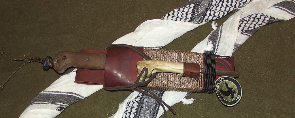

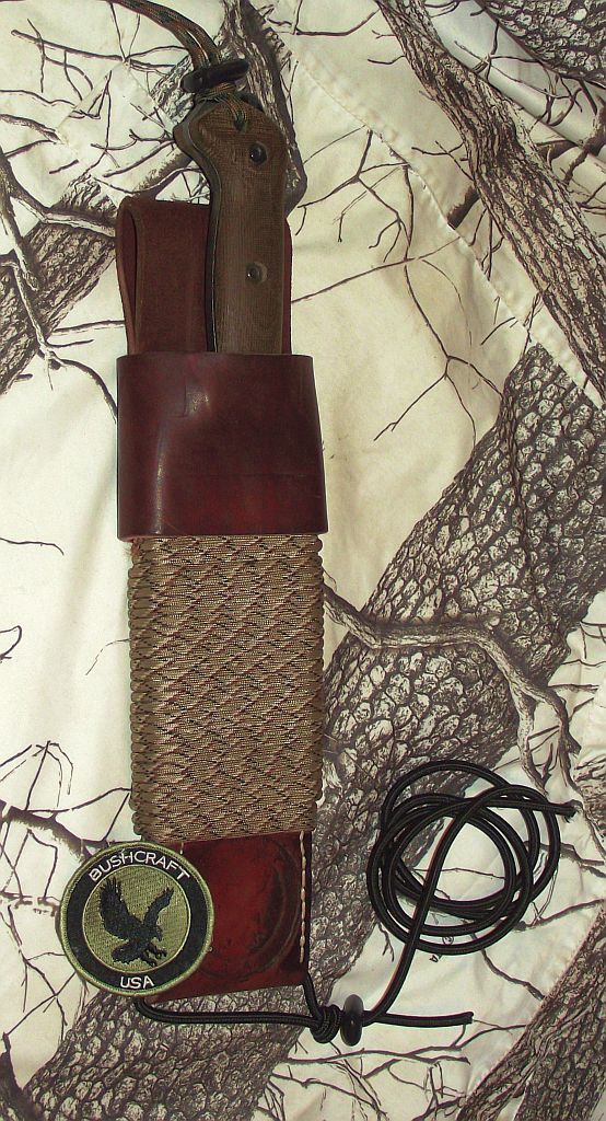

After talking to Moose last week about a leather sheath and options, I decided to try to make one for my BK9. I learned pretty quick that I am no leather worker but the end product suits me fairly well. Still intend to get one of the M1s for my 9 but I'm fairly satisfied with my efforts for now.
I used some saddle leather in layers, double stacks of it on the edges and a collar for where the handle sits when the blade is sheathed for a bit of retention. Again, I am not a leather worker, but my end results are satisfactory for my needs. Stitches in thick leather stacks is a pain in the fingers!

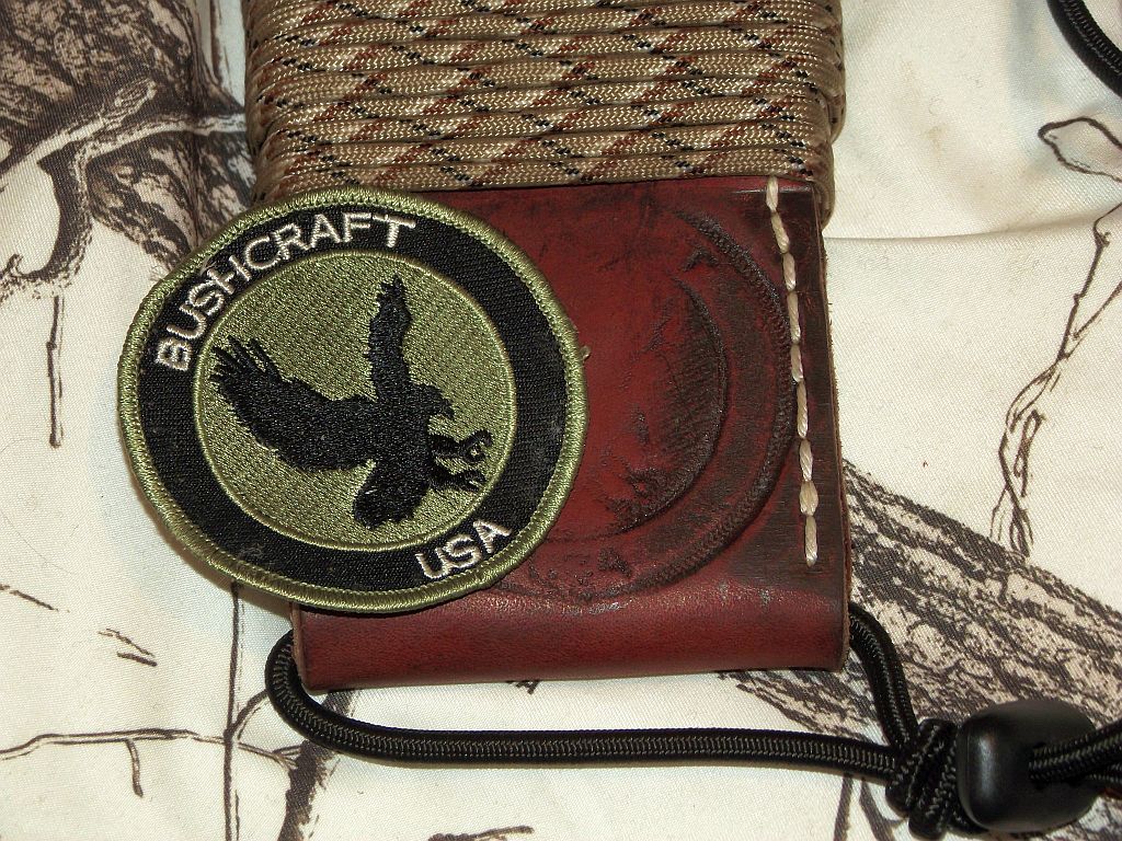

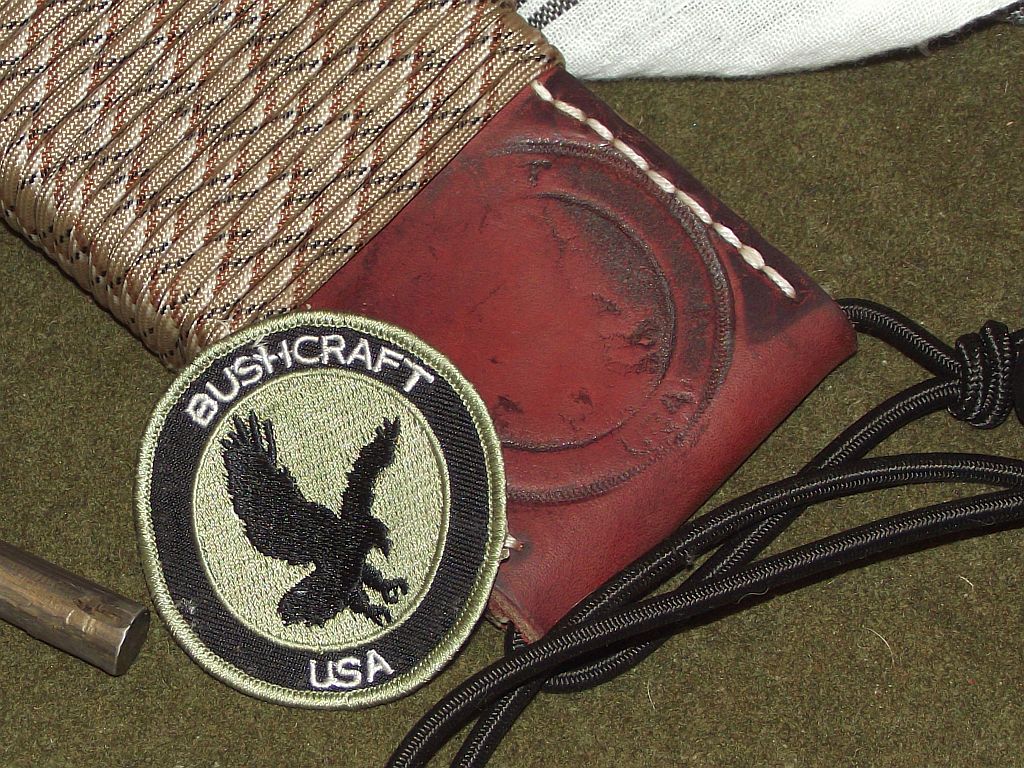

After it was fully assembled I got the bottom quarter wet, placed a BCUSA patch there and then the whole thing into a flat wood vice to press the patch into the leather. It came out okay, I was shooting for the whole thing and what I got was a vintage looking worn away embossing.

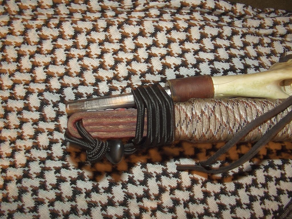

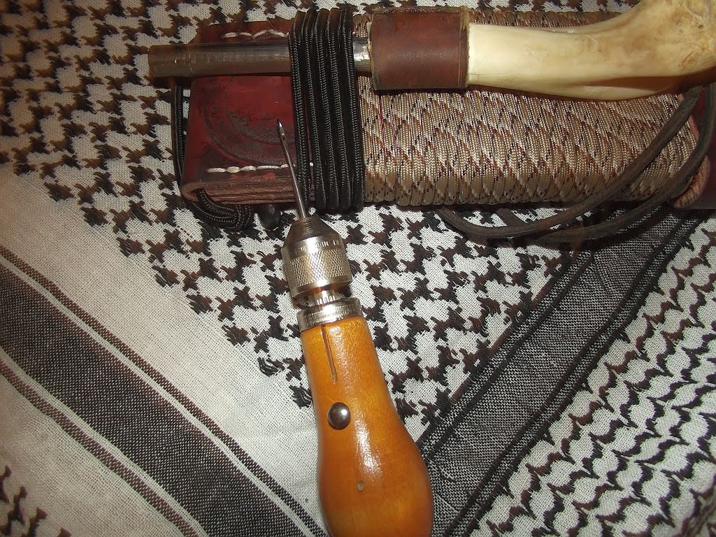

Here is a pic showing the thickness, it's actually four total layers. Last pic is what I used to make the holes and it worked ok, just working the needle through them was painful on occasion.
Forgot to comment on the retention.
That piece that is wrapped around where the blade enters the sheath itself it very tight and formed, even without it I could hold it upside down and shake it via the shock cord and the blade would not come out. With the collar wrap around the first couple inches of the handle it is very very tight.

As a finger saver, I generally use a pair of needle nose pliers to pull the needle through multiple layers of leather. Also, it's easier to sew when the leather is still wet, because it has more stretch.

What I did was lay the knife blade on the latigo, traced the pattern and cut two sets of each side. Laid those up in the main sheath which is a folded piece of the same saddle leather, glued it up and put it in a vice. After that I trimmed and did the stitching.
So if you unfolded the upper most layer you would see the blade shape made up of the layers on either side, this sort of "pockets" the blade so that it cannot move laterally inside the sheath.

One thing to remember, if you are predrilling your holes with a drill bit, it removes material. I pre punch mine with an awl, which just seperates the material, so that way when I seal it, the leather swells, and closed up the holes, pulling the stitches tighter. Just a suggestion, when I first started I used a 3/32 drill bit and a drill press. I got away from the mechanical stuff, so I can truly say, Handmade sheaths. If I had my way, I would have all kinds of presses and stuff, to punch patterns out at will, but, there are other places and people doing that, I just like stiching leather.:D

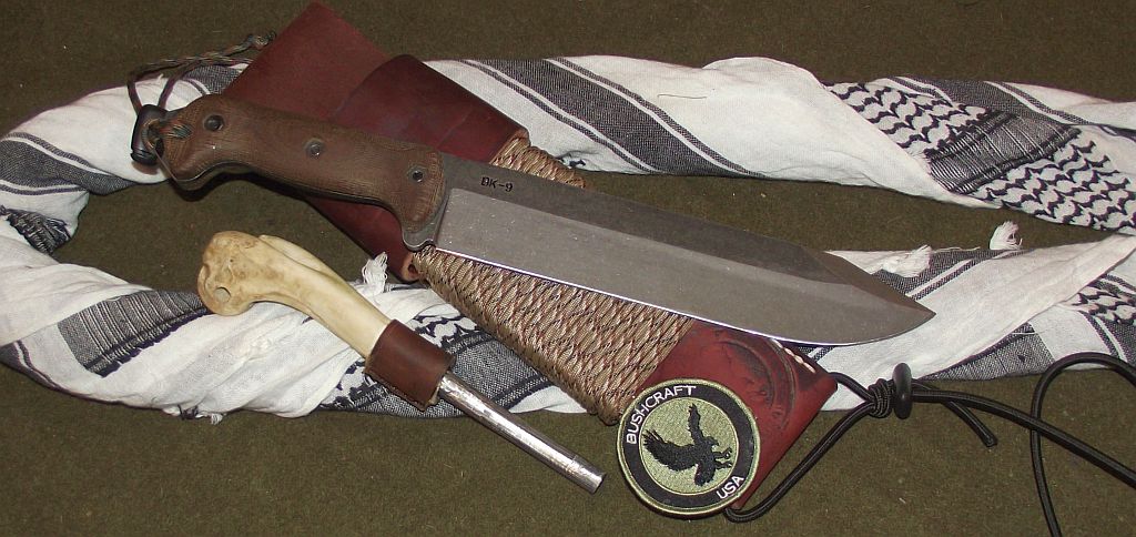

Here is an overview of the process since I am doing it for my BK2 as well.
It's really caveman simple.
It's basically four parts.
The main piece, the cut outs for stacking, the collar.
Find the correct placement for the knife form pieces.
Fold up from the bottom confirming the placement is correct and market for glue up.
Fold down from the top to make the belt loop and mark placement for gluing.
At this point I glued it up with Barge Cement, the stuff is damn strong, flexible and waterproof, the leather will give before the cement will. You probably don't have to stitch it but I did.
I put it in a flat wood vice and let it set up for 24 hours. Then started hole punching to thread it. I stitched up either side including the lower section of the belt loop. I glued it by sections, so glued the stacked together and then to the back, then the fold up from the bottom and finally the top loop down for the belt loop.
I then added the "collar", it looks like this:
Mark it up for placement, I cemented it to the front of the sheath, then punched the holes in either side for future stitching once it was dry.
Folding either side to the back I stitched it and applied glue to the inside, pulled the stitch tight and locked it in the vice.
This is the back of the one I finished:
Because the entire thing is cemented and stitched I feel like it is very durable. The belt loop is a part of the sheath, not a separated piece.
I hope that made sense.:eek:
