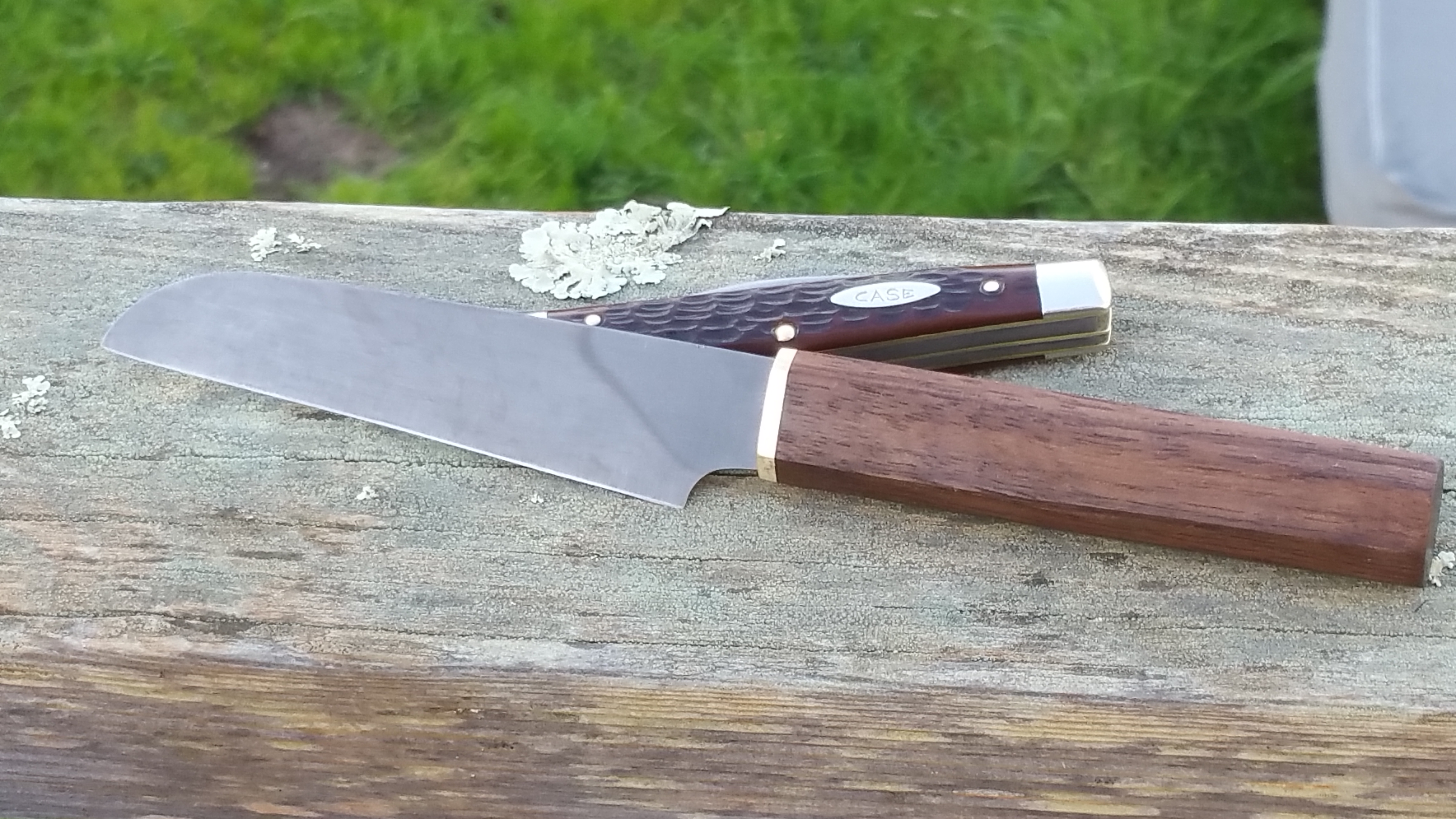

This is my latest wa handle knife, done using the dowel method. Walnut and brass handle, 1/16" 1075 blade about 3.5" long with an ever-so-slightly recurved edge that bites really nicely. I did this handle taller-than-wide, which is nice on a smaller knife but on a big knife I would want an equilateral octagon.

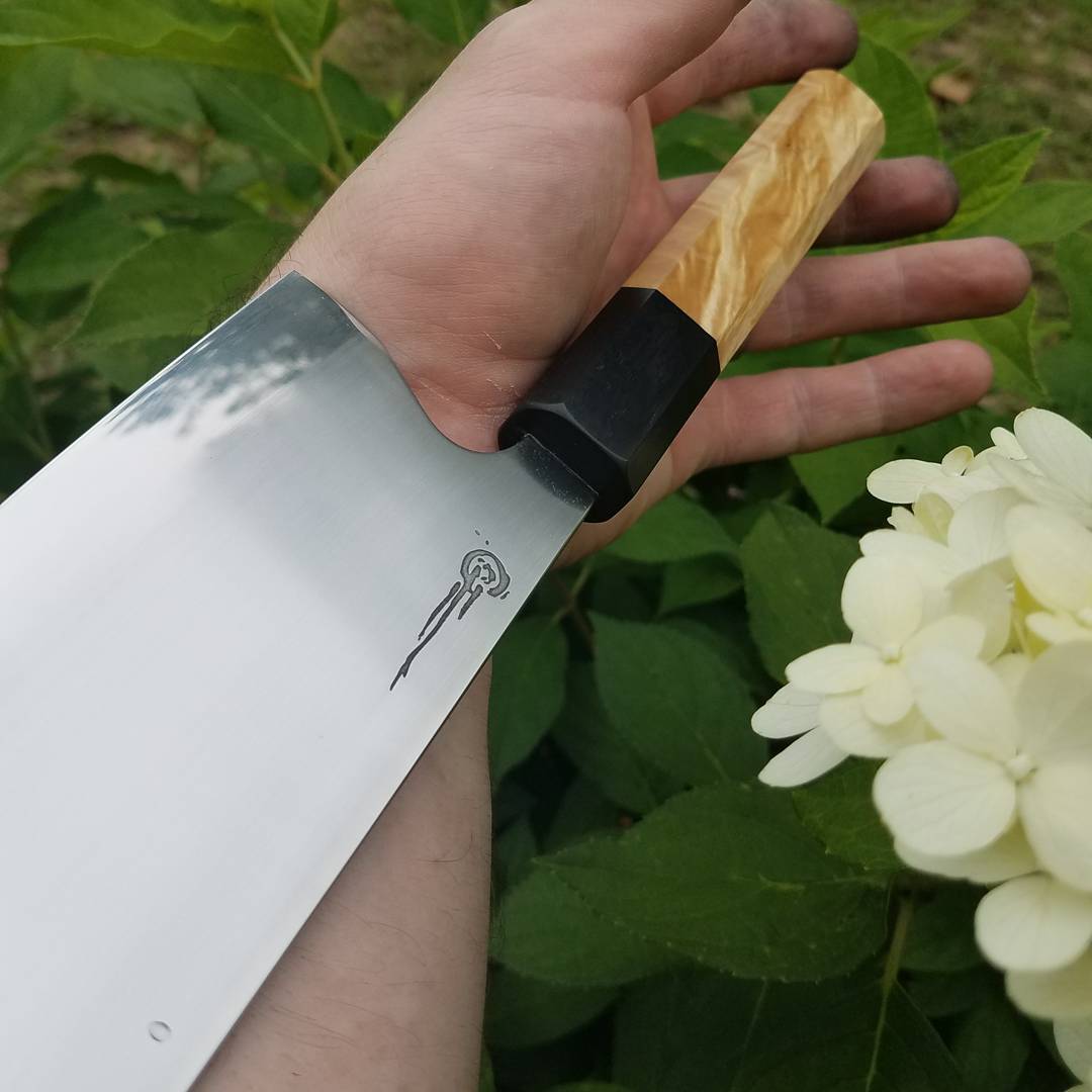

Here are a few if my wa handles. I shape the sides by eye until it looks right/feels right for each knife and then cut in facets. I usually set my calipers for 4-5.5mm and crosshatch the top and bottom of the block to scribe guides for the facets. Imo wa handles are all about feeling amd balancing the knife and there isnt really a set measurement. Most japanese handles are quite large imo. 2mm taper butt to bolster/ferrule is about the sweet spot though and 110-145mn length unless the knife is very large. Most my height/width measurements are close ti what Stacy said. I make mine kind of egg shaped as it feels best in hand.
-Trey
