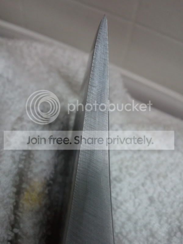

It is a cool look but I agree that it is not a hamon. It kinda looks to me like it was case hardened. The straight portion on the left of the pic leads me to think that way.

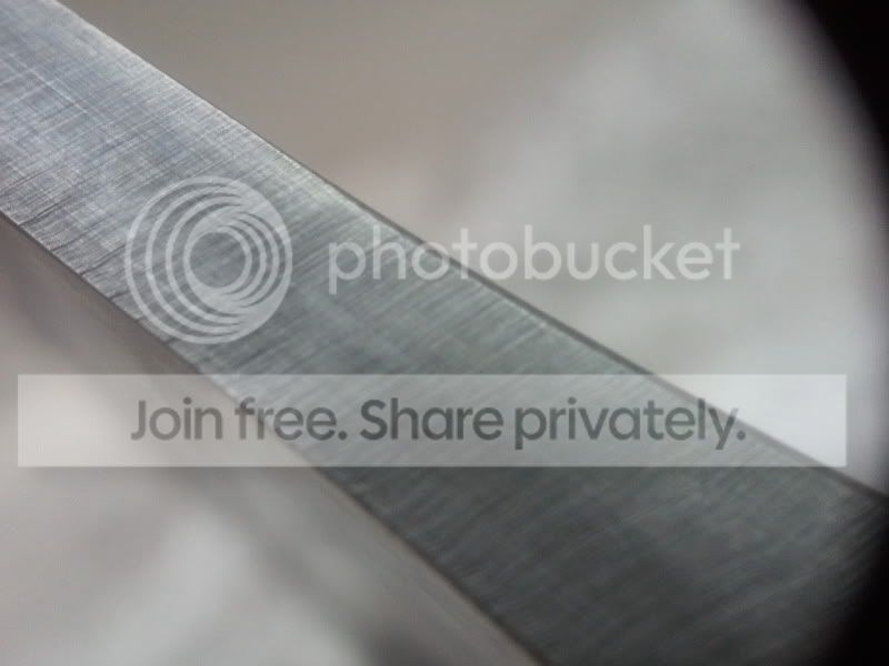

How deep is typical case hardening, or how deep I possible? Because as its sharpened wouldn't it be getting ino softer steel, say .060" deep? I removed quite a bit of steel on the edge due to one nasty chip, and it was hard all the way.
Here are the pics of the edge, first one is a standard close up and the second one is at 10x magnification where the line meets the side.
