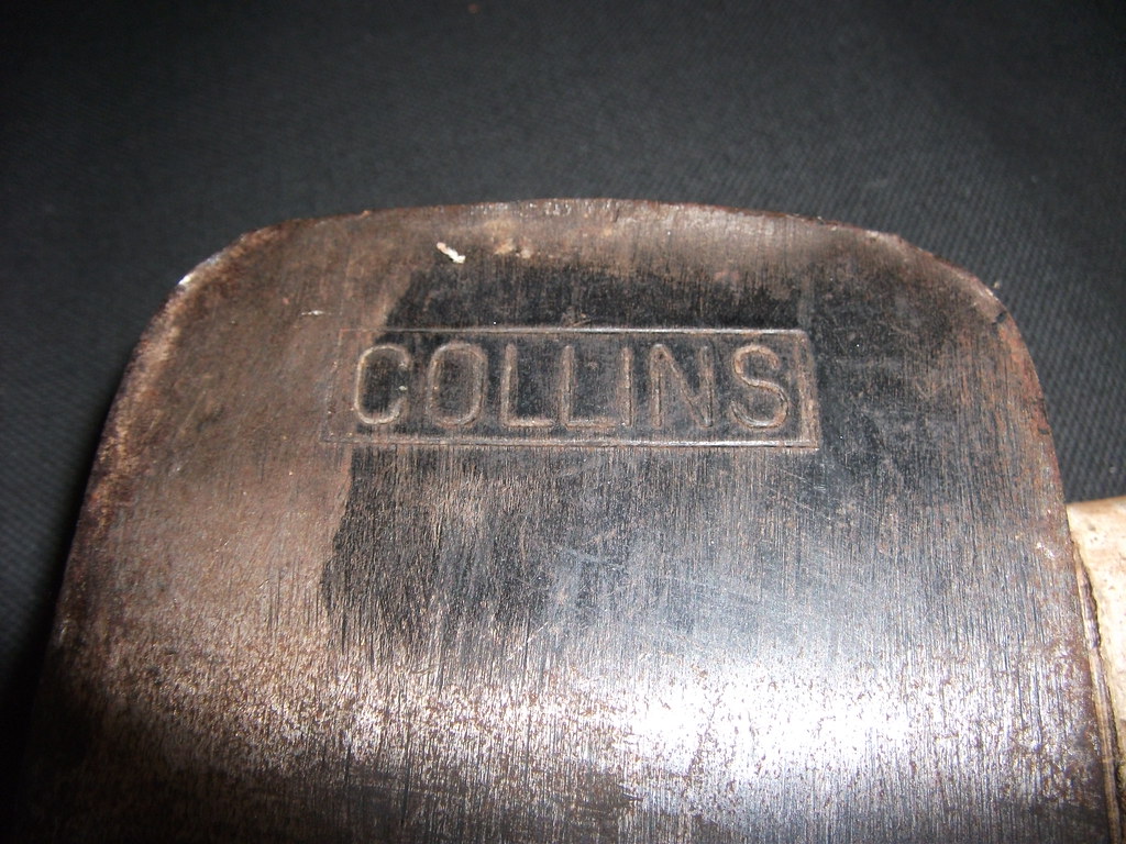

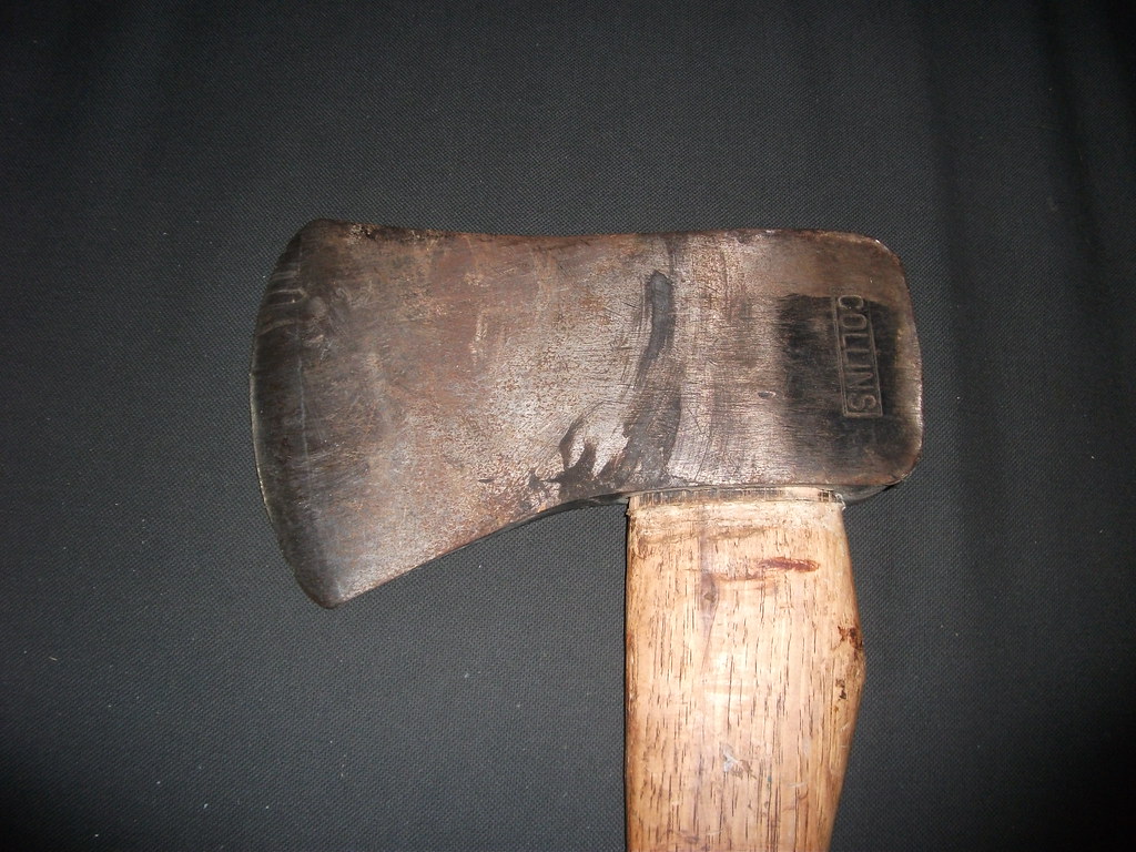

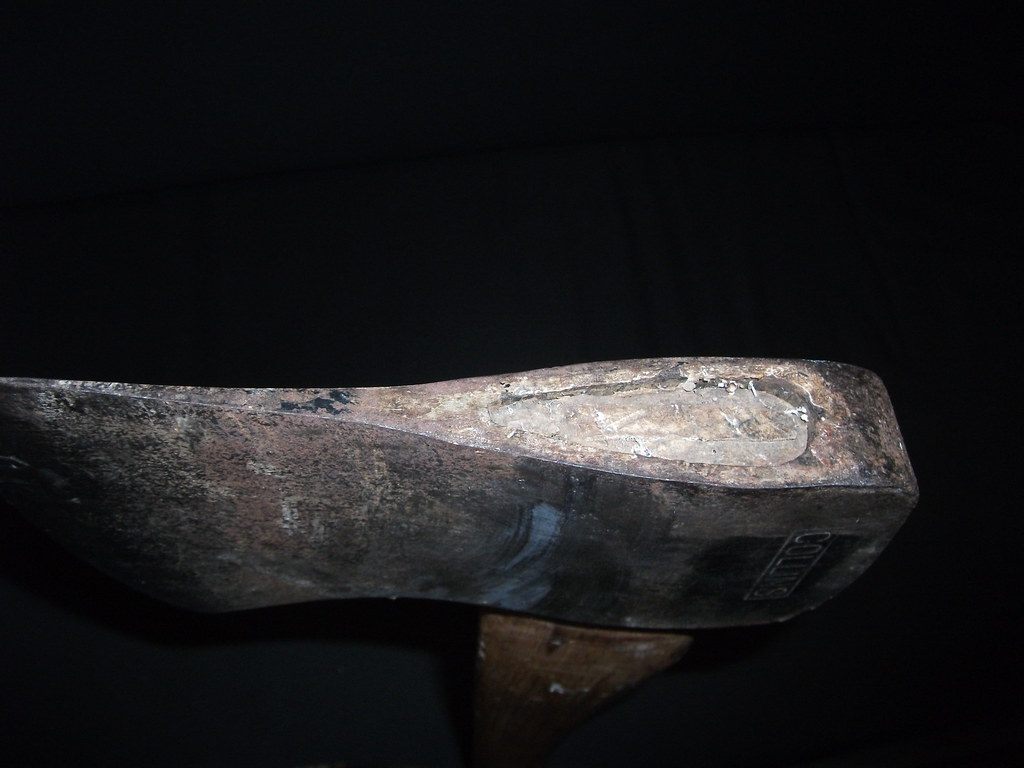

Anyways its a Collins, in good condition, tiny bit of mushrooming on the pole, not sharp at all but it has never seen a grinding wheel it seems, only small amounts of rust. The haft is in pretty good sharp but the head is slipping off some.
So I was wondering if anyone has an idea of how old this might be? Also the Haft right now is 39" long and it seems to long to me so what would be a good length for a new haft would 28" be to short for a 3 1/2 LB head?
I'll defer on the age question, but as for size, you should use whatever feels appropriate to you. But 39" sure is a lot for a 3 and a half pound head. I'm partial to 28 or 32 for that size myself, as even 36 seems rather long for that weight. Depends on use too... a 36" handle with a 5 pound head makes for a pretty good splitter, though I'd hate to have to actually have to chop through a log with it.

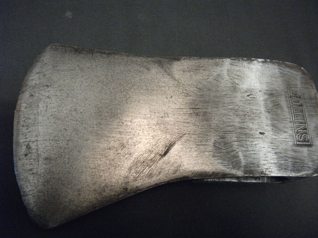

I took the head of and just hit it with some sand paper. I think it will clean up nice when I am all done with it.
The profile seem pretty good to me at least from what Ive seen and read so it should sharpen up nicely.
Hard to say with that Collins axe. Looks like it might be one of there Mexico jobs, but hard to tell, I dont see the M marking for it. When you start to see the rounded poll ike that, that isn't that old of an axe overall, but still a good one. 3.5 head you could do a 36 inch head if you like, or smaller, really up to you. Biggest thing is hope you enjoy it, that is all that matters! Nice axe!
