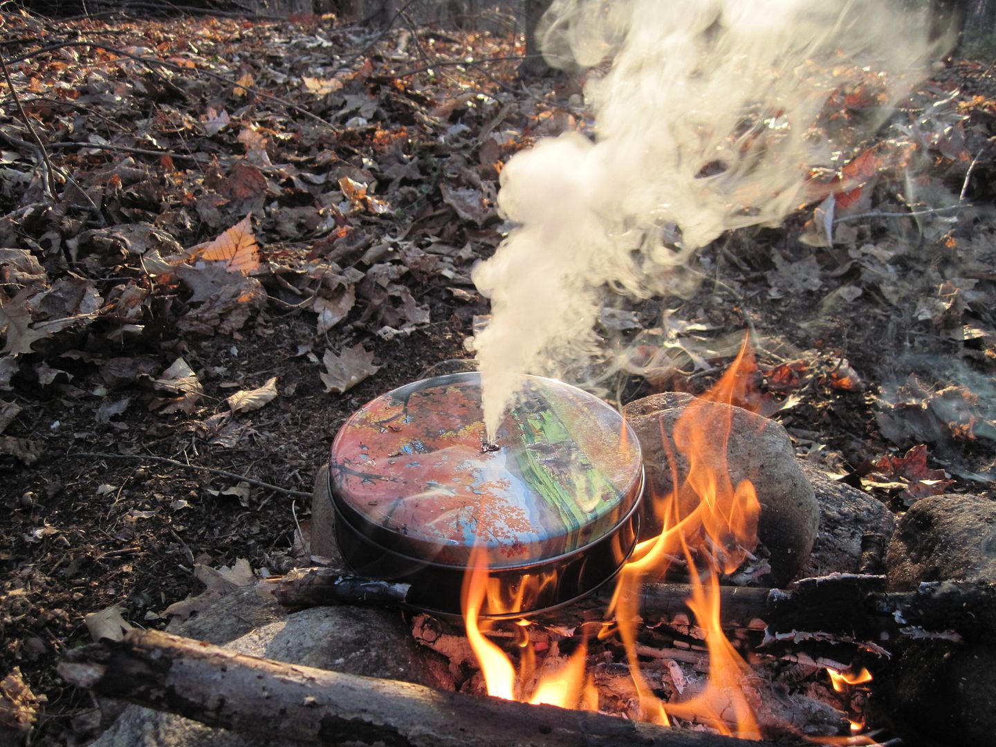

I'd never made any until today. I just have relied on other ignition materials. But my wife wanted some old receipts burned this morning, so I took advantage of the opportunity.
Here's my cloth--old t-shirt cut into roughly 1.5" squares. Sorry, no pictures of the cookies we ate first. You can see the smoke hole I drilled in the tin's lid.
I had a nice bed of coals ready in the fire bowl.
Here's the tin just after I put it in the coals. It began smoking immediately.
And then it really started spurting.
Couple more smoking pics follow. All told, I left the tin in the coals about 20 minutes.
It had actually stopped smoking a minute or two before I removed it.
During the process, I turned it once to make sure the heat was distributed evenly off that bank of coals in the background.
Cool down.
The blackened payoff.
That's it. I'm going to give the char cloth some tests with sparks and see what I can do with it.

My favorite thing to make char out of is punk wood. It's harder to pack than char cloth, but it's fantastic for starting fires. Once it takes a spark you can go straight to small kindling.

Charcloth is used to catch the first spark typically from a flint and stel. It creates a hot ember that can be fanned to catch additional material like kindling . Sorry, thought I had Machineage's question in here.
Mine seems to take a spark just fine, but I haven't tried to transfer it yet.
