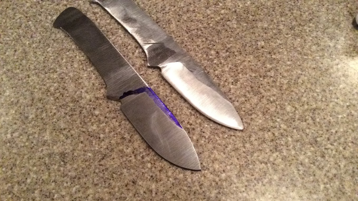

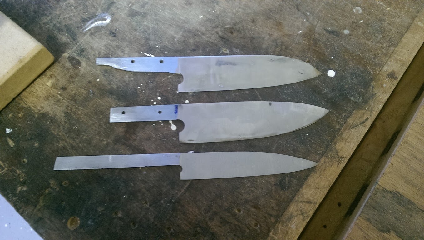

Hey guys, so I've got my first batch of knives almost ready for heat treatment but I have a couple of rookie questions for you guys. First off, let me show the pieces I've been working on:
I've just ground these out of 440c, 1/16 for the kitchen knives and 1/8 for the hunting knives. I've ground the blades down to about .020 which I'm hoping is about right for heat treat, but I'm not sure if I should be going thicker or thinner than that. I know I should be trying to make it uniform thickness all the way down, but what tolerence are we talking here? I think on some I'm around .022 on the thick parts and .018-.019 on the thinner portions. Is this too big of a variance? What grit finish should I be sending it off with for heat treating, the blades themselves are currently fresh off a 400 grit belt, and the tangs are raw from the 50.
