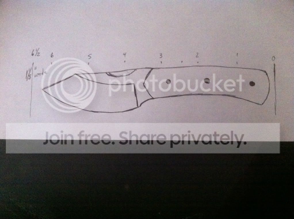

Hey everyone, working on my first knife. I am starting on my first straight razor, mentored by several of the razormakers over on The Straight Razor Place forum, but wanted to put up a design for a first knife here to let everyone pick it apart.
Specific questions:
1. I ordered 5/16"x1 1/4" O-1 to use for my razor. Can I use the same steel for my knife, or should I be looking for thinner stock. I'd rather just use what I have, but if I can't, then I can order different in a couple weeks.
2. I'm using files for my razor, so I will be using files for this blade as well.
3. Thinking about putting a thumb notch where indicated on the spine. Yes, no, hell no, other?
Thanks for the critiques. Looking forward to hearing back from everyone. Getting excited!!

The stock thickness you mentioned will make a very sturdy camp knife, or small chopper. Go for it...O1 is a fine steel for knives also.
What do you think about the profile? I'm thinking about making it a little longer to make it more versatile in camp.
You are limited in design due to the width of stock you have to deal with. A longer blade may work well, but I'm thinking of something with a 5" blade max to keep it in proportion to the width of stock you have.

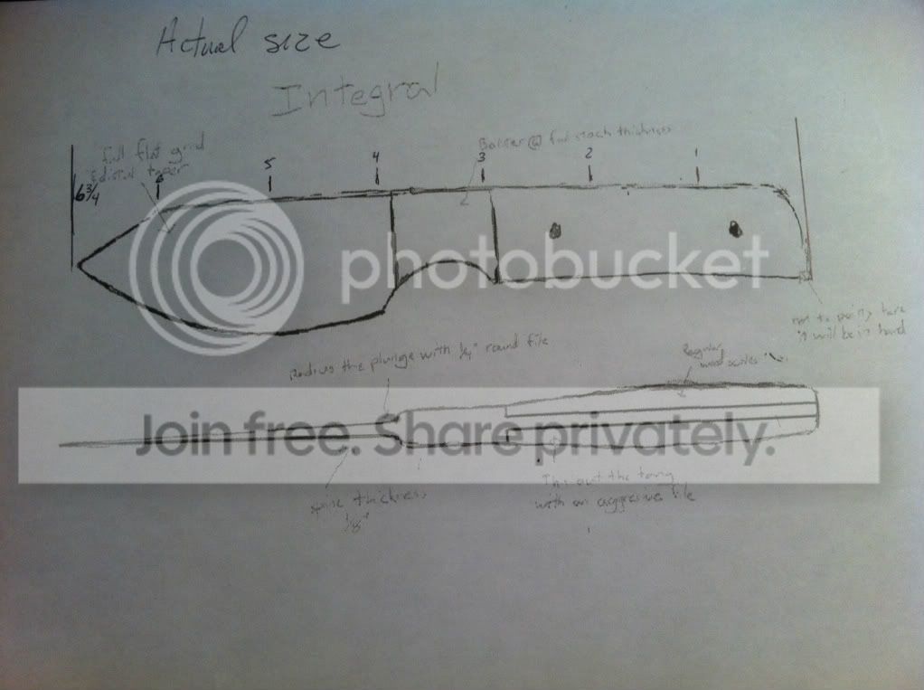

Thanks melsdad. I redrew the blade another 3/4 of an inch longer. I like the length, but I'm not sure about blade shape and the handle yet. Needs another revision. Here's the pic.

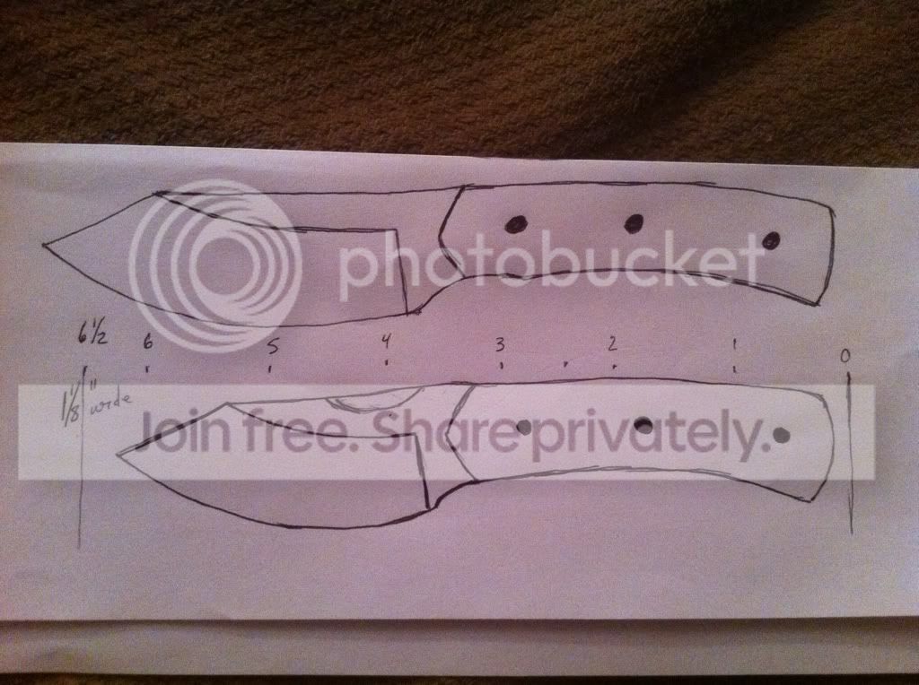

My mentor through all of this has been freaking awesome. Here's his revision of my original. I like it!

5/16 is WAY too thick for such a small blade. And while the idea of making an integral is cool, I think that's biting off WAY MORE than you can chew right now. There are many aspects to an integral that require a lot more skill and experience than a simple, full tang knife.
My recommendation would be to order some 1/8" thick steel and make your design from that. It will be FAR LESS work to profile the blade, as well as file in the bevels.
Nick, can you expand on the aspects of making an integral that I may not be considering?

5/16" is pretty thick for a small knife... then again, you're intent is to make an integral bolster. I'll agree that it's a big jump for a first blade but I think if you are in it to have a good time and have a concept of what you are in for(which you seem to be realistic about) then nothing is really unachievable. I don't believe you need to take baby steps. If the first blade you make is a take down, subhilt fighter with fileworked spine, and pearl inlay... so be it. Take it slow, research, ask questions and HAVE FUN. Are you doing your own heat treat?
I would lose the thumb notch... how much will it increase the comfort? I know my grips change with the tasks I am performing and exaggerated/specialized features always seem to find a way to create hotspots. I would also lengthen the handle a bit to atleast give your baby finger a purchase on the grip. It will go a long way in preventing hand fatigue. Just personal opinion/preference.... the blade looks good.

Thumb notch or finger notch? I actually have a prototype from steel now! Lol. The finger notch is actually much much shallower now. The blade has been lengthened and the tail put back in. It now accommodates my entire hand, including my pinky. I hadn't posted the finished design. Seemed like interest kind of waned here, so I was just plugging along on my own. Just got the blank cut out yesterday, and hope to have it and the two razors I'm also making completely profiled late tonight. Then, this weekend I can start filing the grinds in! Woot! Lol
Ps, the thumb notch on the top got completely taken out a while ago. Looked dumb and served very little to no real purpose. Not my kind of feature.
