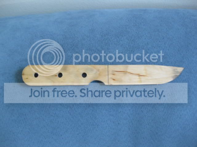

After learning the ropes from Stomper here on the forum, I'm starting my first knife on my own.
Here's my design:
Here it is in wood:
I'll keep this thread going as I go along, in case anyone is interested ;)
That's a nice straightforward design. Fairly easy to do and will make a great EDC. Should serve you well when it's done.
Marcel
Sorry to be a jerk, but the handle is way too straight. It should drop below the level of the spine and curve at least a little to be comfortable and handy.
If you're limited by the width of your stock, try a narrow-tang design so you can make the handle flow better.
I like the simplicity of your design..but James has a really good point.
Play with your wooden model for a while and see how it feels.
The first one will take a lot of work to finish, you may as well like what you have when you are done.
I should mention, I think the blade profile is quite reasonable. :) Plenty of straight edge, keen tip and a nice belly.
I too like the blade. It has a little drop to the tip and a nice belly. I agree about the handle. You could trim up the bottom of the handle with some curve to it. Make it fit good in your hand. Two pins would be enough for that knife. Are you going to put bolsters or a guard on the blade? If you are going to put on bolsters, be sure and drill your holes before you heat treat. It is a lot easier. (Don't ask me how I know)

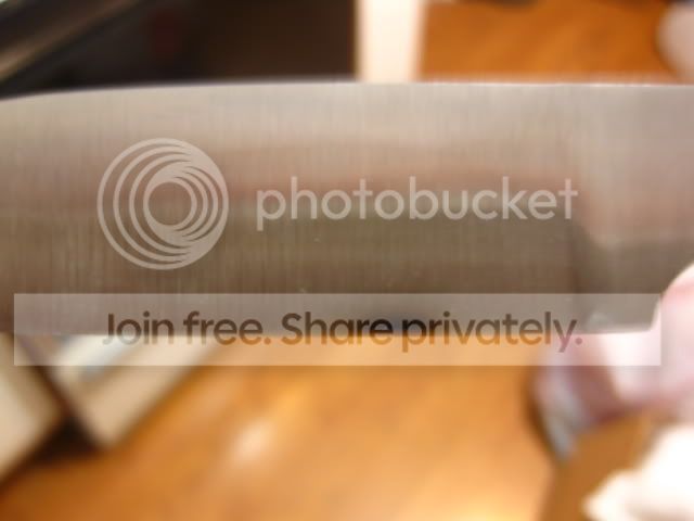

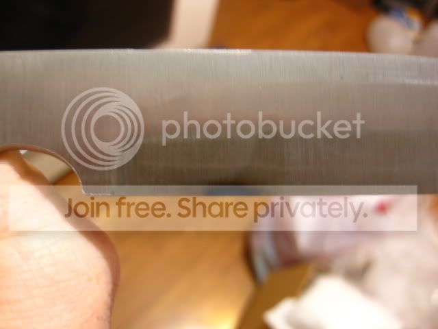

Well... I think I ruined my first blade. And it was going so well too. I'm checking it over with my mentor, but I think it's probably trash.
I was getting lazy and kept using a 1x42 belt that I knew was getting worn and producing too much heat. It was my last belt, so I just kept going, and burned the edge. Here's pictures. It's a little blurry, but I'm sure you know what it looks like.
Can't you anneal it and then re-HT it?
I worry the edge is already thinned out so far that when I ground off the scale there wouldn't be anything left :)
This was going to be a test beater knife to determine how good my heat treat is...
So let me ask this question. I fully expect that burnt part will just chip right out, but will the whole knife snap at that spot? Like, could I still take this out and baton the hell out of it to see if my heat treat holds up?
Even so, you could change the profile a wee bit and get the thickness back. Just throwing ideas your way. Good Luck!
I don't think it would snap at that spot at all. If anything, it's like you tempered that spot at too high a temperature, so it's a lower hardness and it won't hold an edge as well as the rest of the blade. I may be wrong but that's what my common sense tells me.
