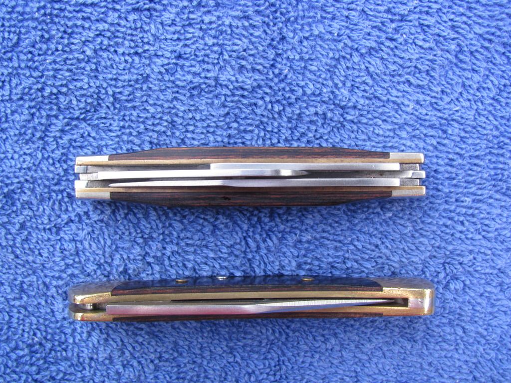

I do not hate Chinese goods but I buy American when I can afford it. I was not planning to buy a Chinese Buck but this 373 was $10 in a pawn shop. Looked new, though dull. Upward pointing arrow date code - is that 2008? I'm guessing someone never sharpened it, ever. The edges look like the original factory angles, but never sharpened.
Appears to have the Diamondwood scales.
So help me with a strategy for the three blades - do you keep one sharp, one super sharp, one with a thicker edge? I carry a 345 and a 55 today, I'd like to test the 373 as an alternative to the 55 and see how well it holds an edge. I haven't carried a stockman since I was a kid who knew nothing and let my knives get dull, usually about the time I lost them.

So I intend to sharpen the main clip blade at 20 degrees - the same as my US-made every-day carry Buck 55. We shall see if the Chinese steel lives up (down?) to it's reputation as being inferior. I'll sharpen the sheepsfoot to 25 and use it for tough duty. And I will sharpen the spey to 17 degrees and use it only when I need a very fine cut. My Buck 110 is sharpened to 17 degrees and hold up very well, but of course it is American steel. The trial begins.
Update - sharpened two of the three blades. I am used to Buck's 420HC steel. I've heard the Chinese steel is inferior but I have no proof. These two blades did sharpen surprisingly easily. Not sure what to expect because they were new to me and no idea how dull they actually were. They were dull, for sure, but "how dull?" is not a nice numerical question.
Now to carry it and cut stuff with it.
I have a couple 371's and a 301. I've not noticed any difference in edge retention. Both see the strop maybe once every couple weeks of use. I have not had to use a stone on them yet.
OK I have carried the Chinese Buck for a month or so. I sharpened it as follows:
Main blade 20 degrees (40 inclusive)
Sheepsfoot blade 25 degrees (50 inclusive)
Spey blade 17 degrees (34 inclusive)
Sharpening that tiny spey was tough, my Lansky and my Gatco guided rigs would not fit it. I reprofiled it on my Lee belt sander, then brought it to very sharp with some v-sticks. The 17 degree angle is so shallow that I got scratches on the upper blade, this seems unavoidable, but the blades all cut. They seem to hold their edges well, but it is not really fair to compare to the Buck 55 , there are three blades on the 373.
One thing I noticed - the 373 is too thick! In the picture you can see how much thicker it is than the 55. I know, it has three blades, but if you look at the picture you can see that the scales are a lot thicker as well. I think if they thinned the scales on the 373 it would carry much better. I wear dress slacks and the 373 makes a bulge, the 55 does not. I know I could thin it myself but I wish Buck had just done it from the start.
