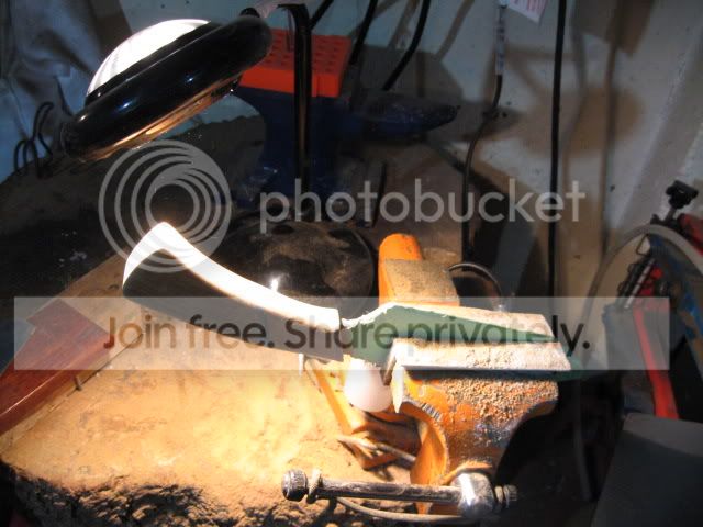

I only have a 4" x 36" ginder that I bought at Home Depot for around $100 a few years ago. I wish that I learned long ago how efficient the disk is (cheap grinding disks at Princess Auto in 120 & 220 grit). I believe I bought good belts for it online from Supergrit that have worked well enough considering the limitations of the machine. A cheap drill press from Canadian Tire, a small vice, a couple of clamps (don't clamp too hard or you will squeeze out the epoxy and it won't be able to do it's job), files and sandpaper and after that you decide if knifemaking is for you! It will be slow but I feel that in the beginning that is a good thing.
Here is my setup (and my last knife):
(I never use the bandsaw except as a table and light)
I don't know the knifemakers from the east but knifemaker.ca is who I get the majority of my supplies and heat treating from,and they have been great.
O, if you have access to taps and a drill press or have a friend who's handy with tools, you may check out the Grinder-In-A-Box kit on the For-Sale forum here. I have one nearly completed, and it's a solid piece of work. I made knives for years before I finally afforded the KMG (and I paid way more than $800 to get what I wanted ;) ). I started on a Grizzly 2x72" (I still use it all the time) which runs in the $600 range. Coote's also run in that range. If you can wait a while, there's a new grinder being worked on my Tracy Mickley and David from Great Lakes Water Jet that's going to be a nice system.
