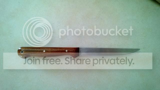

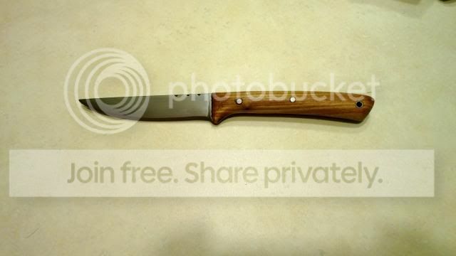

Here are a couple of knifes that I just finished-
4" blade made from 3/32" 0-1 tool steel 4.5" red elm handle
5" blade made from 1/16" 0-1 tool steel 4" black walnut handle
Heat treated in my two brick map gas forge and quenched in canola oil, tempered @ 400 for two one hour sessions.

The 3/32" I gave my brother for his birthday, he said he wanted a general purpose knife. I abused it for a week before I sent it to him, I used it for everything from cutting aluminum cans in half, cutting my pork chops, and scraping on one of my self bows all while holding a nice edge. That really impressed me.
The 1/16" was my sad attempt at a fillet knife... I made it for a friend at work who wanted a tougher fillet knife for cutting fins and rougher work.
I'm still learning :) My problem is that I'm not really a knife guy, but I love to make my own stuff ya know? I started making bows and though that knifes would be fun too...
Gotcha. I was curious as I usually stay on the north side of 1/8 for anything other than a kitchen knife. Thin steel is actually harder to work. It tends to flex and grind weird because of it. It also heats up really quick... So, good job with that, looks nice and even.
