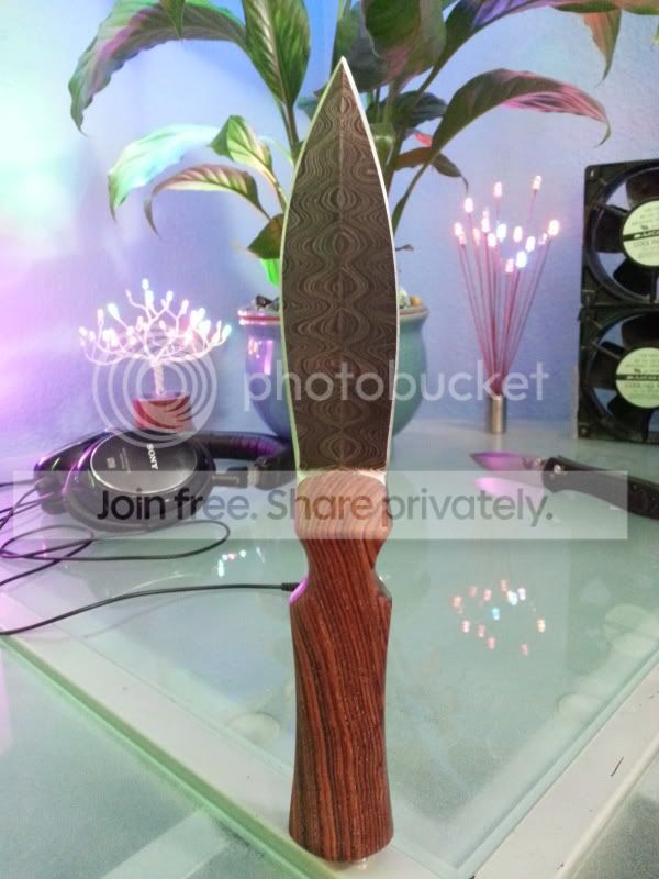

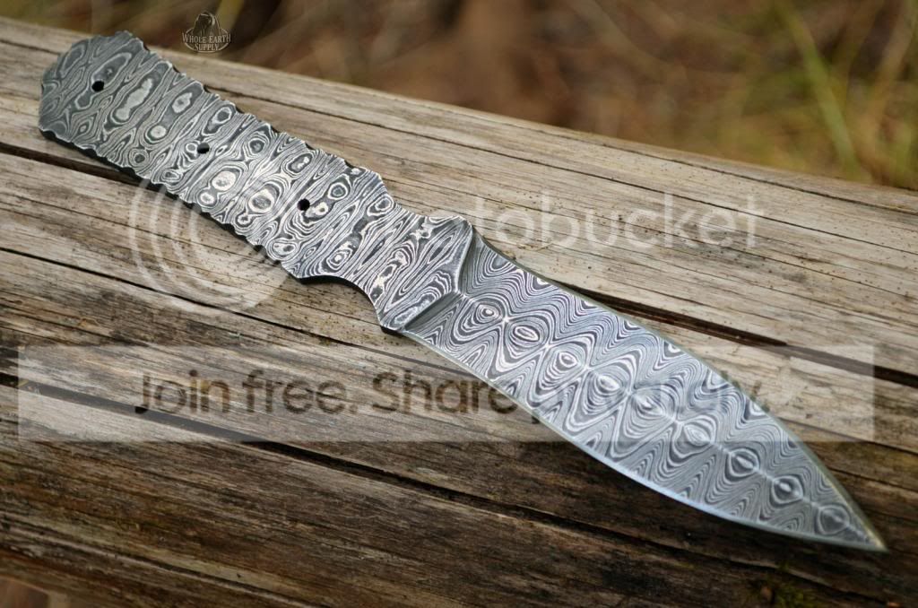

Just bought this.
I've got a nice looking piece of Cocobolo that I plan to use. My plan is to just keep the shape simple, texture the blank and epoxy the scales. No pins. It'll be a shelf queen should it come out nice. What do you recommend to finish the wood scales? Nitro laquer? I'm no stranger to working with hardwoods and finishing. But my primary realm is guitars. This is a guitar I refinished with a curly veneer.
Anyways, any tips on making knife scales?
Thanks
-Tony

Cool, thanks for the advice. Yeah nitro worked well on my guitar but I'll try an oil rub instead for cocobolo. I know for a fact poly will never cure on cocobolo or rosewood.... that was a time consuming mistake.

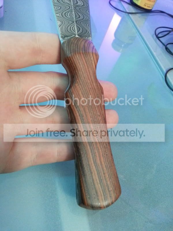

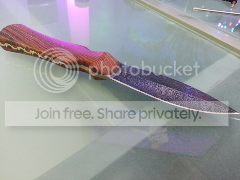

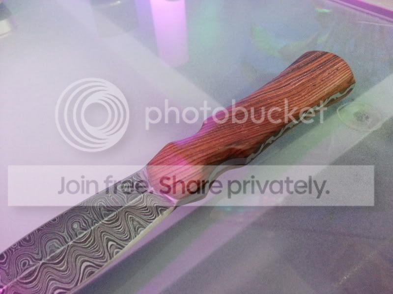

Killer. Thanks for your advice guys.
I'll post pictures once its finished.
