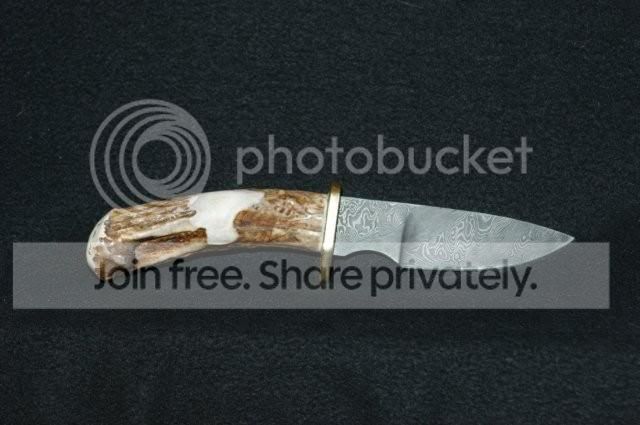

my first try, hope it looks ok!!!
It looks a heck of alot better than my first chunk of damascus. Mine was so bad I didn't even bother to make a knife out of it. I keep it on my workbench as a reminder. Keep up the good work!
Wow looks awesome , I can't wait to get my forge finshed to make some damascus
Great job on the Damascus.
I am puzzled a little by the knife geometry. Why the over sized ricasso with what looks like a finger groove?
Now I add the large finger groove choil, making it part of the handle. I can make the handle smaller therefore a smaller knife.
