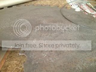

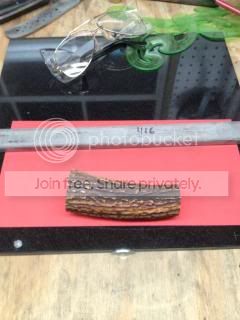

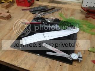

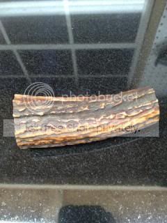

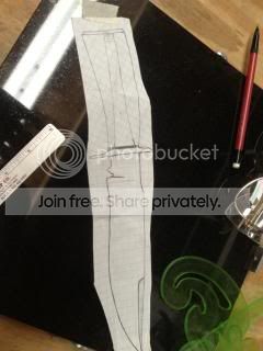

This is going to be a photo documentation of my first ever damascus knife. I will try to take as many pictures along the way, wish i had a better camera but money is tight and school is biting into my time as well. I have been doing stock removal for the past year and change. Sold around 17 or so blades and attended a few shows as a vendor sharing a table with my mentor Ross. I have become more confident with my fit and finish, free hand grinding etc. So i went through all my stock and decided it was time to do a damascus piece. Being a guy who has grown up fascinated with large sharp objects naturally my dream knife was always a bowie with a stag handle. I have been saving a piece of sambar stag just for this purpose. After getting all the designs worked out today i dragged my 15n20 saw mill blade out of the steel stock and began torching on it to get the 4, 2" wide pieces i would need out of it. I am currently waiting on the 1095 to come in as i just ordered it today. I do not have all the pictures of flame cutting the saw because i was by my lonesome at my buddies race shop using his torch. The plan is to start here in a few weeks with a 5 1095 and 4 15n20 billet and cut and fold until it is 234 layers and then go from there. I will try to answer any and all questions on this project in a timely matter, but school does keep me away from the forum for a good part of the day. Appreciate any and all comments and feedback and hopefully you guys will like what is to come, for now i have a few pics i snapped on my iphone to show what the beginning stages are.

BTW, How sure are you that the saw blade is 15N20. Most large circular saw blades with ground teeth were actually L6, a higher alloy steel. A bit harder to work than 15n20 but still very doable. I like L6 better actually for edge holding ability. If it seems a bit stiff under the hammer compared to 1095 it is probably L6.

AC- I was kind of wondering when i found it at a scrap yard that it was l6 but after numerous spark tests and several peoples opinon, we determined it was in fact 15n20. As for smithing experience, i have attended a hammer-in as well as spent countless hours standing in front of a fire hammering with my mentor and other local smiths.

Spanish Notch, This bowie has now become an order for one of my buddies, so he wanted me to put a spanish notch in it.
