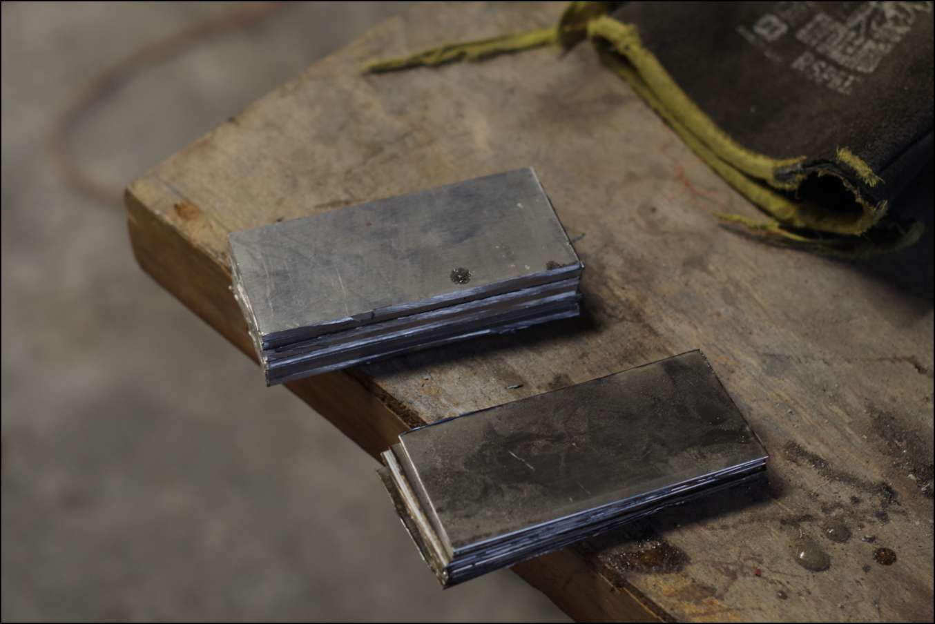

Hello,
Finally I'm able to do this then let's go :D
3mm Bohler K460 (O1) + 1,1mm 15N20
Ou who is here? ME!
And with very nice grip for this :D
How the piece is looking...
And the work started :D
https://www.youtube.com/watch?v=4KNnk3pnDS4
When we get this to 4-5mm I will decide what knife to do with this :)

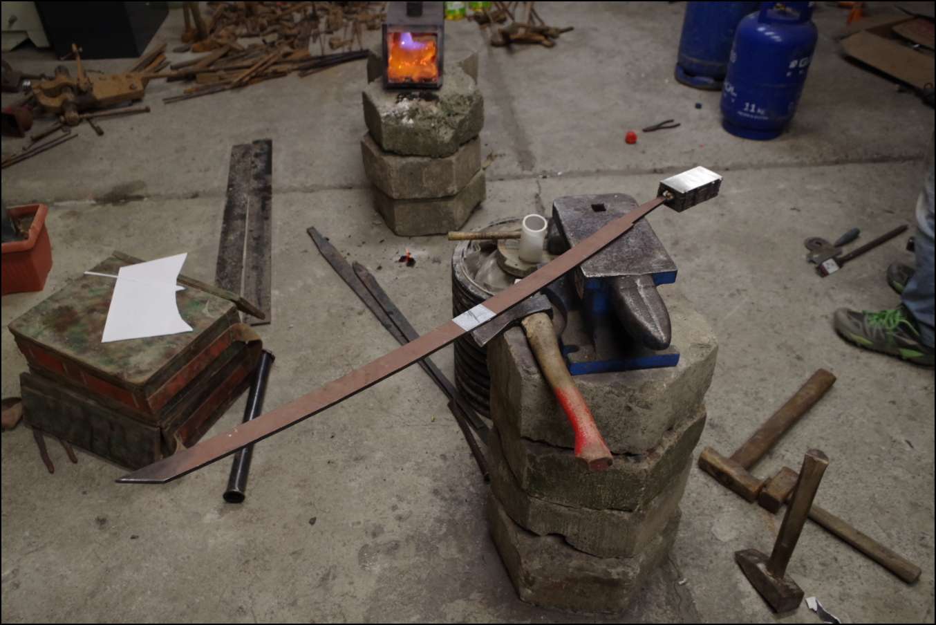

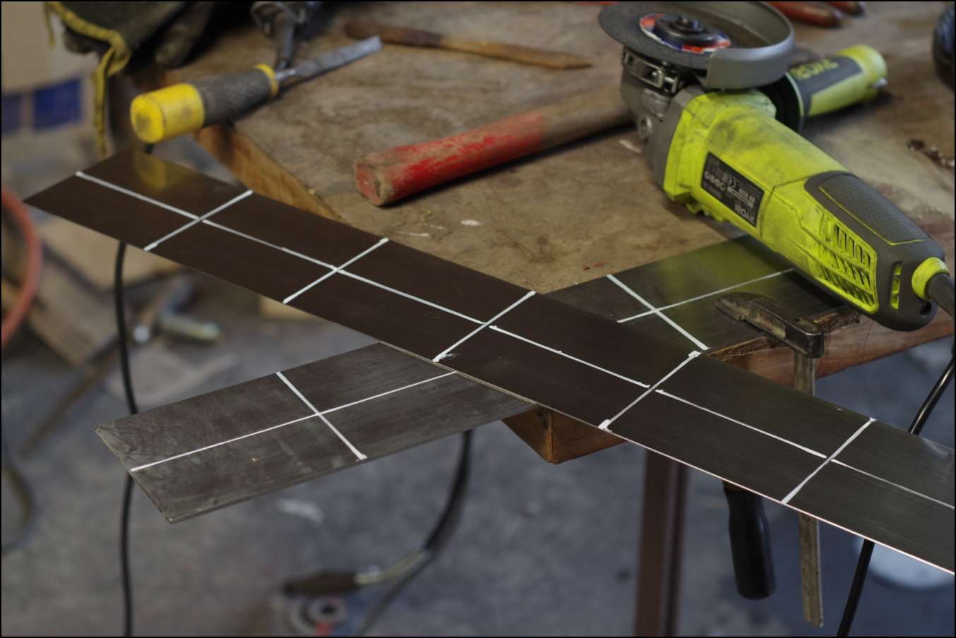

Mostly in plan is a Goliath.
If we get to small piece I will do other knife, kamisori etc.
Making this is delayed because of isolation fail in gas forge >.>
Devils Forge have to thin insulation to work on clean propane...
Run your forge rich and make sure all your steel layers are ground clean and weld it with out flux. But besides that I would try soaking the billet in kerosene than heating and welding.
Actually I collecting materials to build vertical forge, and for this I have a monster Banan Torch for this.
A verticle forge is nice, my second forge is verticle and I love it. The bottom of the forge is covered with bubble refractory so the flux does not eat it. But I know in the past people would cover forge floors with cat litter to soak of the flux. I'm actually considering building another forge and thinking about casting it. It would be fire brick with a cast center. Not sure how it would work but both my forges are on there last leg and especially my horazontal needs relining bad.
For my vertical forge I want to use Fire-resistant concrete ( up to 1500*C), to cast center chamber.
And for insulation a ceramic wool 50mm, then 60mm of this Fire-resistant concrete.
I thinki about to make square or round one...
