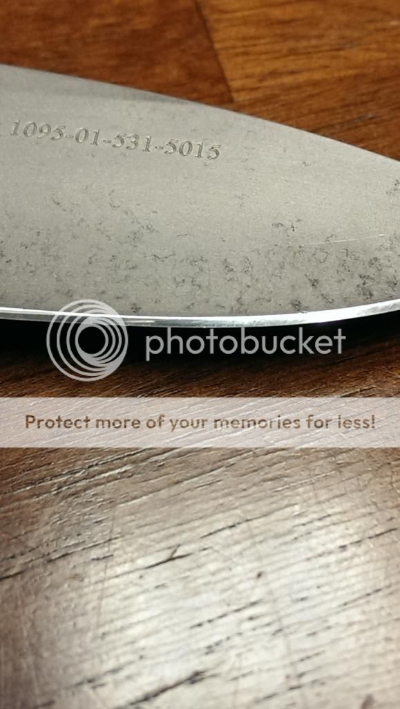

I don't have the polishing tapes but I have a 10K Chosera stones to go along with my 1k and 400 and I am able to get some really sharp mirror polished edges. This is my work knife and hasn't been sharpened in probably about a week. Also its a Strider SMF so it cries if you don't use it.
