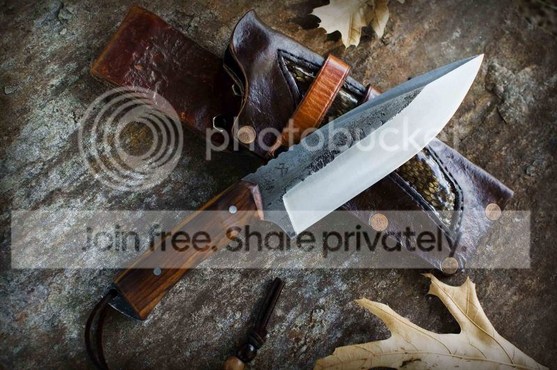

Here is an example of a chopper I made with a blade that is a little more than 7" long and 2" high. It is 1/4" thick. Keep in mind, this is chisel ground (ground on one side only). The main grind goes about halfway up the height of the blade and the edge bevel will be either a convex edge or a 30 degree inclusive edge. I have really good results with this for good cutting and chopping performance and edge strength.
