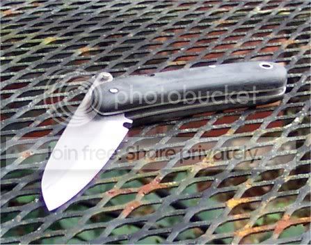

Well, I can't say I'm 100% pleased with it, but it could've come out a lot worse I suppose. No one told me that even though I sanded the liner interiors to 600 grit and cleaned everything well, that grit-fairies would come in and make my liners chew 180 grit like scratches where the blade pivots.:o:mad: Also the scales kept walking towards each other when all was peined and glued, along the back pin, causing extra scratches along the bevel.. I got some out but not all. I finally was able to sort of pein them into the scales to stop that, but it was all messed up at that point. Also not shown in pic are the rust spots near the spine from my hand sweat while trying to fix the mess. What really burns me up is that 30 minutes before all the cussing started, I had a nice crisp bevel, and everything was nice. :mad: Oh well, next time will be better I hope. :)
..This was a couple of other firsts for me as well, including first micarta, and first time peining anything.
Luckily this is just one I made to go camping with me this weekend, and teach me about folders.
I think you have a great knife, it looks like you can cut anything and its a great design. The other good part is you learned alot. What a deal. I grind a relief around the pivot pin to prevent the 'grit faries'.. but I really feel there is too much focus on scratches and not enough on the knife.
The best part of carrying a knife you made is when someone asks what kind of knives you make you reach into your pocket and show them something that most really could not make.
Thanks for sharing

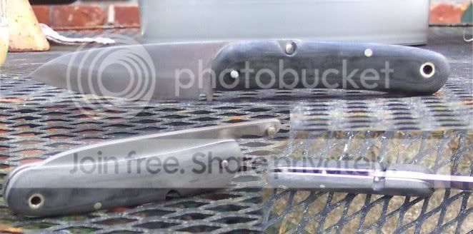

Here's another pic I left out.
The blade is a nice and legal 3", and the pivot pin I made out of some 154cm scrap I had (that was interesting), on Stacy's suggestion that nickel silver would be weak as a pivot. This is the first time I heat treated a 1095 blade in my kiln, and quenched in parks 50. I have to say it cuts very well.

Brass washer can be inserted to move the liner away from the blade, hard to tell how thick they would need to be. A typical relief is about 0.004. Teflon may not last so I shy away. On slipjoints washers can spread the liner too much for a good fit on the backspring and also interfer with the backspring unless they are really small.

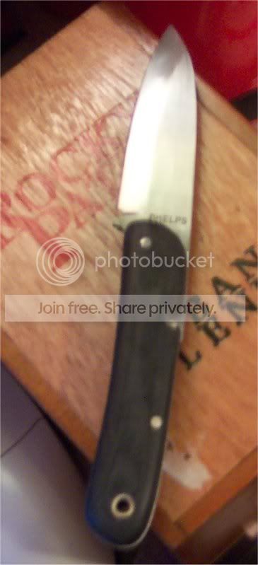

Etched my name in it with Ernie Grospitch's stencils (It worked pretty well considering I couldn't get the stencil taped on right)
