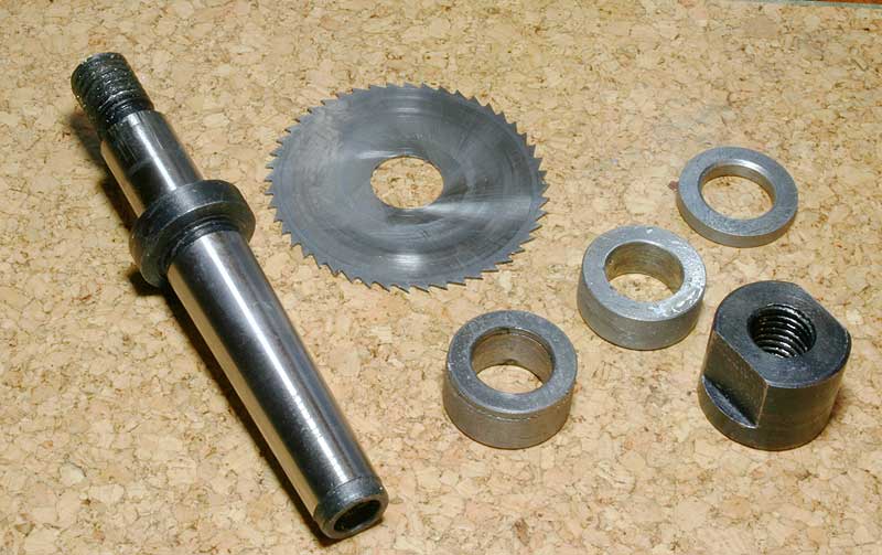

3. How do I cut the liner lock without using cutoff wheels? I can figure out the short cut, but am uncertain about the long cut.
Slit saw and arbour in your drill press or mill
Slit saw
Screw slotting saw
jewellers saw
You need an arbour that fits your drill press or mill spindle
and you need a saw blade, see the chart after, there are lots to choose from.
http://www.niagaracutter.com/millingcutters/1470.pdf
I use a 409 dremel cut off wheel to cut my locks.But I do it in the mill with the kiner locked in a vise.A jeweler saw should work to do it by hand.

Ah, my new cross slide vise would come in handy for that. Would anywhere local have something like that, or is it an online ordered item?
