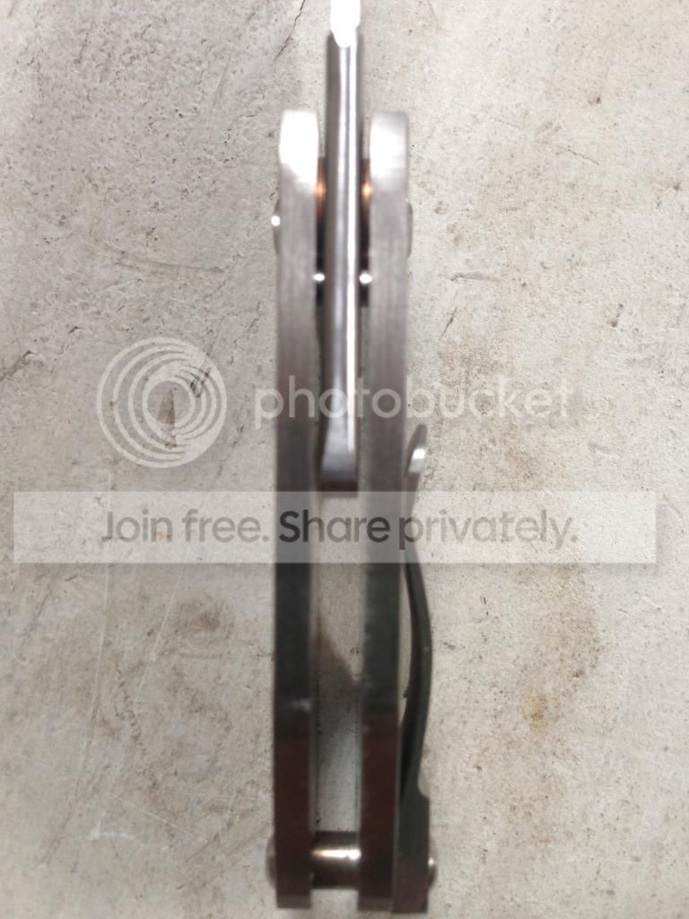

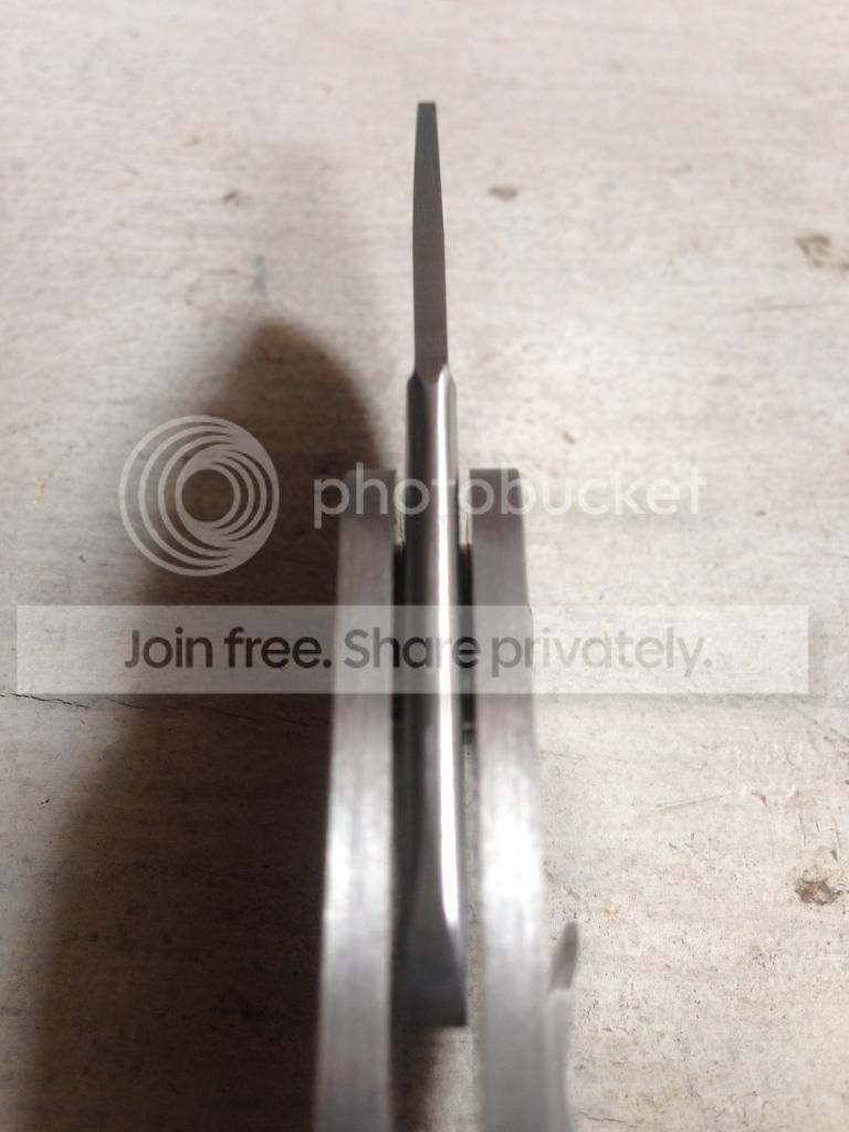

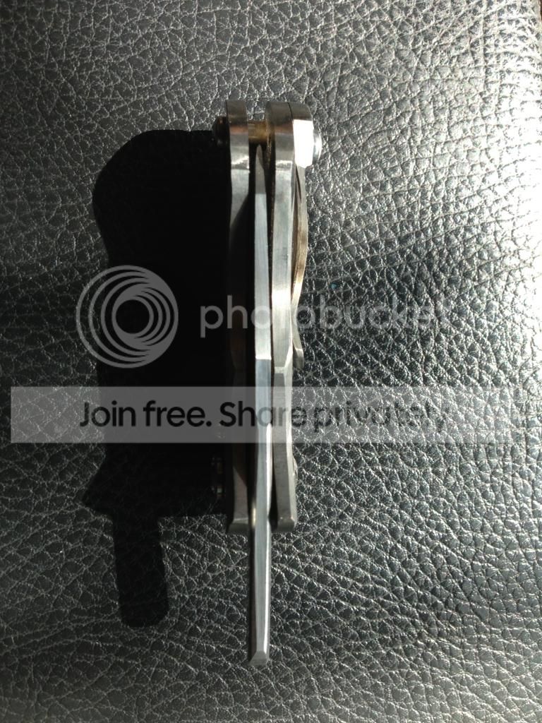

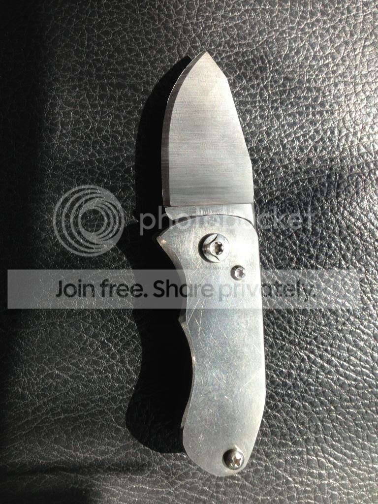

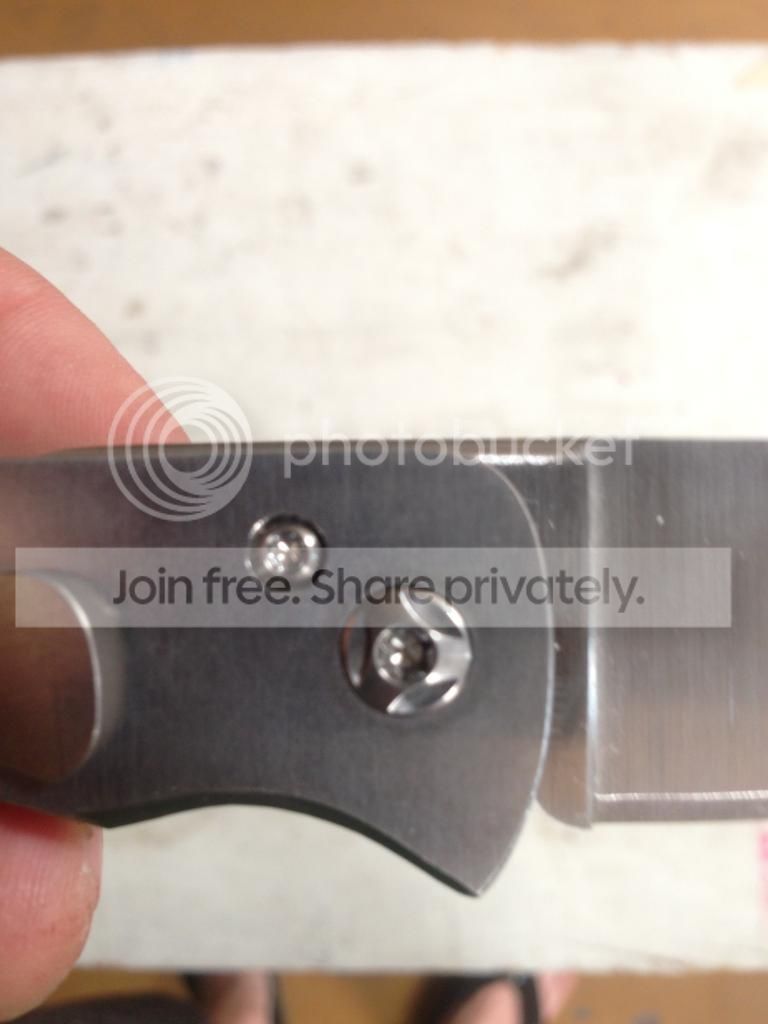

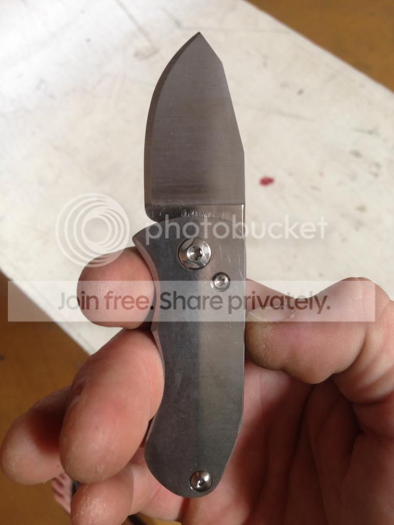

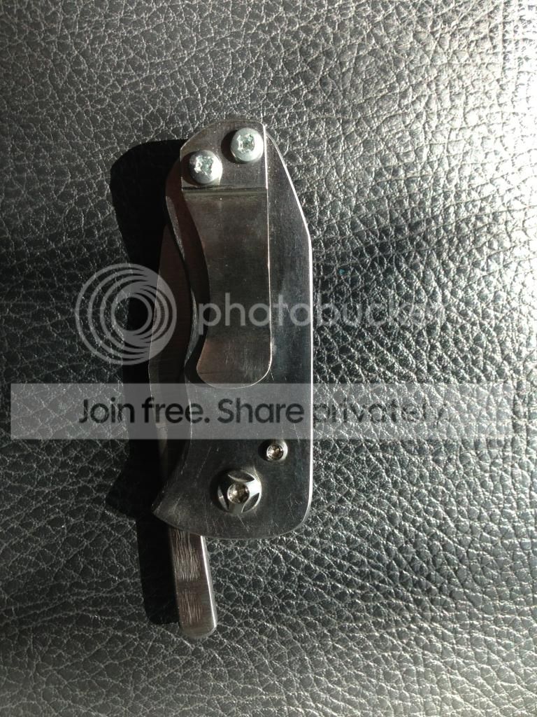

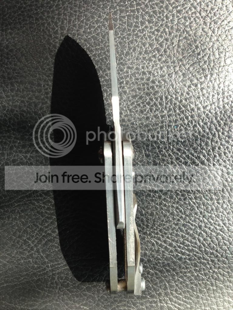

No exact specs yet. It's still a work in progress but is coming along nice.
Very smooth open and close, I managed to get a sweet spot on the blade radius that allows one to compress the rotation tang into a detent position against the stop pin ( hard to explain). I will keep you guys posted on the finish product.
Handle: Ti6Al4V
Blade: CPM154
Washers: Phosphor Bronze
Pivot: SS barrel with TI screws
Stop pin: SS barrel with TI screws
Pocket Clip: ground Ti6Al4V
Rear standoff: SS ( TI screws on order)

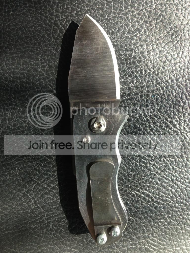

Handle: Ti6Al4V
Blade: CPM154
