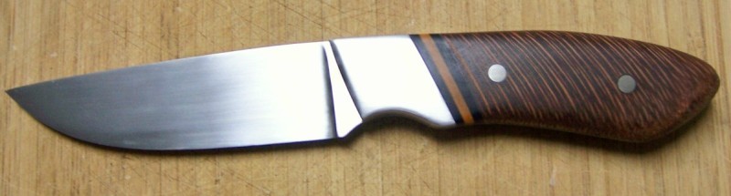

Below is my first real commission, an LSU-themed hunting knife.
Edge quenched 1095
5/32” thick at ricasso; 3.75” blade; 8” OAL
Tapered full tang.
Stainless bolster and pins
Homemade layered paper phenolic spacers (Muted Purple and Gold)
Lacewood scales cross-cut to show off LSU Tiger stripe grain.
Fully hand-rubbed to 600, then half rubbed to 1000
I would greatly appreciate any criticism, good or bad.
Thank you again for your time.
Mark
Great knife, did you try to bring out the hamon from the edge quench? I really am attracted to the curved spline, very graceful.
I did an initial etch to check it out, but the quech line was lower than I prefer and didn't flow with the knife... so I didn't emphasize it in the finishing.

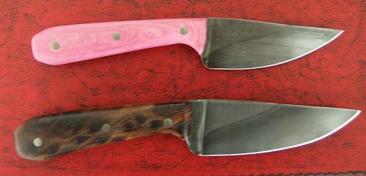

Here is a pair that did work well though...
Made for a father and daughter to commemorate their first real hunt together.
Forged from O-1 round stock: 3/8" diameter for hers; 1/2" diameter for his.
3" blade; 7" OAL and 3 7/8" blade; 8" OAL
Edges brought to critical using MAP torches rather than the forge.
Mild steel pins
Handle material: Homemade pink paper phenolic; stabilized redwood burl
(sorry about the bad photo)
