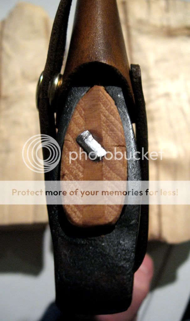

The recent Wetterlings and Wetterlings made Husky hatchets don't have metal wedges and aside from my bad experience, many others are also having problems with the heads coming loose because of this.
You could buy a Husky Hatchet and get a 15. cent metal pin wedge from Ace Hardware like I did and hammer it into the haft. Mine was coming loose but since putting the metal pin in it's super tight even after hard use. It's a Wetterlings Wildlife Hatchet for only $39.95, so it is a good deal if you don't mind securing the head yourself.
Here's mine with the Ace Hardware pin....
