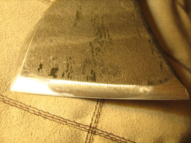

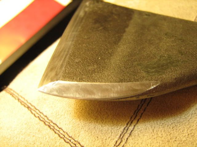

And a little grinding, more for affect than anything though the last 1/2in near the main edge is sharp.
There is a bow in the blade that kinda made me :grumpy: but I figure it will even out over time.

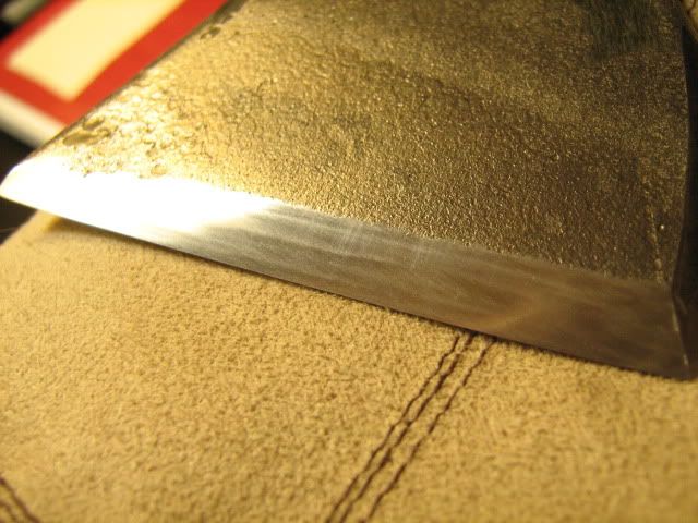

I set the profile with a 40 grit and 80 grit belt on my 1x30 and have been using a 1k water stone too clean it up. I think the 1k will work good to keep the edge maintained too, it gets it plenty sharp and leaves a more "worked" finish.
From here I think I'm going to round out all the edges and sand the flats a bit, then do a little flame work to the handle and give it a para cord wrap for better grip. Need to go buy some wood to make a target too :D

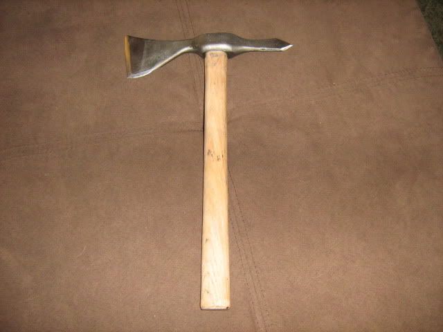

Looks like I could use a few hammer handles?
Kinda thinking of making my own any suggestions on wood? anyone ever try a layered wood haft?
