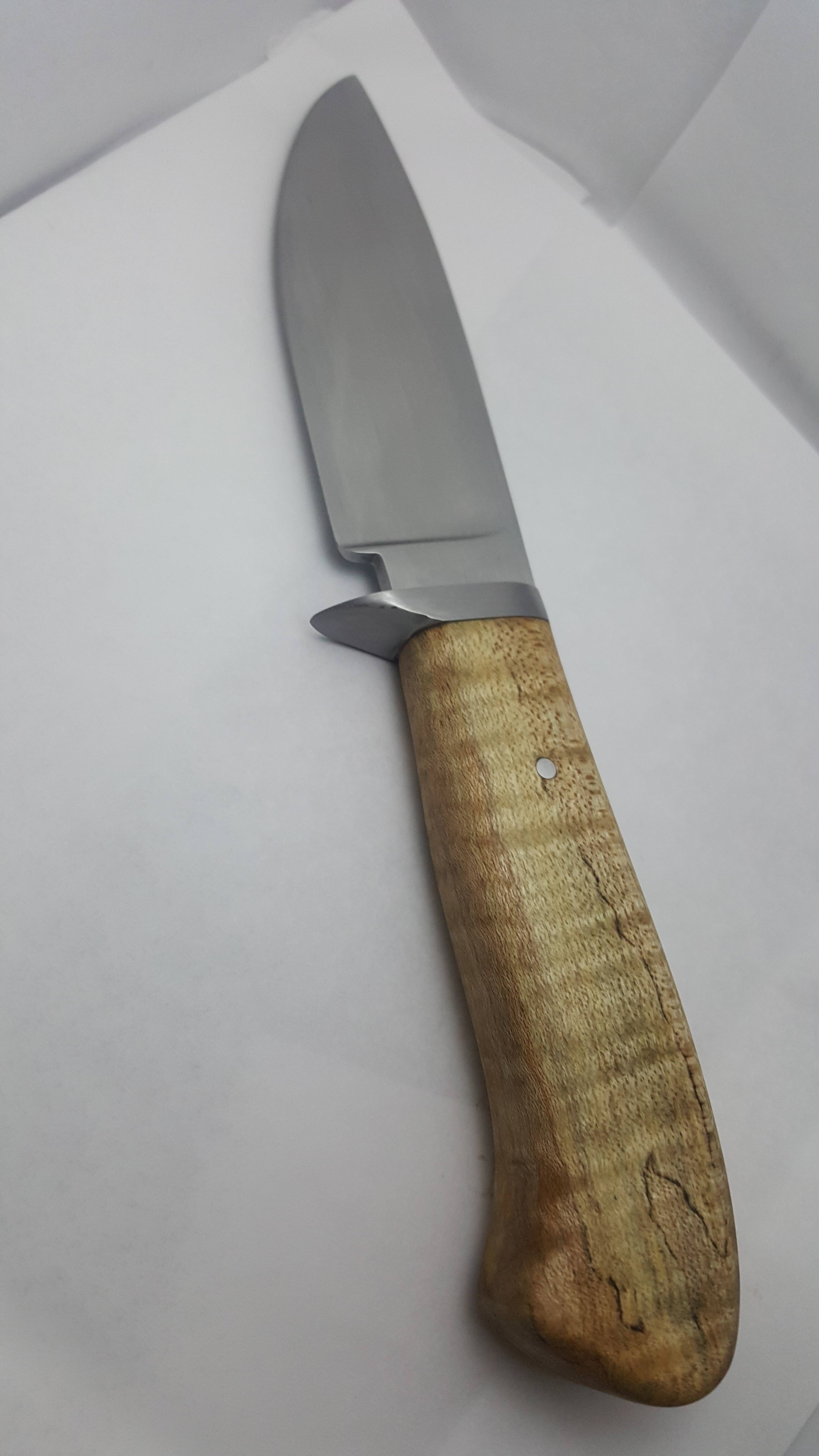

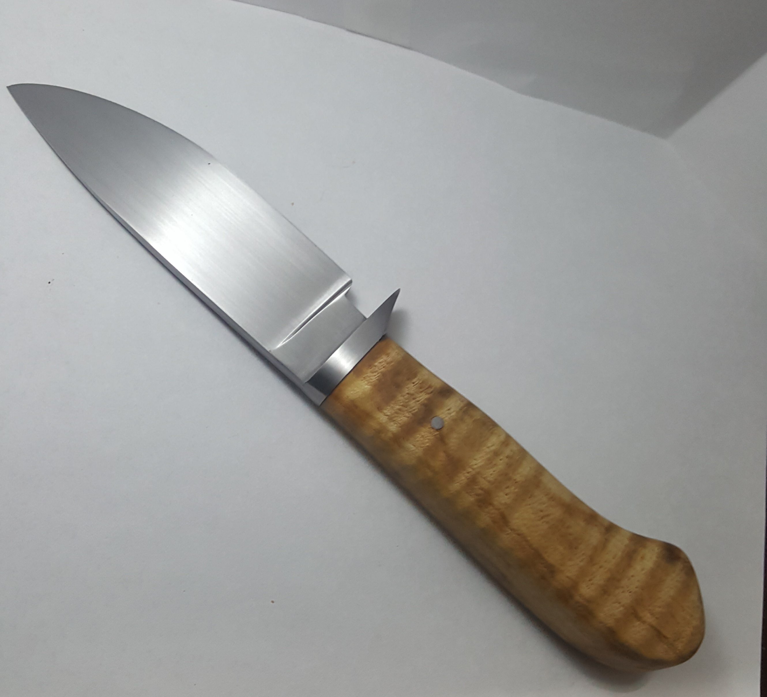

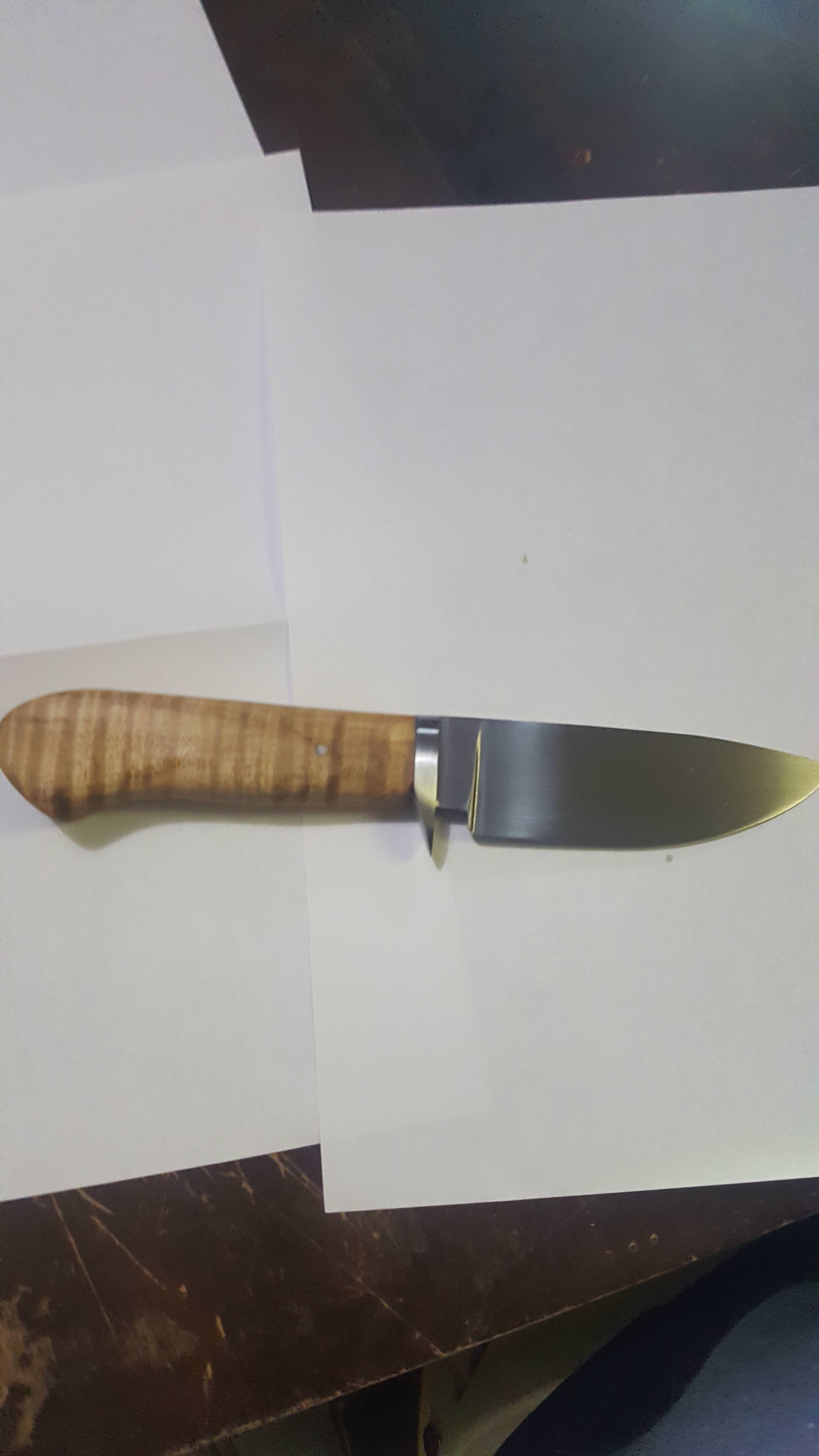

Hey gents just finished up this forged 80crv2 with 416 hardware and curly maple (unstabilized) ive gotten some good feed back from a couple of people but wanted to ask everyone one here. You can send me a pm, email (Justin.schmidt23@yahoo.com) or just comment on here. Thanks in advance
Sorry for the crappy photos :(
And dont sugar coat it, i have thick skin and want to make sure i can produce the best knives for my ability
I like the overall shape and design. It's a great start. The blade finish looks really good, as does the plunge.

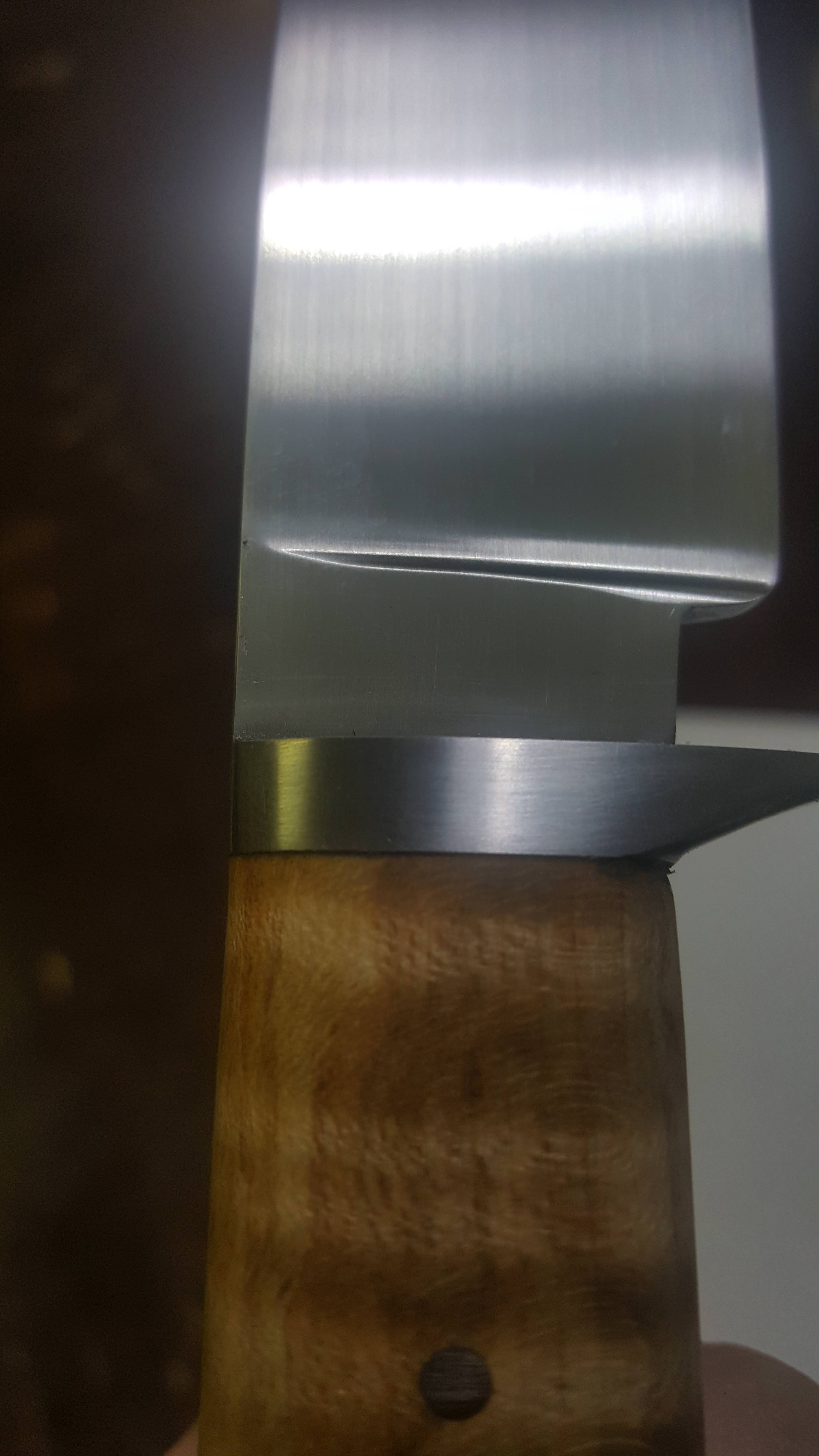

Is there a gap between the guard and handle?
Also, it looks like you shaped the guard first then attached the handle. That can work out well, but when you do a sculpted guard like that, it might not all line up.
Do you have a pic of the fit between the guard and the blade?
Good work.
You're really comin' along quickly, Valknut. Turned out very nice!
I have to agree with the others about the guard.
It's doesn't flow that well into the handle and the corners look a bit sharp with a couple of areas that look like they were 'dinged' up.
Also, in the second picture the plunge looks like it's in the proper place, but in the first picture it looks a bit further forward ahead of the dropped edge, which would look better if brought back to blend in with the dropped edge. IMHO if the edge drops straight down, it usually looks better if the back of it is left at about full thickness, yet "quickly" and very smoothly blends into the beginning of the bevel via the plunge to create a seamless transition. Hope that makes sense.
It's easier for me to get this look if I leave a bit of extra steel behind the plunge (the way it looks in your first picture) then after I finish my plunges I can creep up the back of the dropped edge to the start of the plunge by grinding away that extra material.
Other than those fairly easy fixes I'd say you're doing good. :thumbsup:

Alexander, what your seeing is i tried to "round" the top of the handle material lile Will Morrison dis in his WIP, ended up biting my in the butt.
I tried shaping everything separate. I super glued the guard on and shaped the handle and guard. But when i fine tuned the handle i got carried away with the 120 grit. Then rushed the glue up. So when i came back to to it the guard was protruding so i had to grind it all flush again, re sand everything (that sucked btw) but i learned ALOT. Just hoping this is still sellable lol

Bring the plunge line back and eliminate the lip...that is a focal point on a drop edge knife.
a more graceful curve to the back side of the guard makes for smoother handle guard transition..When I think of small hunters I always picture a Jerry Fisk "Sendero" he's probably made a Thousand of them...The Curve of the guard as it transitions to the handle is sleek and smooth...Look at the photo see the shape of the guard and also the Plunge line where it meets the Ricasso...Photo Courtesy Jerry Fisk.

The others have covered all the major points already. This is a fine looking knife. You are very close.
I kind of like the shape of the guard but like others have said it is too sharp. You could sand back the bottom of the guard until it's about 1/16" thick there. Look at the picture Busto posted of Jerry's Sendero. The tip of the guard gets pretty thin but he leaves just a little thickness there. I would also break the forward edge of the guard so that corner isn't so sharp. Just hit the corners with some 600 grit paper until it doesn't feel sharp. There may be a way to clean up the transition of the back of the guard up into the handle but it would require some very careful sculpting. But there doesn't seem to be a good way to clean up the fit of the rest of the guard/handle seam.
The plunges need some work. Based on the light reflections it appears that your plunge is nice and straight where it swoops down to meet the bevel. Where it needs a little attention is where it comes up from the bevel to meet the surface of the ricasso. There it is a bit wavy and rounded over in spots.
All in all this knife has a lot of good things going for it. You have a very nice blade shape. The knife has good flow and proportions. The shape of the handle profile is very nice, even if the cross section is a little blocky. The placement of the pin is nice and the gap around the pin doesn't look too bad. It's really a very nice little knife.
I don't think this one is ready to be sold but you are getting there.
