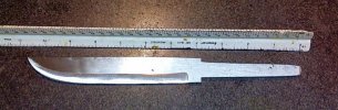

Was forging last night and a piece of 1084 wasnt cooperating the way I wanted to so went with it and ended up with a hidden tang type of knife. This wasnt the plan and I was going to wait a while before delving into this type as it looks pretty challenging.
My biggest question for this blade is what shape/style of handle do you guys think would look best on it. A classic Bowie style handle, maybe a more straight one similar to a small katana style?
Another question is I am assuming the tang should be thinned out a little to give the handle more material and the area where the tang joins the blade should have little rounded corners right.
Thanks for any input/suggestions/ areas to improve.
Taper your tang, both width and thickness. Leave as much steel as you can where the tang meets the ricasso and file in small radius where they meet.
As for the handle, trace the blade shape and start drawing handles 'till you find what floats your boat.
Good start, keep at it....
Thanks Dewey, I got the radius in and some of the initial sanding done last night. Getting it ready to HT this weekend. Ill get the tang sanded to a taper as you mentioned.
