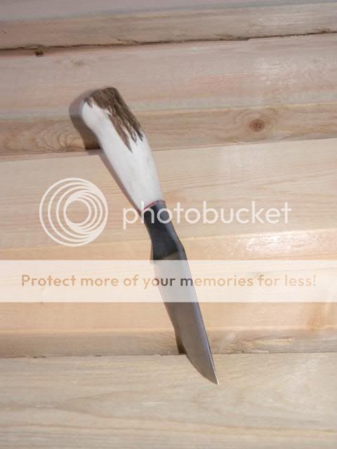

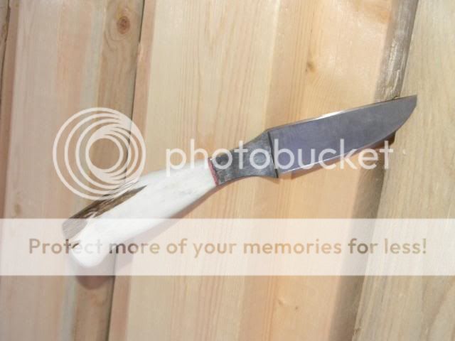

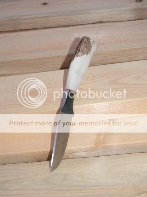

Here's my first integral. Forged from an old punch I had laying around the shop. Flat ground blade with secondary bevel. Red vulcanized spacer and elk antler for the handle. Bevels are 120 grit machine finished with the flats left with the forge scale on them for a rustic look and the elk antler is finished to 600 grit.
Hope you like it,
Brandon
Brandon, nice to see your work over here! Very nice knife! I like the design!
