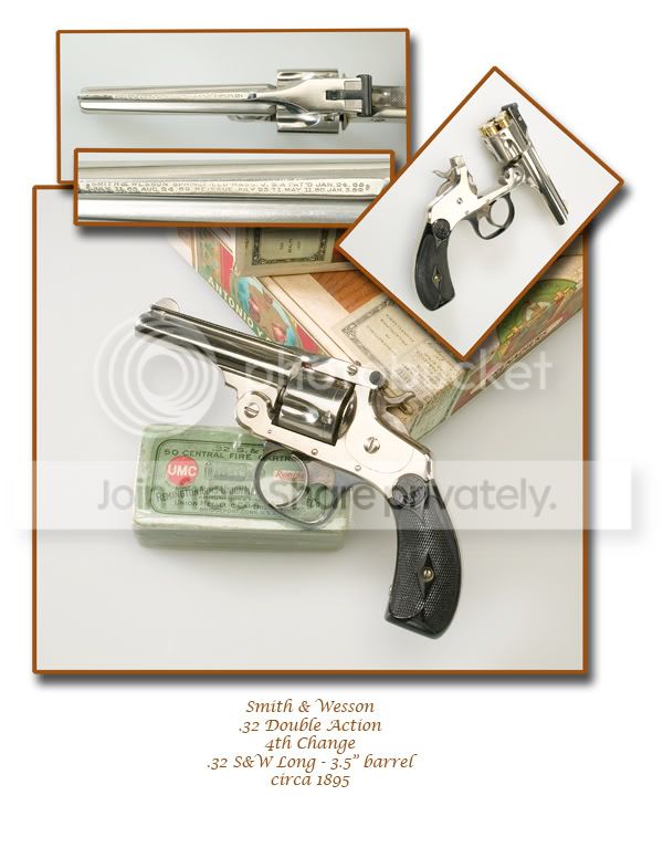

It would look great in one of those composite photos. I bet lots of people would use them as screensavers. Here is one I found on the net of a antique S&W similar to mine(I have a .44 though) for anyone who is interested in what a composite photo is but really it is just an excuse to post a cool photo.
I would definitely do the same to a composite photo of your knives ,IE post them anywhere I could find an excuse to because so many people I know would love it.

Thanks Unsub, I was thinking more of the kind with no boxes where you have to outline the different images and work in layers so it ends up all one photo........I tried it a couple times but couldn't do a clean job of outlining so I gave up (temporarily).
I really like the one you posted though, of course it may be that beautiful S&W:thumbup: I'll try one like this, it looks like it may be a little easier.

Amusing montage of the pistol from unsub. My great grandfather's pistol is that model and patent date S&W. unfortunately my uncle put a cartridge with modern powder in it and onioned the barrel :(
I now have a completely non-firable paperweight
