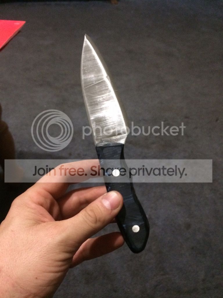

first knife almost finished

Shape looks good. It will be a better first knife than many.
There are some issues that you need to change on the next one,
1) Finish the blade completely except sharpening it before putting on the handle.
2) When fitting the scales, after drilling the pin holes, slip in the pins and tape the scales together off the blade. Shape the front end, sand it down , and buff it before assembling the scales. You can't finish the front once it is on the knife without messing up the blade.
3) It looks like you left the edge too thick post HT. On a full flat grind, the bevels should come down to nearly a sharp edge. About .005" edge is good ( about as thick as a business card). Once sanded or ground down to that thickness at the edge, finish sanding and polishing the blade to the degree you desire. When the blade is done, assemble the handle. If making a sheath, do that next ( befor sharpening).
4) Sharpen the edge after every other thing is done

just to be clear... i am not completely finished with the blade or handle. this was more of a learning blade for me to make. i did not heat treat it. just threw the handle on to get going. only used the flat platen on my homemade grinder. i also have a small wheel attachment that i havent used yet. and am looking for a large contact wheel at the moment. definitely gonna be a fun hobby for me!

We hear this a lot. Mostly we hear it from 16 year old kids who just want to "make a knife". You are 37 and not a kid anymore. Take the time to do it right will teach you much more than just slapping it together.
Your basic shape is good, and it would have been a good knife if you had heat treated the blade. I am going to tell you my thoughts on your build as a Dutch Uncle would. I think you have potential and don't want you to waste it. This is to encourage you, not to demean you. Take it as advice not criticism.
What did you learn on this blade that wouldn't have been learned by doing it right? Making a knife shaped object is not the same as making a knife. If you had taken the time to do the sanding on the blade, you would have at least learned that part, but you just stuck the handle on a half ground blade. In you rush to get going you skipped the most important part, which is planning. If you had read the stickys and tutorials on making a first knife, you would have known about the front of the scales and to finish the blade before assembling the handle.
Why heat treat a blade that may end up no good? Sanding and grinding a blade after HT is different than sanding and grinding annealed steel. You also will get the finish and shaping more exact in preparation for HT. The blade should look smooth, well shaped, and at a perfect 400 grit matte finish when it is done before HT. Saying, "I'll get that later after HT", is not a good plan. Doing it right takes very little extra effort and makes for a great improvement .... especially when learning. No one can guarantee a first blade won't end up in the scrap bin, but you should go at it as if it was going to be a perfect knife. You should do it to the best of your abilities. Only by doing that will you be able to see what you need to improve on the next one.
Where to go now? I would suggest you put two nails on the shop wall and set this KSO on them. Then start a new knife with proper steel and a plan to HT it.
I highly recommend reading the sticky, "How to instructions for making a knife." I also recommend you read through as many of the other stickys as you have time to. This will help you prepare to make a good finished knife. If you need proper steel, I will send you a piece.
You have no info in your profile, so no one knows anything about you or where you are. Filling those things out will help us with advice as well as may get you an offer to visit a local maker and get some free materials and other help like HT.
