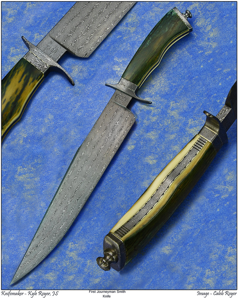

Hi Everyone,
Here is a new custom order I just finished.
It is also the first knife I have completed as a Journeyman. The 10" blade is forged from 1080 and 15N20 in six bar "Explosion" pattern damascus. The blade also has a slight "Sharks Fin" (that term came from a fellow forumite, Rob Connally) at the clip and a domed spine. The fittings are also "Explosion" pattern damascus. The liners are made of thirty two thousandths thick German Silver with Vine and Thorn Pattern File-work. The handle is of Premium Fossil Mammoth Ivory. The overall length is 15". This was the first I've done a six bar "Explosion" pattern on. I've done a Four bar a few times though.
This was also the first time I've done a handle a few thousandths larger than the fittings with the edge rolled over to allow for expansion of the mammoth ivory. I will be doing it like this from now on, unless someone wants it done the other way.
Something else that I did different, is that I made the handle a little thicker than I have been because I've had some input about my handles being a little thin. I like the feel of this one and if y'all think it looks good I will continue to make my handles a little thicker like on this knife.
Caleb had a hard time photographing this knife because the overall length. I think he still did a good job.
Let me know what you think.
Thanks for looking and God bless.
:eek:WOW!! That sure is incredible Kyle!! Awesome work, Beautiful multibar damascus:thumbup:
Your control over your damascus patterns is truly impressive - as is everything else about this knife.
Roger
The damascus and ivory look great. Your detail work, as usual, is quite attractive. You know I dig the "shark fin". The pommel nut looks really nice with the design you put on it.
Would love to handle this knife to see how it feels in the hand. The shape of the handle looks like it is very comfortable and would fit well. Hope the owner posts and gives us impressions.
Really nice job on your first one as a JS, Kyle! Congrats to you, the new owner, and to Caleb for the cool pics.
I feel a component of your quick success has been your acceptance of a broad range of input and ideas from those around you and incorporating what you feel comfortable with into your designs. An open mind is the first step towards perfection.
The thicker handle and your rolling of the ivory to the ferrule are substantial improvements here. I also like the thinner liner material and more subtle filework.
Beautiful ivory by the way.
On the other side of the coin, I prefer your four bar explosion damascus as I feel the six bar compresses the pattern too much.
Overall, another outstanding piece. :thumbup:
"shark's fin", I like that Rob.
Kyle, that's just looking great! The shark fin adds interest, and the handle details and "round-over" are top notch.
John
Damn, Kyle........I can hardly wait to see what your MS knives look like!!! :eek: :D
