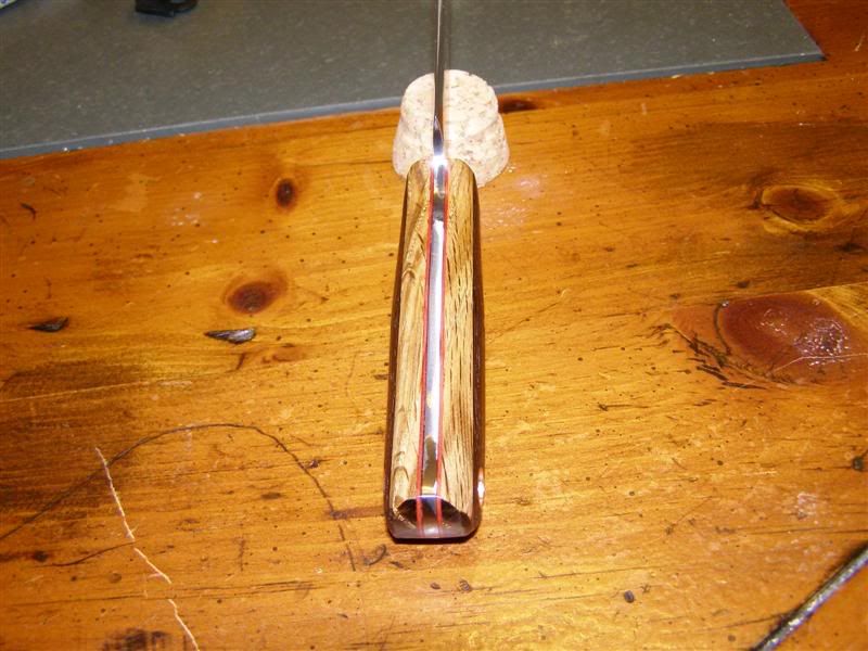

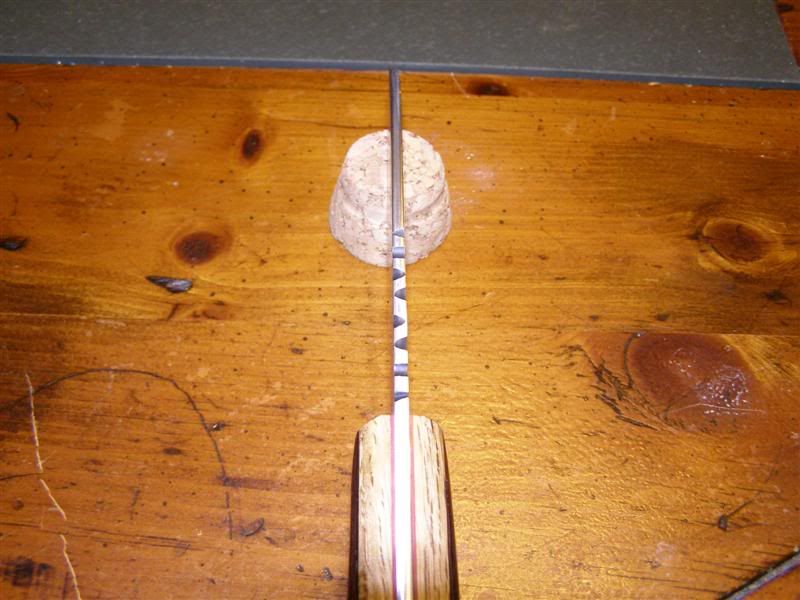

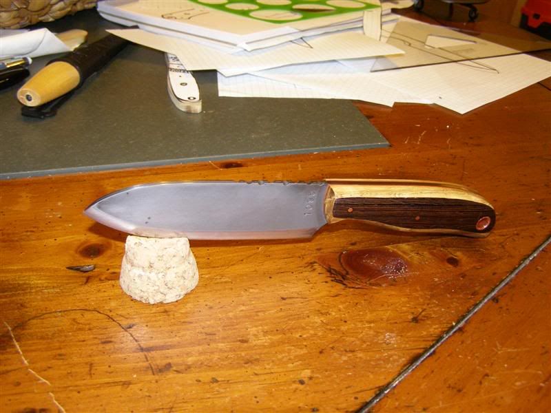

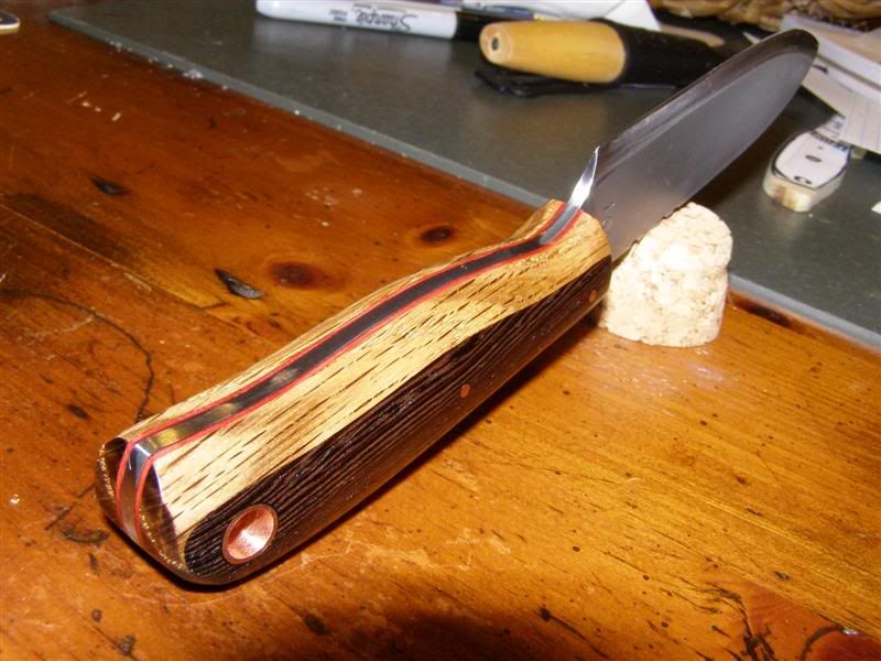

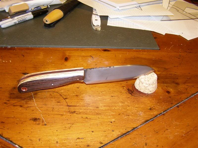

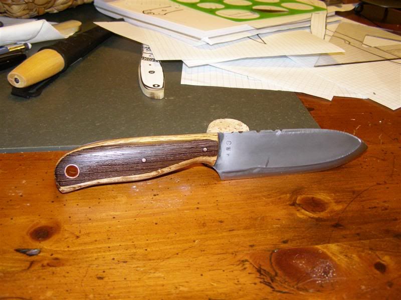

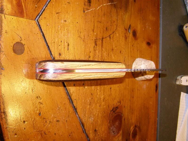

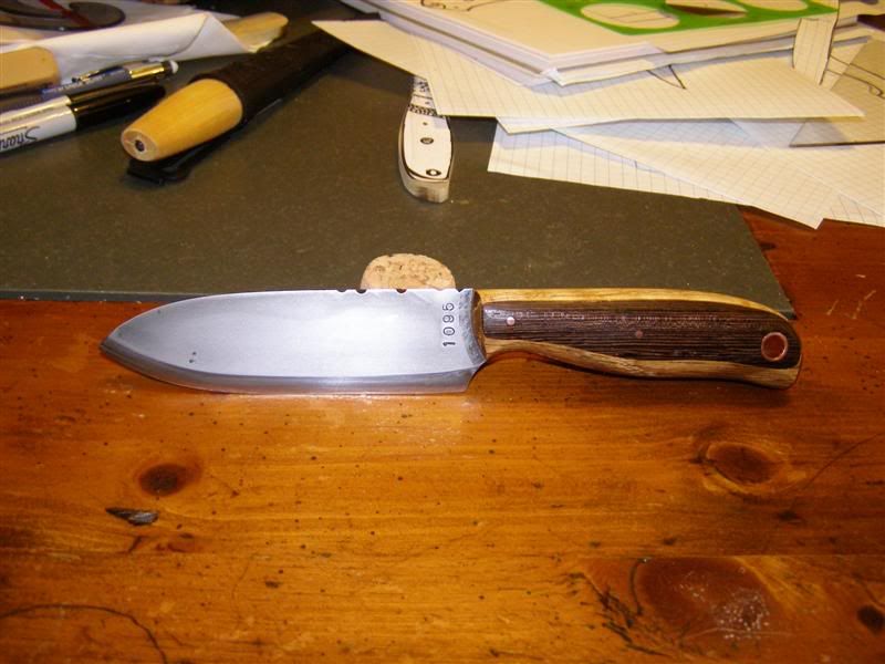

I posted this in the Wilderness Forum, but wanted to share here, also.
1/8" 1095. The blade length is 4 5/8" x 1 5/16" tall. The handle is 4 3/8" long, and just over 7/8" thick. Convex edge grind, oak & wenge handle w/ red spacers and copper hardware.
I'm happy with it. One of the things I've learned from the Maker's section is to keep your first knife; so, I made this one for me.
You can see some imperfections. I became impatient, and made some mistakes; but, it's not too bad.
