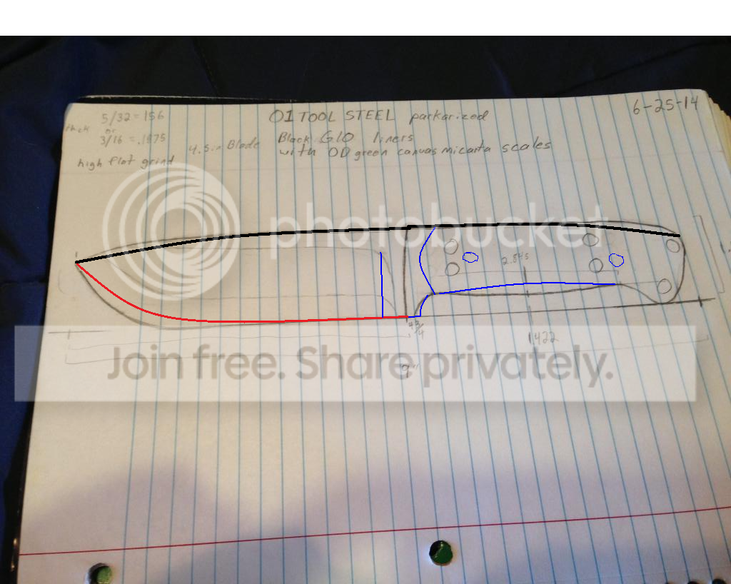

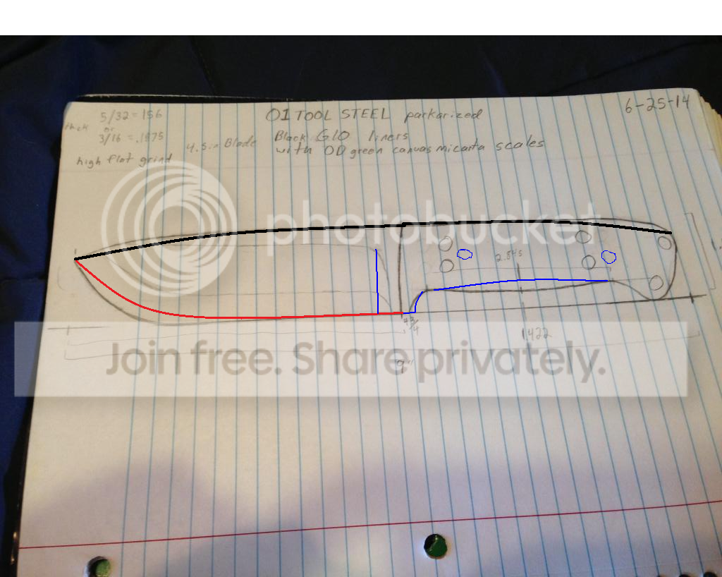

I'm wondering if some of the people that have done this before would help me critique my design. I'm not sure of all the technical terms and such but I would love to learn. It's a drop point bushcraft style. im planing on using O1 tool steel 3/16 thick, with grean canvas micarta over black G10 liners. 9in overall length, 4 3/4 from handle to tip. I'm planing on a high flat grind. I'm not certain on the pin location or number yet. It will be used as a hunting/woods knife as I don't EDC fixed blades. With all that being said here it is.
It looks like a pretty nice and simple design. The only thing I might consider changing is the belly of the blade. It looks a little bit fat to me (I'm one to talk). See what you think of it with a little less belly on it. Otherwise, looks good. Dive in!
I'd probably thin the handle out a bit and deepen the choil. Think about how fat the grip will be too.

Also when taking a picture of a drawing, try to get directly above the drawing, taking a picture at an angle distorts what the rest of us see, also rotating the picture before you upload is nice, I always get a kink in my neck when the pics are sideways ;0)
My standard advice: Make a cutout of your design on a piece of cardboard or thin wood (ideally same thickness as your intended knife). There's a lot to be said about having it in your hand vs. looking at it on paper. Simple is good, but also pay attention to your lines; what is aesthetically pleasing?

i would go for a single smooth curve on the bottom part of the handle, just for keeping it simple. Just an opinion!

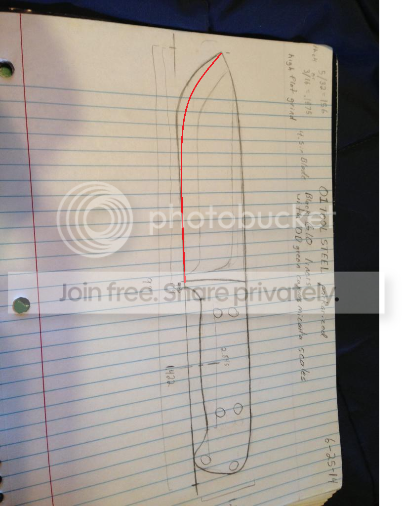

Wow thank you all! Keep the ideas coming! My main concerns form my original drawing where that the spine was too flat and the high flat grind would not leave much meat to the blade. I kind of want it to be a blade heavy knife just for hunting and general brush work so I still want some .187 thick material on the blade. Also that the blade was too straight but l seem to like what Shane came up with. Also I like the idea that JK came up with in that the spine is more sweeping but I want to stick with my tip and rear handle ideas.
Also thanks for the 3D tip I kinda did that with a paper photocopy of the knife but nothing in total 3D. Sorry about the pictures I didn't know how to rotate them.

Hard to get it exact since I'm not great with MS paint I'd go something like this. Leave a bit more ricasso, take the belly out of the handle (cut out both versions and see what feels better to you. Like someone else said deepen the choil a bit but not make the transition as square is it is in that pic at the front of it. I'd just go two pins/Corby bolts in the handle (although centered). Easier to line up two on your first knife but that's just an esthetics thing adding more. Oh I'd also round off the front of the scales and not have it be part of the finger guard. Could consider rounding out the butt a bit too but again personal preference.
Like this only not as crappy of a curve.

Well I have a lot of re-drawing and testing to see what feels good to me. Keep the ideas coming!

As you can tell by the different drawing changes an 1/8" makes a big difference in how a knife looks and functions. It doesn't take sweeping changes just little tweaks.

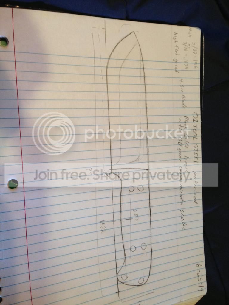

Thanks everyone! Just a bit of an update, I got my harbor freight 4x36 belt sander in(yeah I know it's not the best but it'll have to do for now) I'm working on this as time allows but I do plan to keep it updated. Also I plan on using my original drawing for three reasons, #1 this is my first knife so if its not the best oh well it will be a learning experience. #2 I kinda mocked it up in card bored and it honestly felt great in my hand and #3 I already had it traced onto a piece of mild steel that I plan on using as a templet/practice grinding on. Then after I feel I'm doing ok I'll move on to the way more expensive O1.

Everybody here has given you excellent suggestions. Mine? Just make the knife. I too tried to follow a precise and detailed plan for the first knife I made, and it came out entirely differently than the drawing. Make your knife with your design in mind, accept the imperfections, learn from them, and then go make another.
