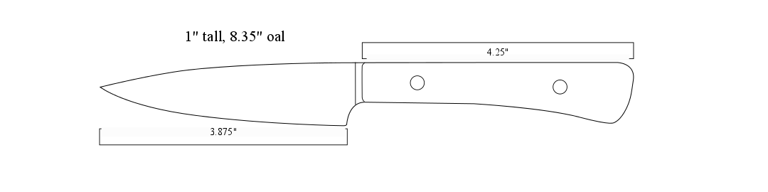

First knife design. Please critique/advise
Feb 1, 2010
39
I'm going to attempt a kitchen/utility knife for my first go 'round. At this point I'm thinking I'll use 3/32" 440C, as I will be sending it out for heat treating. Here's what I have so far.
Thoughts? Opinions?
I like your design. Assuming it will be a paring knife, I would go with 1/16" AEB-L, hardened to Rc 61. Good luck.
Tim
I like the design a lot. 440c is a fine steel, but I also think 3/32 is a bit thick for a utility/paring knife.
I like the design as well.
Just make sure that the transition from the handle to the dropped edge is rounded a bit so that it doesn't irritate your indexfinger
It looks excellent for a general use kitchen blade.
As said, .060" stock is a good choice for a 3" kitchen blade. .090/.100" is fine for larger blades and heavier kitchen tasks. Your blade falls right at the transition of those. With a good distal taper and FFG, the .090" stock would be OK, but if it will be a slicer and general light task knife, I would go with the .060" stock.
AEB-L will take a very fine edge and sharpens easily. CPM-S35VN is the kitchen champ, IMHO. It is a bit harder to sand and sharpen, post-HT, but takes and keeps a great edge.
The only feature on your sketch that draws my eye is the butt looks a little fatter than it needs to be. It isn't a lot off, but seems to be about 1" wide. You can start with what you have and reduce it a bit as you grind and shape the handle.
Your steel choice is fine but would use 1/8th" max. Since you will have to get a new piece anyways cuz what you have is too think Id actually get ahold of some .090" AEB-L.
Jay
Jay
????? He has 3/32...which is thinner than 1/8". 3/32= approx. .090", 1/8" = approx. .120"
Not sure I follow how 3/32 is too thick but .090" is just right. Perhaps someone can explain that.

If you think in thousandths, it's much clearer.
Thanks for all of the input, everyone. I had a suspicion about the thickness. I will go ahead and use 1/16" instead. I will also look into AEB-L. I haven't bought any steel yet, so no problem there. I'm trying to figure out as much as I can before I do much spending. On a pretty tight budget.
Not a bad looking paring knife. I made my first one or two out of some 3/32, and quickly decided that 1/16... I mean, I used .090 at first, and decided that .060 was better by far.
One thing I might add: I generally try to avoid any straight lines (i.e. the back of your handle) when designing a knife, especially in the handle area. For that size handle, it probably won't really make a huge difference, or detract from its utility, but it's something to keep in mind for larger knives.
Thanks for the input. What is the advantage to no straight lines?
It's just typically more ergonomic/natural to hold. If you look that hand, and more so the palm, you'll have a very difficult time finding any straight or flat areas.
Squeeze a piece of clay in your hand and see what it looks like. It will follow the natural curves of your hand.
Not to mention the natural forward canting of your hand from your wrist. The straighter the spine, the more you'll have to turn the knife forward to cut.
