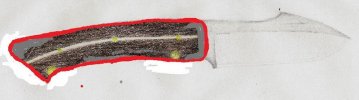

I found some of my kids' colored pencils and whipped this up, after weeks and weeks of changing it on paper and pencil and cutting cardboard. I won't ask if this looks like anyones, cause I'm sure there's 200+ knives just like it.
I wanted a carver that could possibly serve as a companion knife for a Beck WSK that I eventually want to do. I originally put the point on the spine for a possible gut hook in the future (when I figure it out), but I like the look and might just keep it there.
I plan on using 5160, sanding to a rough 800 grit, then doing the bevel up to maybe 1500-2000grit. The scales will be african blackwood with stabilized white holly. After seeing it in color, I might go with silver rivets and lanyard holes. I know the handle is complex, I'm not to worried about it, lots of learning to be had, haha.
Total length is 8 1/4", blade length is 3 5/8".
No blanks have been cut yet, so if anyone can offer criticism, and tips...I'm wide open.

I would suggest this: Keep the basic shape of the blade however I would get rid of that curved part in the back. Keep the tip area as it is but rather than have that curve in the blade keep a nice flowing line back into the handle area. So it won't look as though someone took a bite out of the back of the knife.
Second would be to get rid of that belly towards the guard, it's going to be uncomfortable. The natural contour of the hand when it grabs something it's preferred to be tapered where the thumb and index finger meet and flare out a bit from there. I also think the placement of the pins looks a bit clumsy, 3 across the center would be fine, I'd eliminate the 2 underneath them.
Get a piece of cardboard and cut the shape out and "use it" for a few days and see how it feels. It's cheaper to waste cardboard than it is steel. One thing to keep in mind is: What is the purpose of the knife going to be? Hunting, everyday carry, fantasy, tactical, etc. IMO it's better to have a comfortable, functional knife over something that "looks cool".

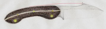

Something along the lines of this for the blade, then whatever you decide to do on the handle.

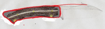

I forgot to mention that. Like Fletch said, that "hump" or whatever you want to call it towards the front of the handle would made holding the knife kind of awkward. I would just level it out like this:

The two bigger ones that look like rivets are actually lanyard holes. I'm not sure where I'd prefer it, but I've almost dropped knives before with a lanyard hole near the butt, and the first thing I've thought is that it would drop tip first and swing into my leg or something...so I was going to try putting a lanyard hole in the center of balance area so I dont have to worry about the blade hitting me.
I would not worry as much about the blade design, you know the old saying "different strokes..."
I have found that no matter how cool a handle looks on paper it isn't neccesarily so in life. A few have commented on the front swell in the handle, that would also be my biggest criticism. Based on the measurements you gave the fore and little finger will have less purchase because of the larger diameter at the front and rear. IMHO this would be very awkward in extended use.
I just drew it out with a smooth/flat spine that flowed into the handle, and removed the bulk near the ricasso. It looks like a kitchen knife, haha...oh well, i'll keep messing around with it, and maybe do a couple wood mockups this weekend.
I am a big fan of what I term the Loveless style handle (mostly where I see it). I tried it out on your knife I think it looks pretty good.
I kind of like that with having the blade flow into the handle like this.... Naturally there are some humps in the MS Paint mock up. Again Emph it's your knife and make it however you want. But just some suggestions to consider.

I've made a lot of changes. I also just completed the rough mock up out of wood, and I think I like it...I'm attempting a pretty challenging handle made out of gaboon ebony and stabilized white holly. I have enough for two shots at it, I have two back up scales of macassar ebony that should be relatively easy to shape. Also going with 2 3/16" stainless steel rivets and a 1/4" stainless steel thong hole tubing for the lanyard hole.
Flow is very important in a knife. As has already been mentioned, funky protrusions might look cool on paper, but don't necessarily make the knife function better.
That 'loveless' handle re-design looks absolutely right, imo. Easy to grip from any position, gloved or not, and it flows right into the blade.
My biggest worry, though, is having the pins right along the joint between the woods. You've basically cut the holly into four pieces, not a problem, and don't have any support for the top piece of ebony. I'm not saying you're glue joint will fail, but if it does, you lose part of the handle.

After all the design flaws my initial design had, I can't help but completely agree with everyone here. I do like the Loveless handle but I really want to develop my own style. After I actually made the wood mock up I've been considering a few other changes as well, but I think those will emerge when I finally get my hands dirty.
I'm also considering saving the holly and gaboon ebony for my next knife an just using the macassar ebony for my cherry popping knife.
