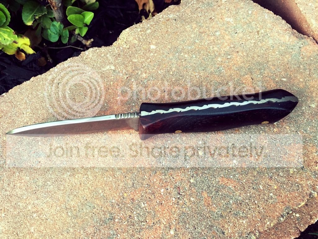

I just finished my first knife. I made it from an old file. Now that it's done and I've taken more time to examine it there are more flaws than I originally knew about. Most of it could be fixed if I go back through the annealing process and spend a little more time on it.
What are your thoughts on spending more time working towards perfection on this one vs just starting another? I know that's even harder to answer without pics.

I thought I didn't have permission to post photos yet but now I see I just can't have any attachments.

The main two things that are really bothering me are the curve in the cutting edge and the fact that the grind is not symmetrical.
Fixing those two will take care of the majority of the rest (that I see anyway) such as some of the scratches and uneven grind lines.
I was also originally planning to put some scales on it and I guess I may still do that if I get this to where I want it. If not I'll just leave the handle as is because its actually fairly comfortable.

And if you see any other areas that need improvement let me know! I want honest feedback!
It would help to know what tools you are using. A belt grinder, files,drill press? Etc. What i see in the pics is a good 1st attempt that practice will improve, be it on this blade or a new one.
I would try to fix it , that what I do ( my issues are usually from not being able to polish out marks on the blade )
My $.02 is as follows -
Leave it. It's a good first attempt but it also that line in the sand to be referenced as you keep going forward.
I'm pretty new also. I'd go with what Jake just said. Move right along. The next one will have flaws too. My experience is that each has flaws but I try to focus on a different aspect on each knife so the flaws are different but the skill set grows and grows and so does the collection of tools.
I have the feeling it's going to bother you until you fix it.
Anneal it, and I suggest using files to work on fixing the bevel, and the ricasso.
The choil/ricasso (that part at the bottom end of the edge, there) is tough to keep in order, and that's coming from Bob Loveless!
I use files to set my bevels. It's slow, nerve-wracking work, but it's (almost) impossible to screw up.
Some things can only be fixed by time, sweat, and sore thumbs.
This was my first and last knife made. Made it from a Nicholson file several years ago. Most of my time was correcting the initial mistakes--did it all by hand. I believe you should maximize the potential of your knife before you move on! Yours looks great though, nice start!
