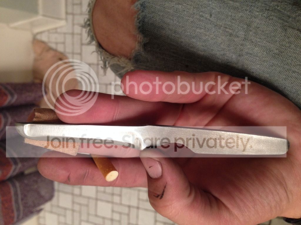

Well, this is a lot of firsts for me. First time buying a file, tempering it in my oven, first time on a bench grinder, first time grinding metal at all haha, etc...
I'm 20, a "starving musician" and I work in food lol... But coming from an engineering background education-wise I've got a huge passion for edged tools, knives and swords specifically.

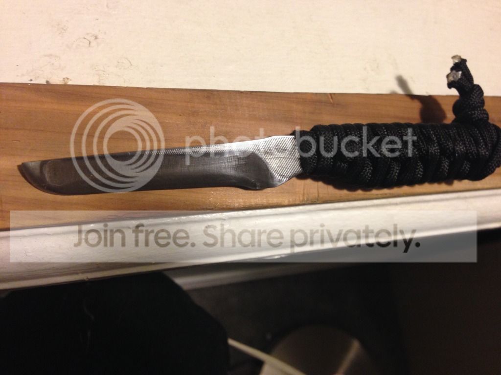

Here's what I made from a brand new 6" Nicholson flat bastard file.

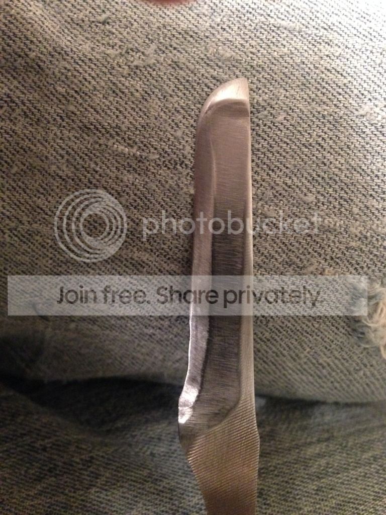

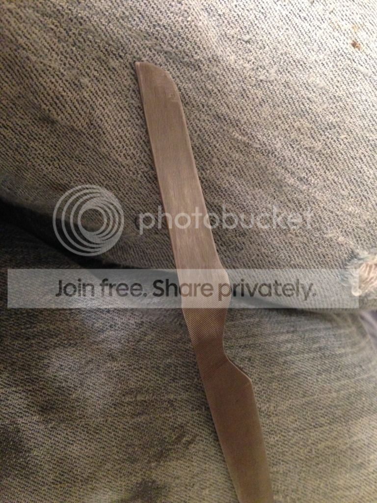

All comments are welcome! It was a pretty wacky design at first but I wanted to try and set my personal bar a little higher than just a full flat grind. I had fun and learned a lot, it turned out okay.
I'd really appreciate any kind of feedback I can get, any tips for gettin' those bevels flatter with a bench grinder...I'm just gettin' my feet wet making knives.

Buying a new file to turn in to a knife is quite an expensive way to make knives.
Better buy a known steel or used (thin & flat) files. (thrift stores/garage sales etc.)
Flatten the bevels by draw filing them, then hand sand. Start at 120 and work your way up.
Well, what that is, is a prison shank by nearly every definition....but it is still your first knife and I know you are proud of it. Make sure you keep it, as it will show how much better you get in a year, if you continue to make knives.

A bench grinder is a terrible tool to use for making a knife. You can shape the profile on one, but don't use it for shaping the bevels. Use files and sandpaper.

Not sure if this is what you're referring to, but grinds can't really be flat when using a bench grinder. What you'll have is a hollow grind. If you want them flat, you're going have to use files and sandpaper/sanding sticks if you don't have access to a belt grinder with a flat platen.
Any particular reason the tip is left unground? Atleast, the photos appear that way.

Motivated99, yeah I'm sketching some designs along the lines of what you described for my next knife. Probably with a bigger file too. The reason the blade ended up so much smaller than the file was because of the bench grinder. I just couldn't get the bevels right so I kept grinding away 'till I was satisfied.

Lone Fortress, interesting...I thought I could get a flat grind by holding the blade vertically to the wheel and moving it up and down...But yeah it proved quite difficult. Still fun, even after losing my fingerprint lol. But I will keep that in mind.
Also, the tip isn't not ground, I tried to do a main and secondary bevel for the most part of the blade and have the secondary bevel converge with just a single bevel at the tip. Actually came out pretty cool and is fairly sharp after going through the stones.
