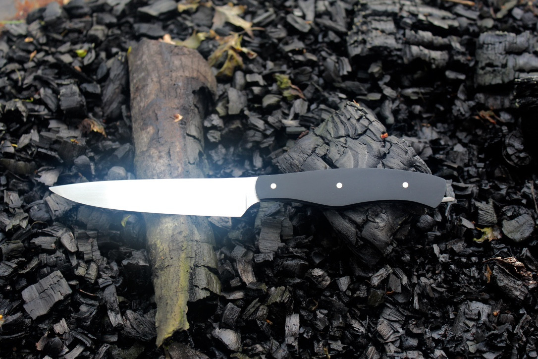

Well, I haven't been around much for several reasons not relating to knives, blade forums or anything knife related. I recently had the opportunity to get back into the garage and have some fun and this knife is the fruit of my labors. It's O1 at 59-60RC and is designed to be a pairing/petty kitchen knife. I'm not very good at photography, but in terms of the weird lens flare there are two possibilities: #1: NJSteelBaron switched my O1 stock out for Elven steel and there are orcs near by, or I'm getting some weird lens flare.
