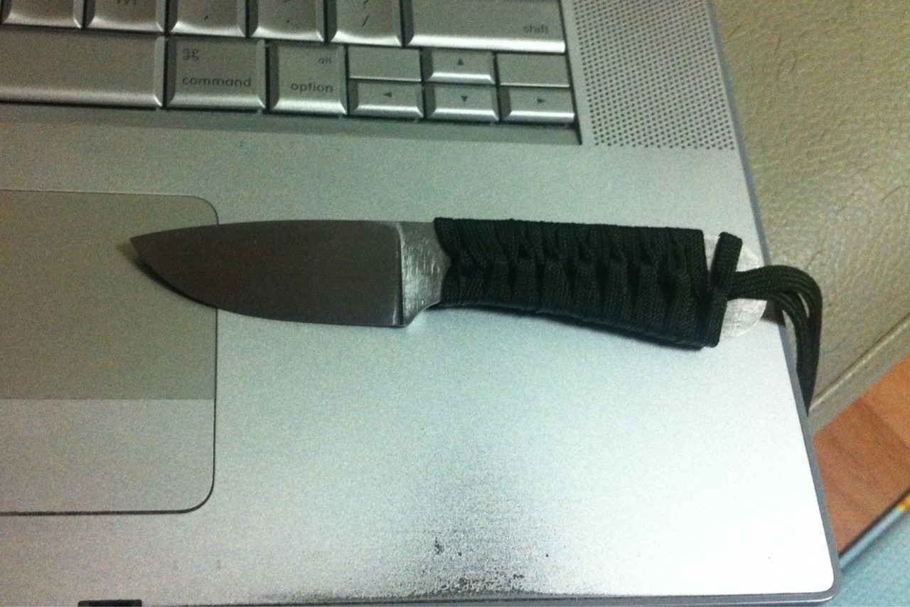

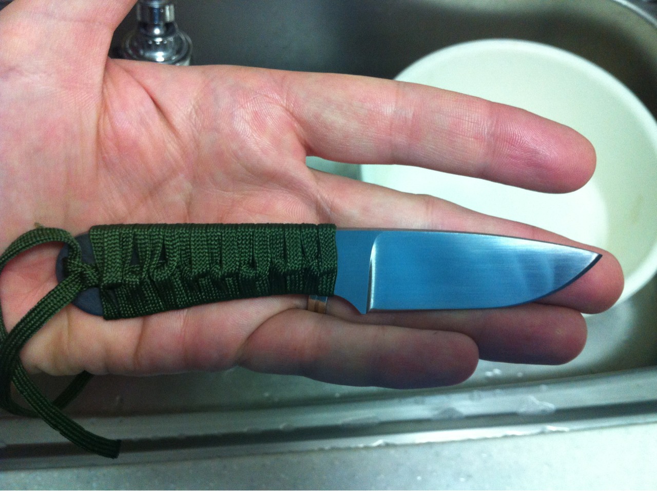

The reason I'm asking is because last night when I started hand sanding out my file marks I found a low spot near the ricasso (You can see it in the picture with the cord wrapped handle at the end of this post). An hour or more later with 120 grit and that spot was still there, but the other file marks were long gone. So I've decided to go back and file it out. But this got me to wondering how I will ever get my blade thin enough after heat treat, given how much time it took to make any progress on that low spot.

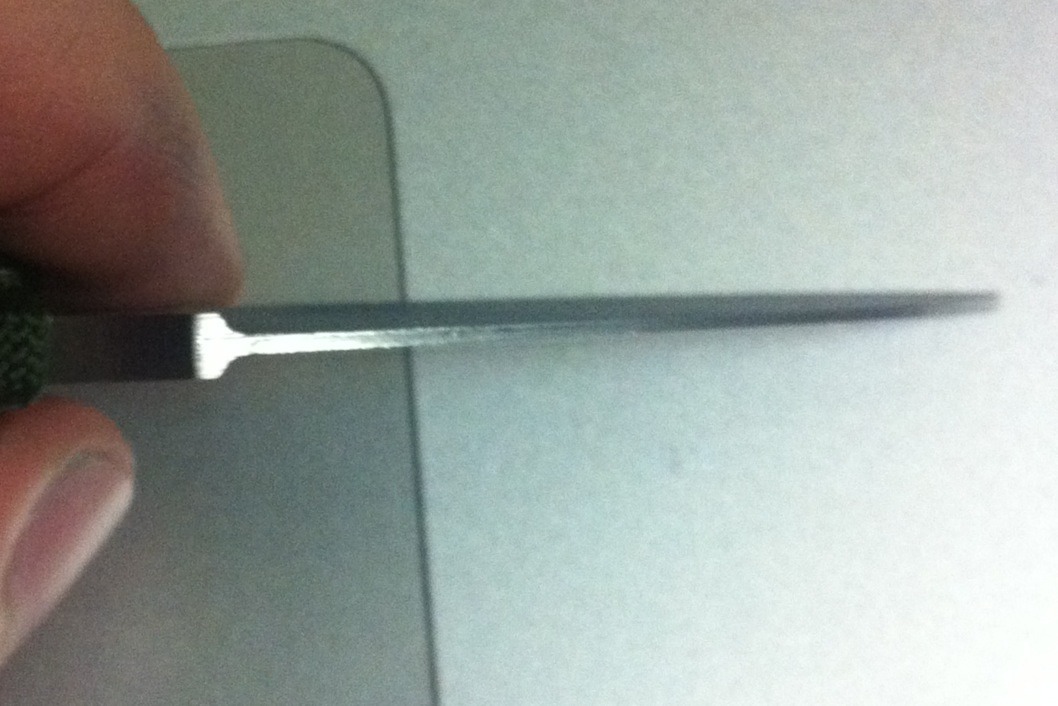

Here is a picture of the thickness I have now. The blade is made from Aldo's 1/8" 1084, which I then sanded down a bit when I took the plunge cut a little too high. Since it started out thicker than 1/8" it's probably around 1/8" now. Does that look okay for heat treat?

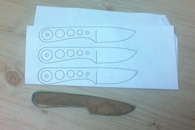

I designed this using inkscape. It's not exactly setup for technical drawing, but I made it work. You can export to dxf if you want to have something waterjet cut, which I considered doing initially, since profiling takes so long with hand tools. I actually made several designs, and traced them onto cardboard, and finally wood. I tried longer and shorter handles, but this one felt the best, since the bulge sits near the center of my hand. My son likes playing with the wooden one.

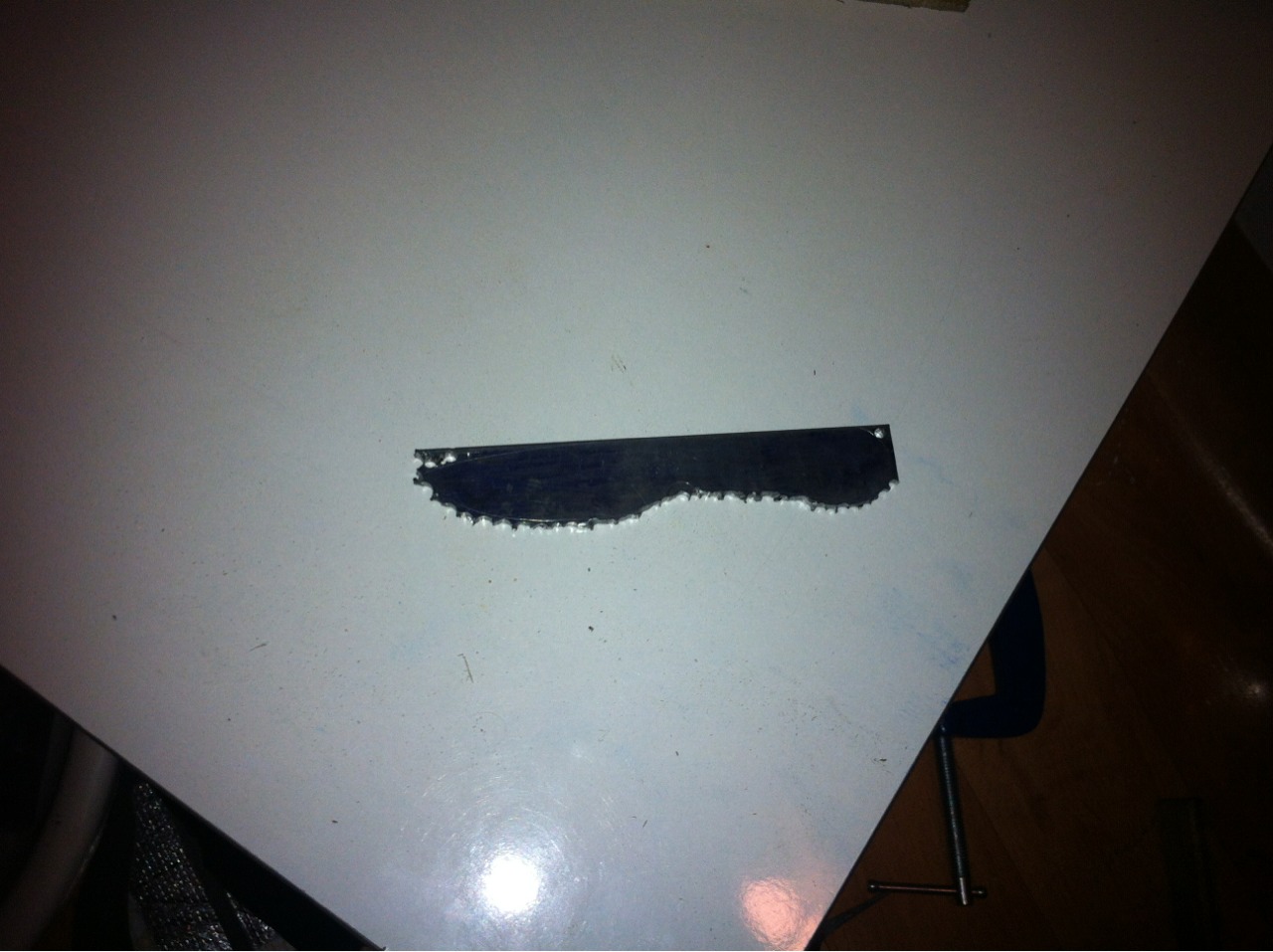

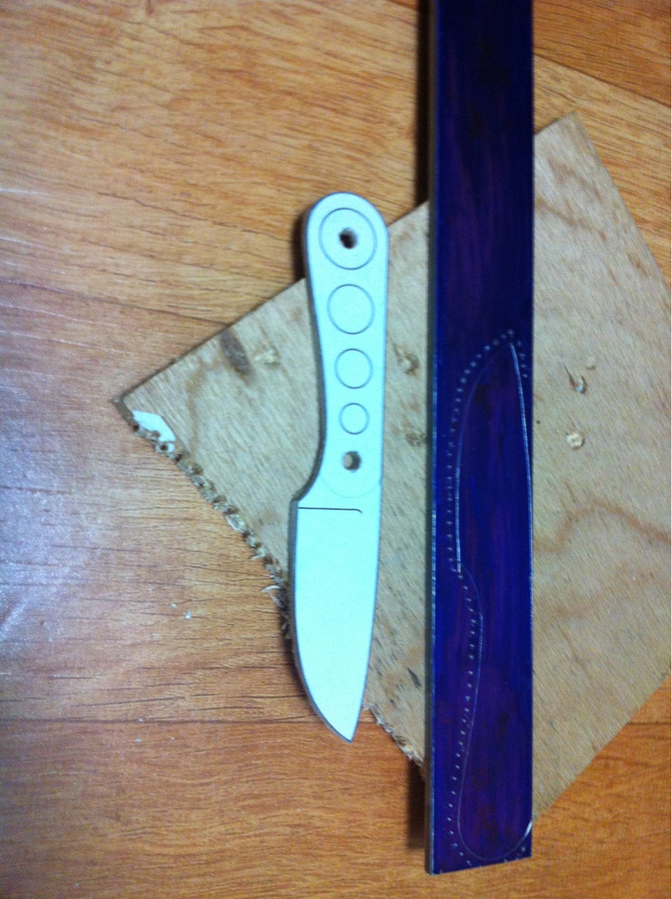

I taped a printout to the back of a picture frame and cut it out. Then I traced that onto steel. The dots are center punches for drilling (Next time I'm doing those one at a time. The holes ended up too far apart. *Drill*Punch*Drill*Punch*...)
Partially cutout

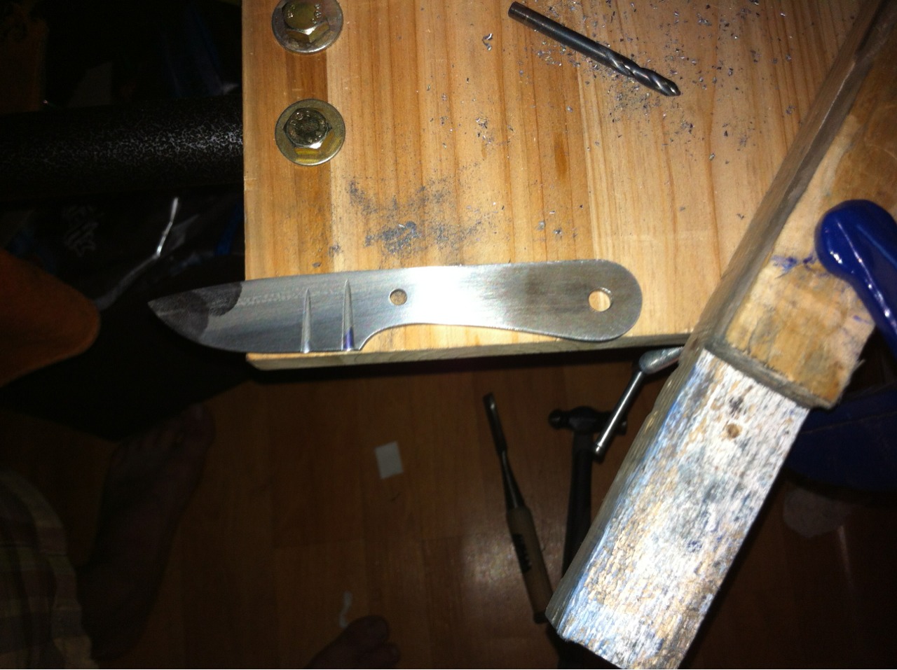

All cutout, and plunge cuts made. The practice cut on the left came in handy when I was filing the bevels. Practice didn't do as much good as hoped, though, as I ended up going much higher on my actual plunge cuts. (I think this turned out to be good, though. The blade still feels quite thick to me. A narrower bevel might have been too fat to cut well.)

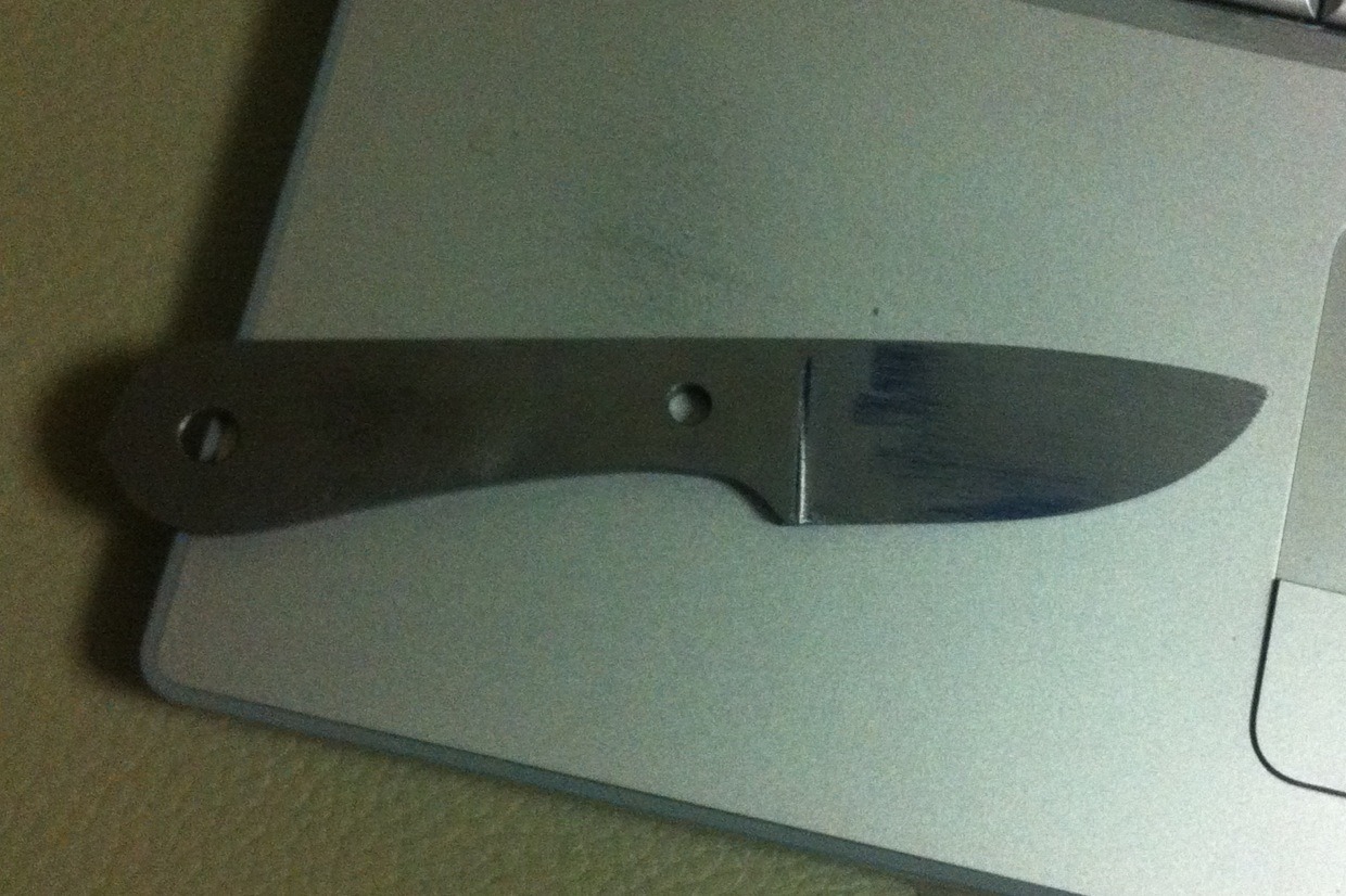

Bevels are done.

I have read on here that you should keep the edge about the width of a dime before heat treat. My edge is about that thickness now, or probably thinner. I'm wondering how realistic that is when using only hand tools, though. Can you really take enough steel off after HT to get a decent edge with just sandpaper?
Very nice!
I think that most folks who leave edges that thick are doing finish grinding with belts after HT.
Personally I've had good luck bringing 1084 down to as little as 0.015". I've gone smaller with success, but can't in good conscience recommend it. 0.020" is probably a safe target.
Since it's all hand work, and you've done a great job so far, I would reduce the edge thickness by half. As well with such a clean finish there shouldn't be much clean up to do after heat treatment. Frank
Thanks Daizee and Frank. I've got it taken down about that much. Hopefully it's not too thin now, but it feels a lot better. Unfortunately, in the process of making the plunge cuts deeper, I also brought the grind height up even higher. I think I still have enough thickness to fix up the transition after I finish the bevels though.

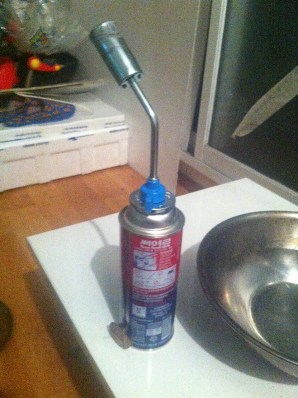

Well, I got it hardened and it's now in the oven at 190 C. I think I had to try about four times to harden it. Here's what I used for heat. Cost me around $3 for the torch and $3.75 for four cans of gas. Not ideal, obviously. But I've used a propane torch in the past, and this honestly worked about as well as a single propane torch. I might pick up a second cheap torch for my next knife, and the two together should probably put out plenty of heat. Not elegant perhaps, but living in an apartment in a foreign country, it's nice to have stuff that I can just toss if need be.

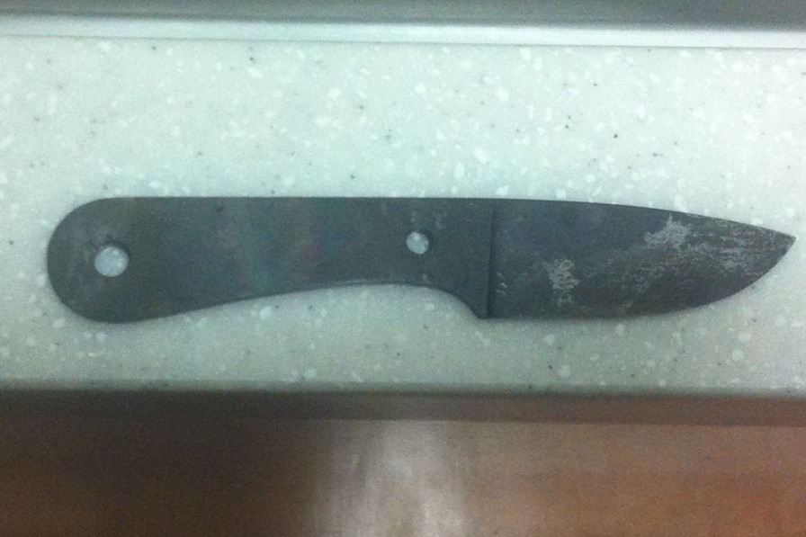

Here's the knife all charred up.
Here's the torch:

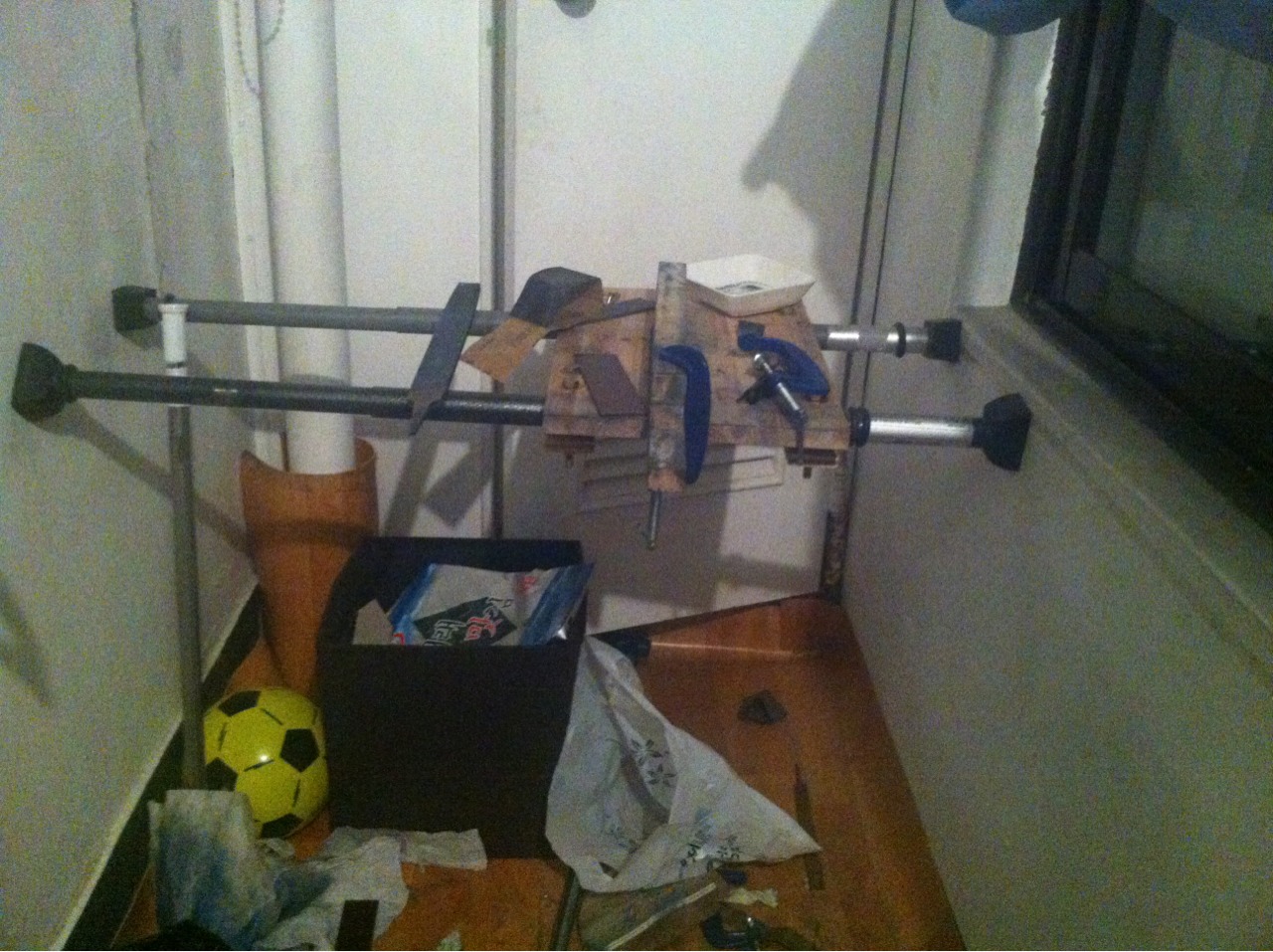

And here's a shot of my "workbench". Two pull-up bars with a board bolted to them. Like I said, living in an apartment!

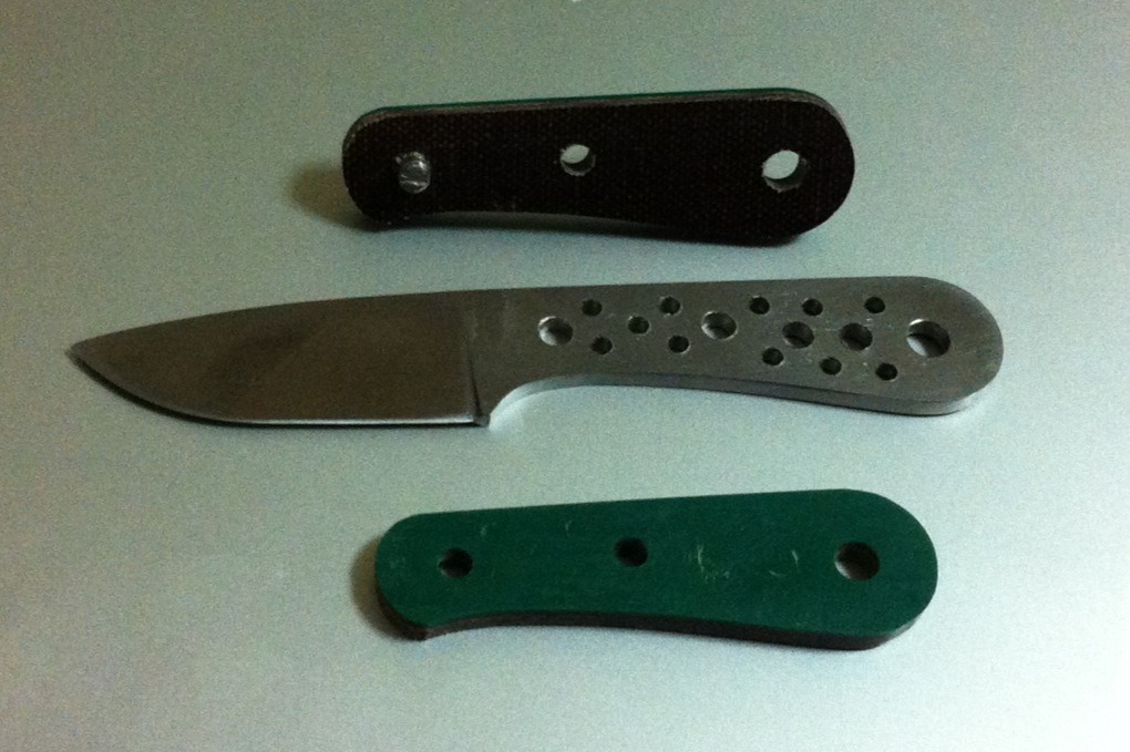

Now I've got to get a real handle on it. I actually like the way the cord feels, but I won't feel finished unless I put some slabs on it. Wouldn't want to be kept awake at night! I tried out some green liners made from some flat plastic thing I found in a store. Unfortunately I didn't get them flush against the micarta when I epoxied it up, so I'll probably just end up with 1/8" scales on this. That's ok, since I intended this to be a neck knife.
Thanks parbajtor for the tip on the diamond file. I found one at a discount store for $1.50! It was pretty coarse and I ended up scratching up my finish, but I got it sorted out. I also scored two files, a half round and a flat bastard, for $3.50 together! They look pretty poor, but for that price I couldn't walk away.
And Stacy, I thought I wouldn't have to go down to 120, since I had gone up to 320 before HT. But you were right and I had to do it to get the scale out of my plunge line. Guess I was a little hard headed there. ;-)
Here's the latest pic.
That's nice. Right away I notice a crisp, clean plunge line, and the overall design is very handy. :thumbup:

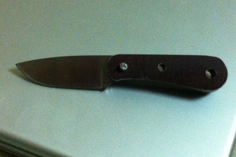

Now that she's gone, I have been able to get back to work. I started making the scales. Got them mostly profiled now, and tomorrow maybe I'll be able to start rounding them in. I felt like it was too heavy with the scales, so I added some holes to the tang since the last pictures.
I'm really missing the drill press I have back in the US. I don't know anyone here who has one (One friend had one and sold it!). I did my best getting the pin holes to be straight, but they're not perfect. Also, I ordered black, brown, and dark brown micarta. I had planned to use this dark brown since I started, and never even looked at the brown when I received it. But I just saw it a couple days ago and it's such a nice shade compared to this darker stuff. Guess I'll have to make another one of these...
