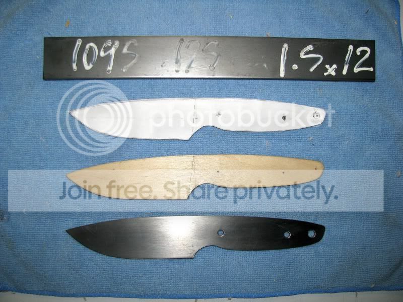

After having drooled over just about every knife I've seen here, I've decided to try my hand at the art.
I decided on a general use camp knife of my own design, though the influence of several of you, can be found in it. Overall length is 9 3/8", with a blade length of 4 5/8".
I made a thin plywood pattern from my paper sketch and then cut the rough blank from a piece of 1095 steel. Various machine and hand sanding operations later, I've got a blank that's ready for edge grinding. I'll probably do a flat grind This is the operation that will turn this into a nice blade (or a piece of junk). I bought a nice block of maple burl, some Corby bolts and white and yellow spacer material for the scales. My wife's glass fusing kiln should do the job for heat treating.

Thanks, Guys! I'll post up some more pics as I work my way through. I hope to get a usable knife first, then one with a little quality/aesthetic value.
Very nice lines on this. Is this going to be a full height flat grind?
Thanks, Josh! I'd like to see if I can get it to a full height grind, but I'm thinking I might be better off getting it to 3/4's or so for my first grind.
I ordered a Bubble Jig set up from Fred Rowe and he advised me to practice on some pieces of scrap steel to get the hang of it. I'm thinking the full grind might be kind of tricky for a first timer. Fred shipped my tools out right away and sent me a nice e-mail, offering his help if I needed it. I was very impressed.

You will be fine on a full flat grind, it is often the shorter grinds that are tougher. A scandi looks super easy and may be one of the toughest to freehand.
The file is your friend! If you get the grind close you can draw file it to straighten up the grind. It goes very quickly. I bet the bubble jig helps a lot in getting there. (haven't tried one)

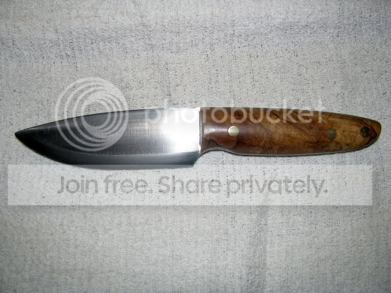

Well, here's my first knife. I started to play around with a Craftsman 2 X 42 belt sander and found myself grinding a scandi with a convex shape. I don't know if this is a legitimate grind, but after heat treating and tempering, the knife slices and whittles wood shavings like no one's business. After much wood shaving, the edge has held up very well and is still very, very sharp.
I sure learned a lot about making a knife with this one. I have a whole new appreciation for what you guys are doing. The line between a craftsman and an artist is blurred with knife making.
Overall length is 9 1/4", blade length 4 3/4", blade height is 1 7/16", full tang, 1/8" thick 1095 steel, heat treated and tempered to approximately 58-59 Rc, drop point, scandi-vex grind (?), maple burl scales, 3/16" brass Corby bolts and 1/4" brass tubed lanyard hole.
I heat treated at 1500 degrees (held for 5 min.) and then quenched it in canola oil that I had heated to 115 degrees. I then tempered it at 500 degrees for two hours.
