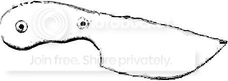

Hey guys. New to the boards. I haven't really been able to find the "exact knife" that i have been wanting, So after countless hours on the interwebs I finally said screw it and i'm going to make my own. It's a combo of one blade profile, with another mass production manufacturer's handle design. See question below the picture
I'm going to do a scandi grind on the top portion of the blade, and a flat v-grind on the larger "cutting side". I'm going to build a jig to help with both. My specific question is, what angle (in degrees ie: 5, 10, 15, 20, whatever) will I need to set my jig at to get the line that I am looking for in the below picture?

as I don't have a plasma cutter or table band saw Im having to do the stock removal method for my template. I haven't given much thought to what thickness I'm going to do the actual knife out of yet. probably need to start thinking about that. i'm thinking maybe 3/16? As to the blade profile it's going to be 3.5" long by 1.75" at the top hump, tapering down....

If you're working with minimal tools, I'd recommend 1/8" stock or even 3/32". 3/16 is a lot of metal to remove on you're first try.
I concur with using thiner steel. 1/8" is the max you want for a knife that size and use. I would probably use .100".
I know a jig or fixture sounds like it will simplify making your first knife, but it will more likely complicate things greatly.
Your drawing shows a curved blade grind and a swedge. This will be very difficult to do with a jig, as a jig will try and grind a straight line.
The angle will change as you get closer to the tip,too.
Think back to your trig, and you will realize that if the base of the triangle ( blade thickness) is constant, and the height of the triangle gets shorter ( as the blade tapers toward the tip), the apex angle will get larger.
Some of this is adjusted by adding distal taper, but it isn't a constant angle that can be plugged into a jig and get a good curved bevel.

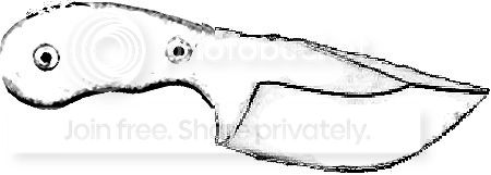

so i'm almost done with the stock take off. Need to touch up the handle and tie it into the blade a little bit more, but here's the general lay out. BTW, i have no idea what kind of steel this is. I got it from work from our guys out in the truck shop. it was left over from a set of stairs that they built.

What ever made you think that any piece of steel and in particular the one you picked up, would make a reasonable good knife? Without doubt what you have there is some material to practice on but that's it. Frank

Please read the above quote. Are you using this scrap for practice or to build the actual knife? If the former, fine. If the latter, stop right now before you put a lot of work into a knife shaped object that won't be able to be hardened.
Listen to the guys that posted ahead of me on this thread, they all have a lot of experience and are very smart. They aren't just feeding you a line of bs.
Pretty much any steel used to build stairs will not be of the type to harden for a knife blade. Using scrap and unknown type steel to make a knife ( especially as a beginner) is folly.
Fill out your profile, read the sticky info, make a plan on how you are going to do the build, and post it as a thread. I guarantee that one of us will send you a piece of good knife blade steel to make it from. HT is often offered to new makers by one of the folks here,too. We are a really sharing community for those who come to learn, and are willing to do their homework.
