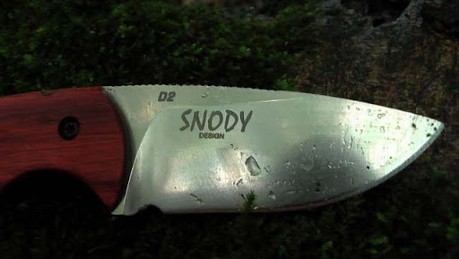

I don't understand the purpose of the "little grip cuts" (other than to put blisters on the user's palm).
The grip cuts are on more of the handle than just where the photo shows them. Google Benchmade Adamas.
They work rather well for giving you a grip, I'm a large fan of them, most commonly I seem to see them on the top of the blade, where a thumb would/could go to assist pushing the knife, in something like carving.
Don't knock it til you've tried it!
Benchmade Snody Activator has it as well, both knives are some of my favorites
