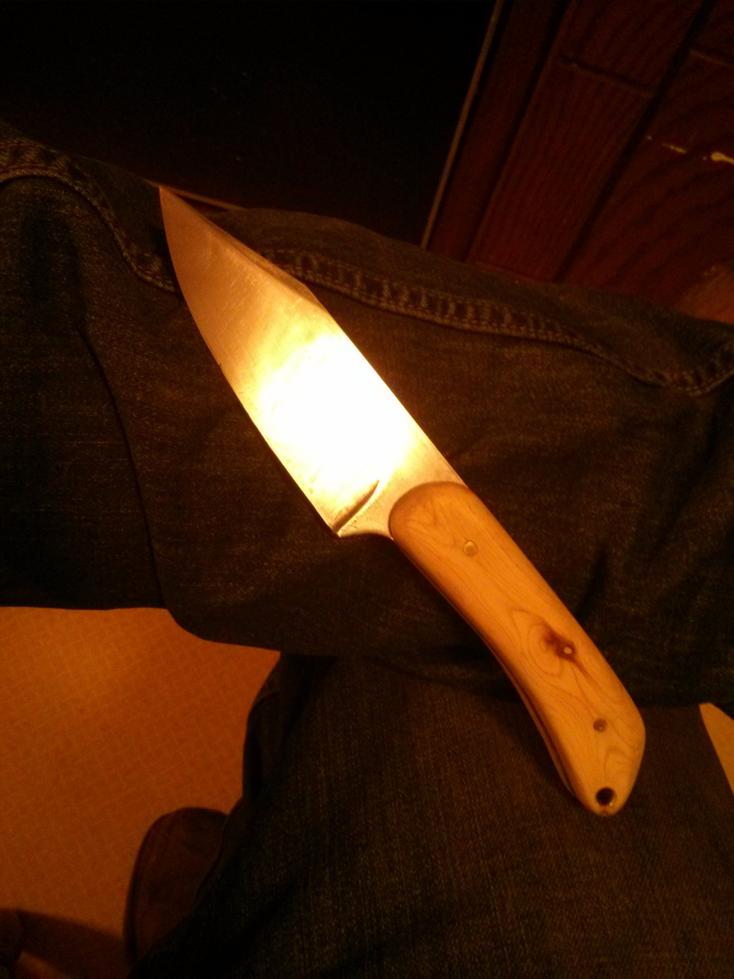

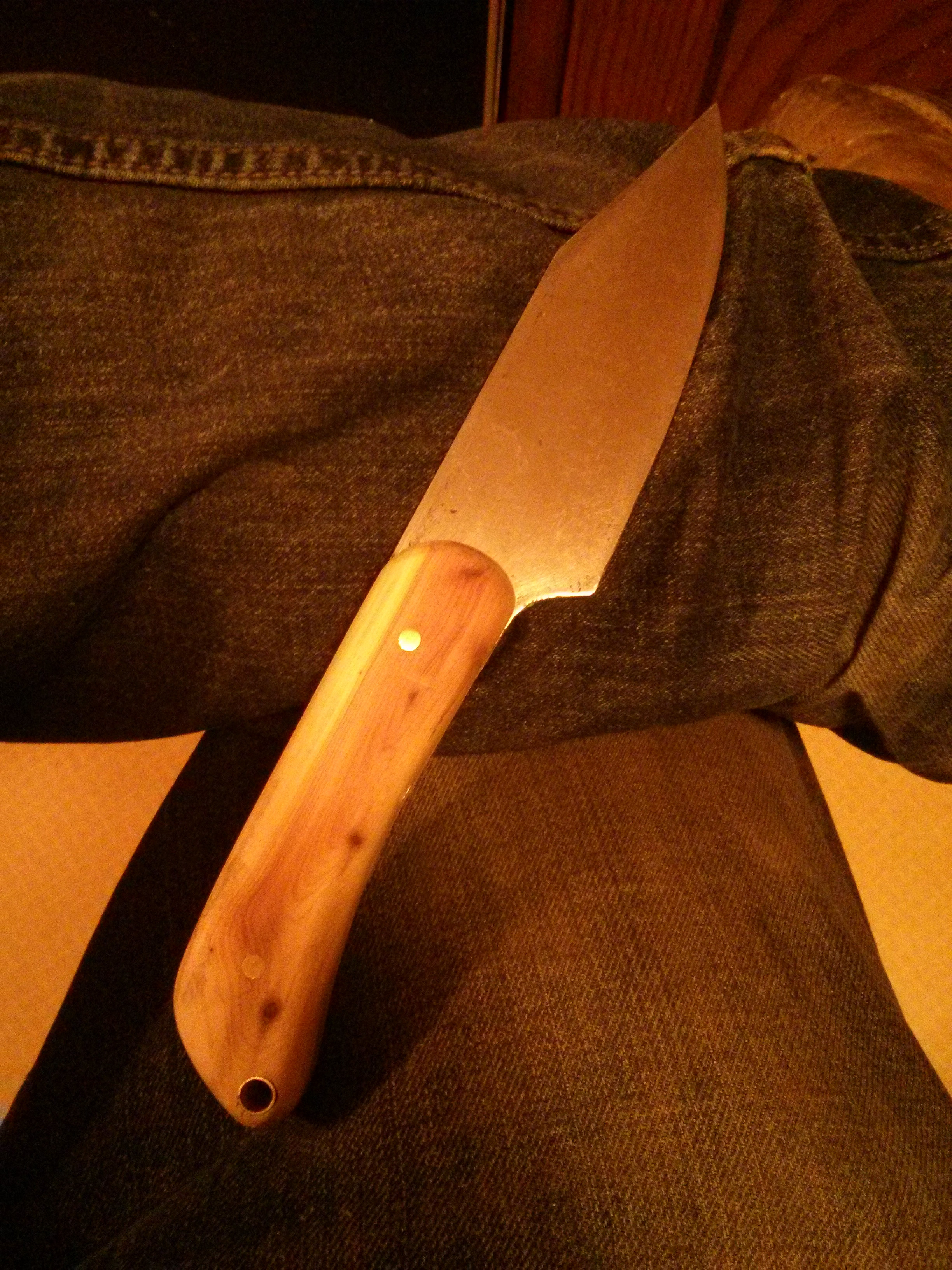

Here's the handle, everything is sanded to 400 and pinned with brass. Used cedar from a dead tree in the backyard, lol.

I'm kinda digging that shape. The lines are clean and simple, but still way cool...
Thanks, I looked at a lot of knives and ended up liking that blade shape after I drew a few on paper. I actually did it all in one day; its obviously not much of a knife, lol, but overall it didn't take nearly as long as I thought it might.

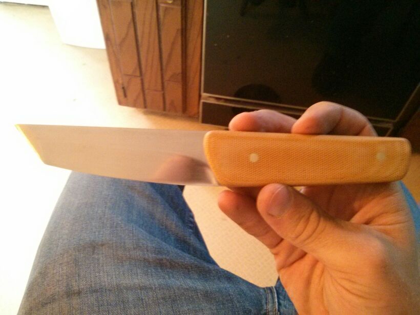

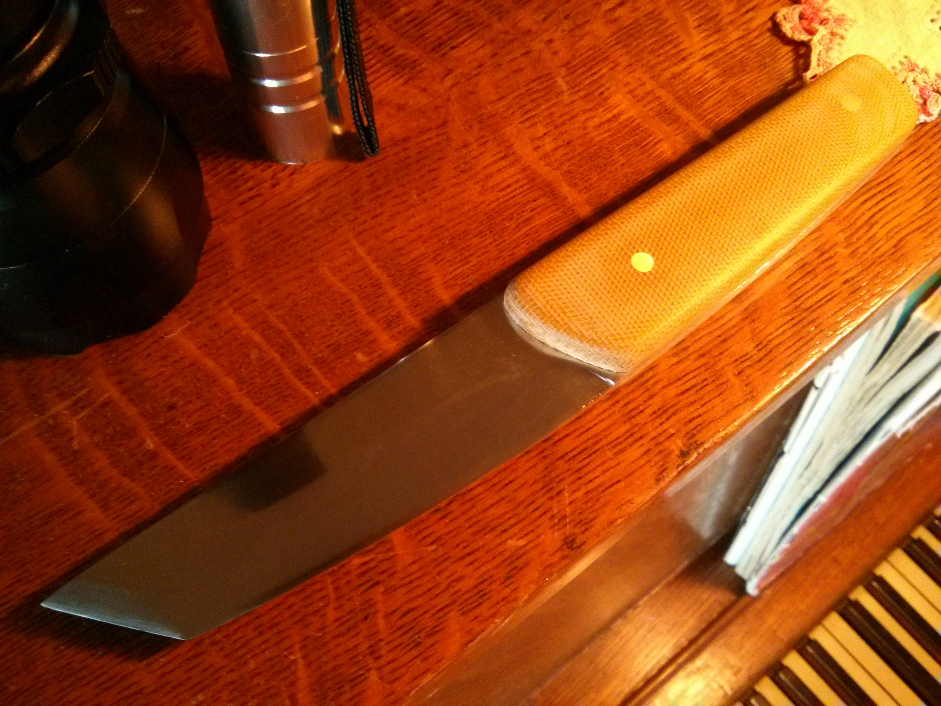

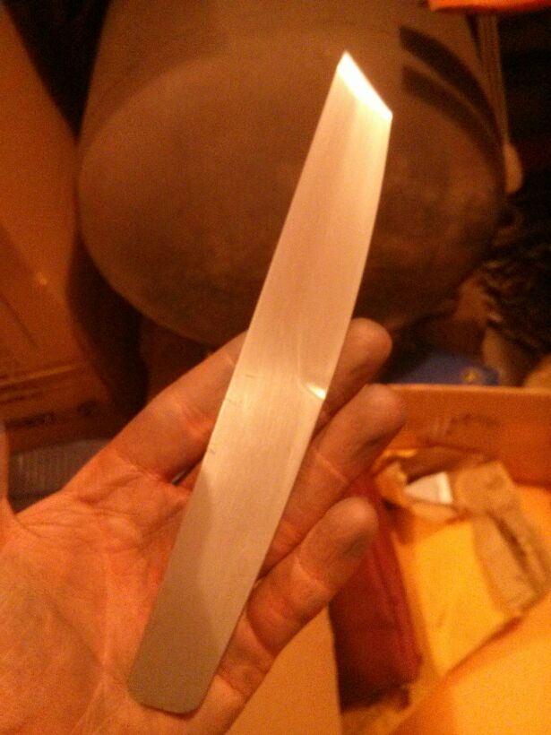

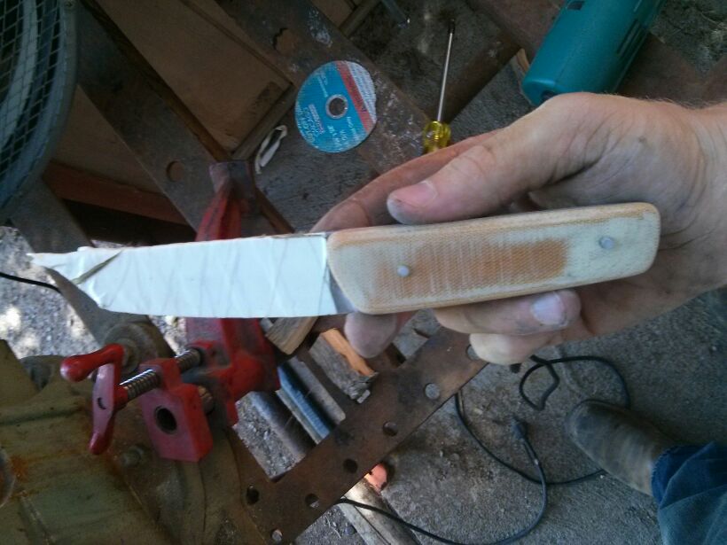

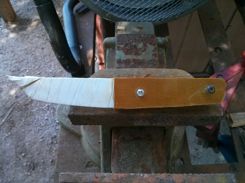

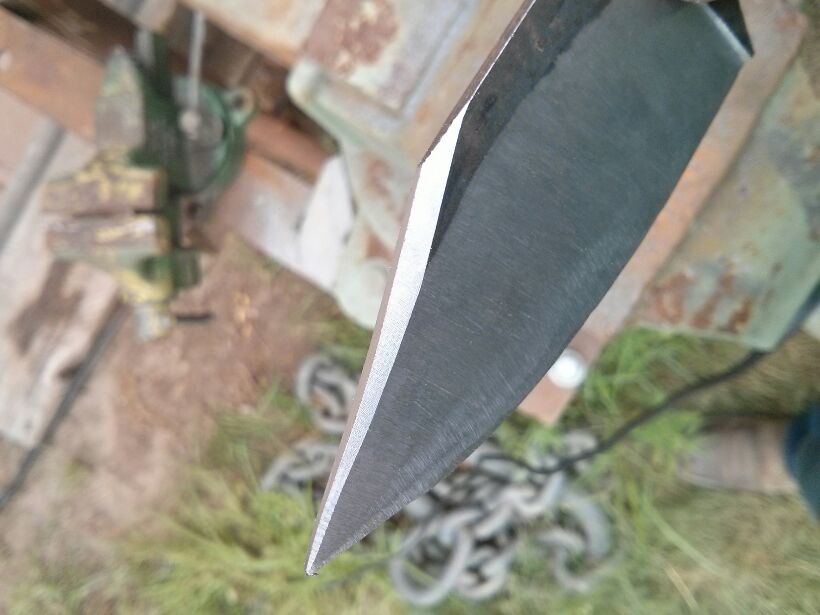

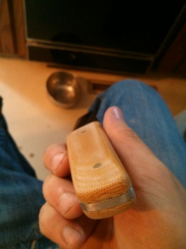

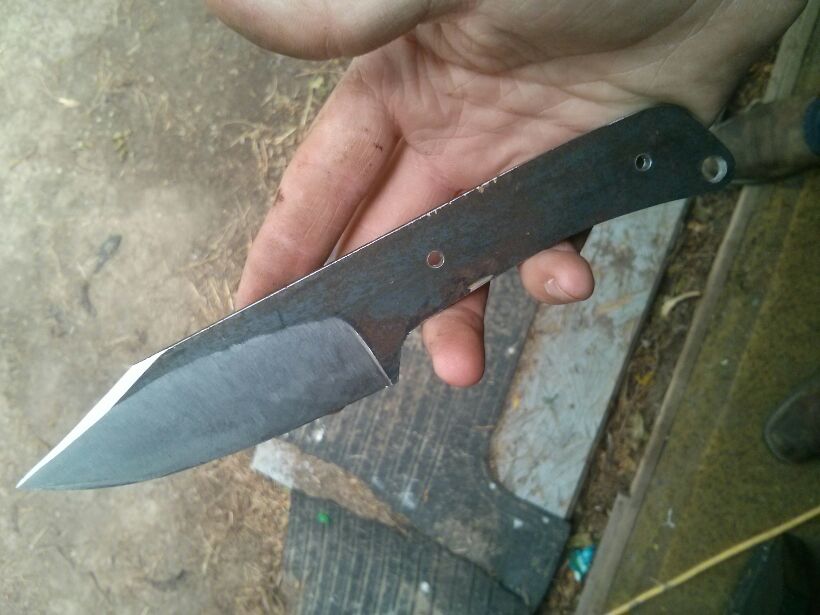

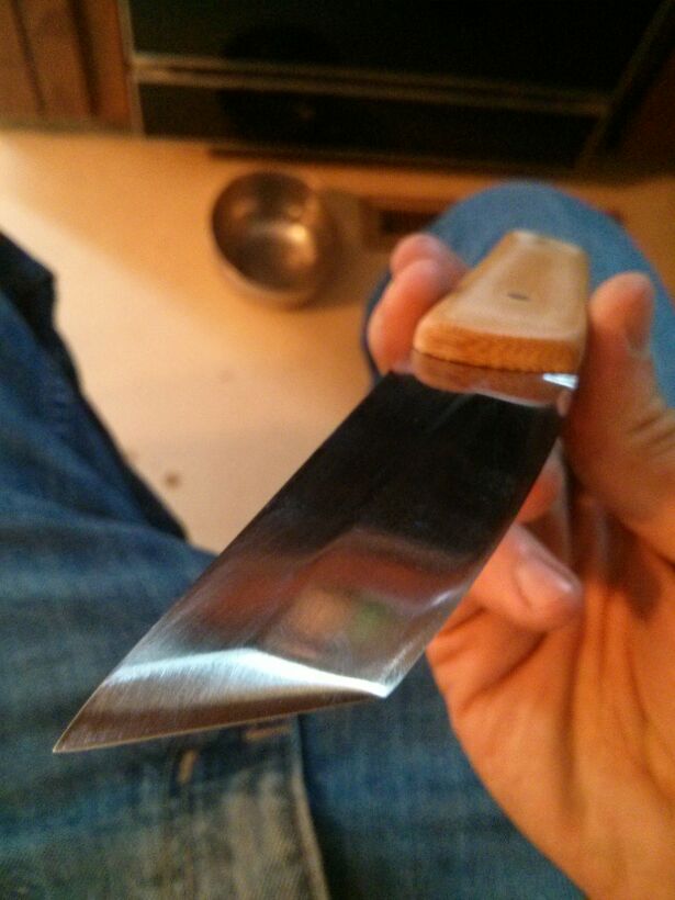

I got a few feet of ⅛ inch 1084 and some micarta a couple days ago to start off with. I spent the last few days working on a tanto. Pictures below; its not perfect by any means, but I'm pretty thrilled with how it turned out.
Before heat treat, finished filing and sanded to 600
After heat treat, starting on handle
Almost done sanding handle...that micarta is tough stuff
Finished knife. Pictures aren't that great
I also built a propane paint can forge, gets steel above non magnetic pretty easily. To heat treat it, I heated the blade above non magnetic for a couple of minutes then quenched in canola oil. Warped very slightly, straightened out easy tho. Then let it air cool to room temp and popped it in the oven at 400 for an hour. Its definitely harder, file wouldn't hardly cut it.
