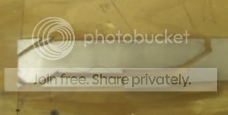

Here it is after the majority of the Hacksaw cuts

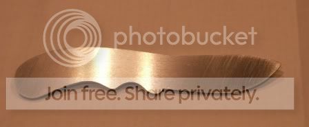

After my hand filed shaping

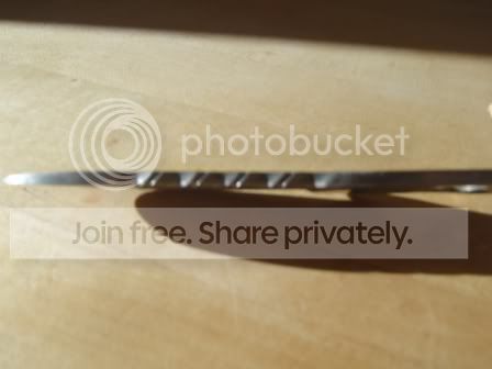

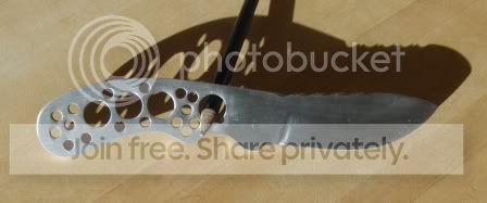

A little embellishment, and traction for my fingers
And finally the overall, I still need to go back and resand out a few scratches.
This knife is basically a blend of my three favorite skinning knives, and is my own design. The steel is 1/8" CPM154, and the handle will be Olive Burl held on by 2 brass corby rivets. Everything has been done by hand filing, sawing, and sanding except for the drill press and a dremel with sanding drum to clean burs of the drilled holes. I have filed the blade down to 0.025" and will take it to 400 grit finish prior to heat treating. The knife is 7" overall with a 2 3/4" cutting edge.
The only thing I am not pleased with so far is my transition radius from blade bevel to the ricasso. Purely my fault for not grinding a perfectly flat sided safe round file, and using a full round to finish it. I therefore have a nice round groove on each side of the blade that will likely stay as a reminder for future knives.
