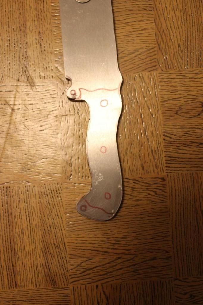

Hey zingo156,
It's your design. I only smoothed out a couple of lines that were unnecessarily complex. A lot of times distilling your idea down to it's simplest and most elegant form is the answer. And that's all I was suggesting to you. I don't say that my suggestions are the way to go or that it doesn't need additional refinement. That is for you, the artist to determine. It was more of a suggestion of how to look at your drawing when trying to see what your design needs or doesn't need. Always ask yourself why. Why does that line need to be like that? What purpose does that feature or line shape serve? If you can't find an answer to that question, or if the answer is "it doesn't need to be like that" then change it. Just remember that whatever you make has to work comfortably in a human hand. If it is an awkward shape it will likely feel awkward in the hand. If the edges have pointy areas or sharp direction changes it will likely cause hot spots on your hand in use. There is a reason the vast majority of handles have shapes or features in common. Don't try to reinvent the wheel. That said there is still room for creativity and innovation. If you can combine practicality and comfort with some style you are doing fine.
