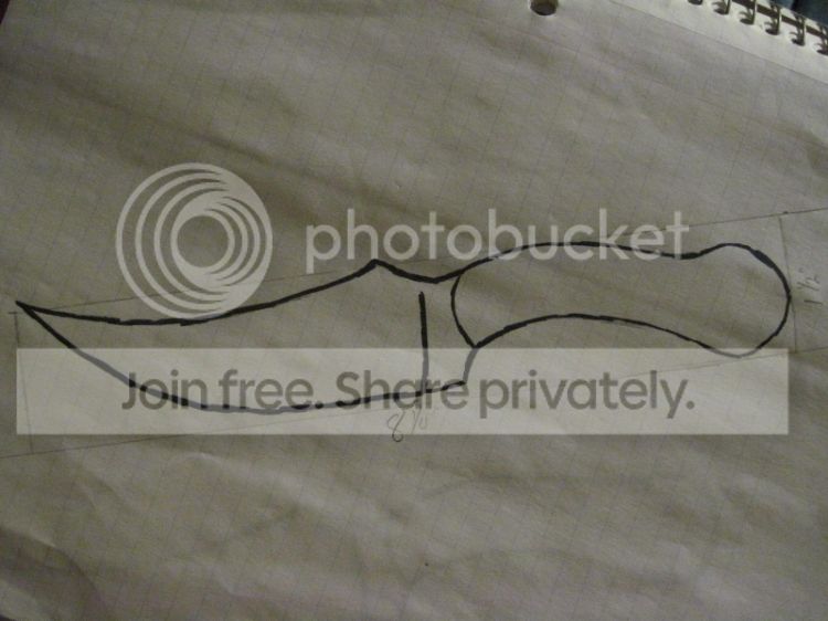

This is my first knife project, and I'm planning to use mostly hand tools. I'm planning to make a hunting/skinning type of knife. I'm wanting to order supplies from knifemaking.com, but want to get some advise from some more experienced knife makers first. I was thinking to order the 1095 3/16" x 1-1/2" x 18", because its cheap, and hopefully easy to work with. Also I thought I would order the walnut scales that are 3/8" x 1 1/2" x 5". My questions are... Do I need a liner between the tang, and the scales? Can I use the brass or nickel handle pins they sale, and if so, what size would you reccomend my planned design. (I'll add a pic here) Is there a better way to attach the scales to the tang? And last, I have access to a kiln, but wondering about quenching oil. Is there a cheap alternative, that is still effective? Thanks in advance for the help. If I'm overlooking something else, please let me know. Feel free to be as blunt and strait forward as need be.

While a drop point hunter will be a far easier first project, the size you have drawn seems OK. That blade shape and tip will be a bit of a task to get right. You might want to take that bump off the end of the handle top.
The materials you listed should work fine. You don't need a liner, and brass or nickel pins are good.
How do you plan on the HT?
If you dont want to have to ask these guys a million questions on heat treat you should get 1084 or ship out for heat treat
Thanks, I really appreciate the help, and so quick. I have access to a kiln, that I can program to heat however I need it to, and them quench in ? Oil ? just not sure what kind of oil will work. I figured I'd look up the specs on how to heat treat the 1095, Like heat to 1450 for 10 minutes, quench, then back to 400 for an hour, or whatever. I'd really like to somehow either take the hardness out of the tang, and spine. Or not harden those parts. I know its doable, because the old sword makers used to, but that might be a little much for my first build. I'm not sure the process. I'm also a little worried about the grind for that point, but I'll just take my time, and get some good hands on. I kept making that bump on the handle bigger and bigger, because it didn't look balanced on paper, but I guess the feel is more important than looks. I also though about a smooth dip, where your pinky would be, but never drew it in. Also I'm scratching my head on the placement of the pens, and how many. I was thinking 3. Whats your opinion? Any other advise would be much appreciated.

1095 isn't all that forgiving. You have a really short window taking it out of the kiln and quenching it. Heated canola oil can work, brine is a quicker quench, but there is the risk of cracking the blade. With the Canola oil, you may not get full hardness. If you have a kiln, why not try O1 if you don't want to use the 1084? Its oil quenching, and relatively easy to work with. Its more expensive than the 1095 though. HT isn't as easy as it seems. I have three broken blades from my learning experiences. 2 of the breaks made sense to me, but one has me scratching my head.

OK, guys, hoe you haven't lost interest, after some consideration, I think I'll opt for the 01, its what I had in mind to start with, and the 1095 kinda has me spooked. I want to give the step by step plan, that I've written out for myself to follow, and would like some of you to critique, and discuss the steps, so I further understand what I'll be doing. I'm ordering this stuff from Knifemaking.com ( Jantz Supply ). The steel is 3/16"x1 1/2"x 18" 01 tool steel. I'm using a kiln than is used for sample brick making.
#1 (optional) Normalize the steel, by bring it up to 1550-1600 degrees, and letting it air cool. Question, how long should I hold it at temp? I was thinking about doing 1575 degrees, for 30 minutes. ??
#2 Annealing the steel, heat to 1400-1400, and reduce heat slowly. OK, I could program the kiln to heat to 1425 hold for 20 minutes, drop to 1375 for an hour, then drop to 1325 for an hour, 1275 for an hour, all the way to 900 degrees. It that a good way to go about it? I really think, since I'm using a file for most of the work, this is an important process. Advise appreciated.
#3 cutting out, and shaping the blade. I won't really get into that yet. Just using hand tools though. Don't bring edge too thin, before hardening right, leave about 1/8th inch think??
#4 Stress relief Is this something I need to consider, since I'm using hand tools?
#5 hardening, I hate to make it sound so simple.... I planned to bring the blade to 1475 degrees, for 30 minutes, and very quickly quench in oil, that has been heated to 130 degrees. ??Hold for a few seconds?? not sure how long, and straight into tempering. Questions, it there any reason to heat and quench twice, and how long do I hold in the oil?
#6 Tempering, as soon I finish quenching, I would put it in the oven at 425 degrees, for 2 hours, let it cool, and back it the oven at 475 for 4 more hours.

the steel from jantz already comes annealed. also I would do a cardboard mockup of your design just to make sure you like the way it feels in your hand. I'm working on my first couple knives and the cardboard cutout really changed my handle and blade shape.
You can start by annealing it, it can't hurt and might help. Put some charcoal in the kiln to help prevent oxidation. Also, you might want to shield your blade from the coils to help with radiative heating. After you shape your knife you will want to normalize before your final quench. See this thread: http://www.bladeforums.com/forums/s...Size-and-Normalizing-WITH-UPDATED-GRAIN-SHOTS . This is all the stress relief you will need. After your final quench, 2 x 2 hour tempers at 425 should suffice. Sharpen the blade and test the edge. If it is too brittle, you can temper again at a higher temperature.
I use 01 and I normalize the steel, soak for about 20 min, quench in canola oil about 110 deg. moving the blade around. Then I temper at 390 three times for one hour each time. That gets me 59rc.

My first bought steel was O1, (I have only been at this for about 6 months) since it was the only knife appropriate steel at the local steel supply store. Regarding the tip shape: I made three that were similar, one turned out OK, one broke in heat treat, and the third is turning out quite nice. That tip shape is much harder to grind evenly, and look good while maintaining appropriate material thickness. If you are up for a challenge, try it out. The worst that happens is you waste a few bucks worth of steel.
