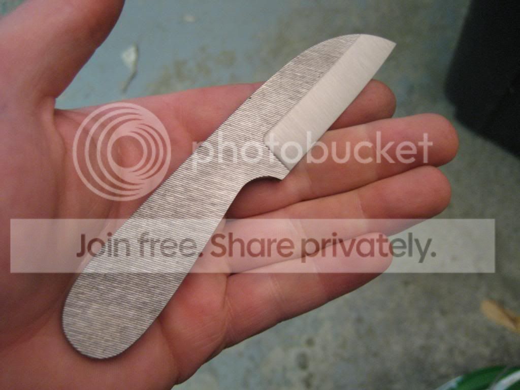

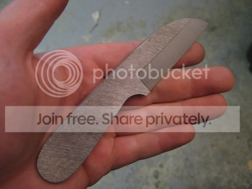

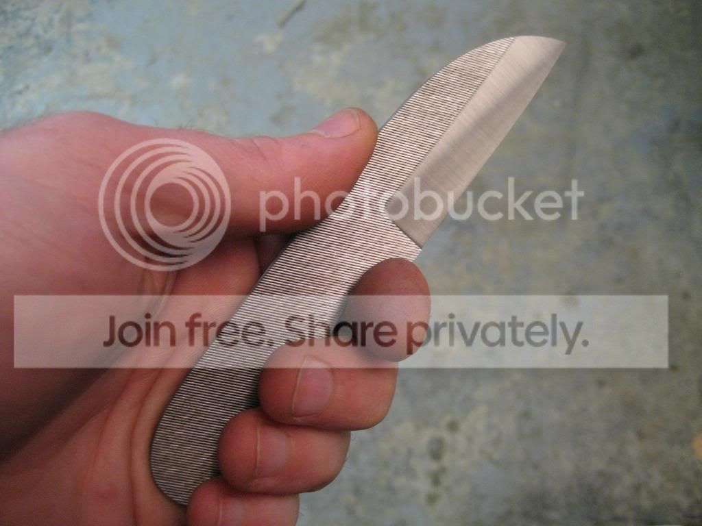

Anyways to get started on my first knife I felt like making a small sheepsfoot style knife. Something that I could make fairly quick and get into the process of grinding blades. I was going to get some 1084 flat-stock ordered for NJ Steel Baron, but they are backlogged, so I just used an old worn Nicholson file from my shop. One of these days it would be nice to get an order in for some 1084, but until then I will make a few knifes from the pile of old files I have in my shop. Only problem with that is it limits the size of knives I can make.

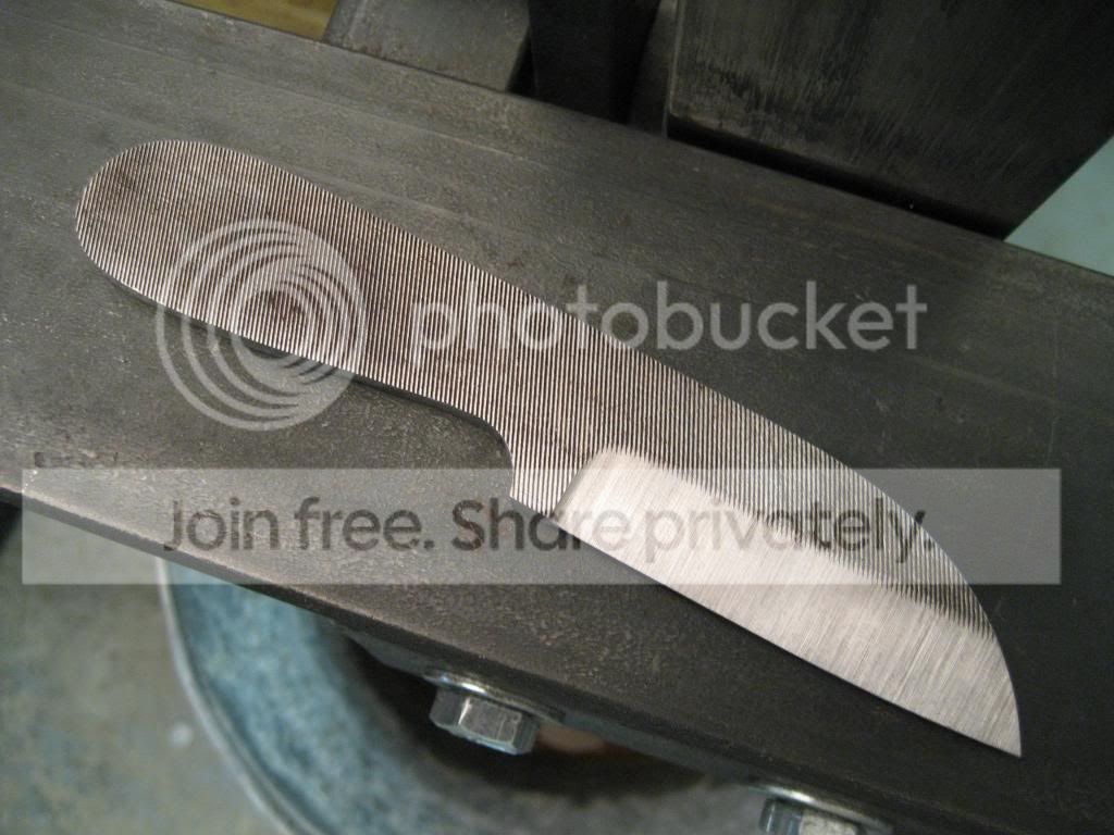

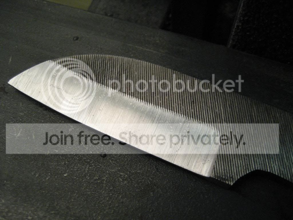

Anyways here is what I have so far. I wanted to leave some of the old file marks to show the knifes pedigree. Maybe it would be better to grind them off but I think it adds a little pizazz.
Here is where it is as now.
This was before hitting it with a 120 ceramic belt.
Picture showing the grind so far. Is this far enough before heat treating?
Here is a shot showing the general size.
Comments and constructive criticism is appreciated.

Hey Dave -
Glad to see you working with your new grinder. Killer job there BTW. Thanks for the 2yr follow up on that thread – was starting to think aliens got you or something.:eek:
Your file knife looks solid so far. Great grinds for a first go-round on that machine. I’ll offer some thoughts and your may use or toss at will.
Most knives, even at this small scale, can benefit from a continuous slight curve to the spine; from point to butt. It’s both functional and aesthetic in many cases. Study.
The choil at that radius will likely tell your index finger to lose weight if you work this one hard. Suggest you open the choil to a 0.75”+ minimum radius.
Your current edge can go a lot thinner depending on your HT resources. Most makers will take CS edges down to 0.015 to 0.020” and finish laterally to 400 to 600 grit before HT. There’s a lot of variance in this setup among makers and it doesn’t seem to matter as long as you understand why you do what you do IMHO.
That steel in unknown so the ideal HT will just be an educated guess at best. What HT and quench resources do you have at hand now? That makes all the difference as I’m sure you have already figured.
Finally, look at how far the file’s tooth cuts make their way onto your bevels as is. On top of that the steel beneath each cut is seriously jacked with during original production. You will likely find the diagonal tooth “tracks” extending further into your fresh ground bevels upon a simple FeCL etch. That tells you something about whether they should ideally be removed or left for character. Also tells you about the value of a solid normalization protocol before quench. More study.
My easy guess is that you are very competent in the shop and just have to keep patiently working till your personal vision catches up with your hand skills. In the meantime become your own worst critic and never ignore a known problem, error or shortcoming on a tool if it is intended for another person (whether a gift or a cu$tom). You may not be able to do anything about it this time but there’s always the next one.

Thanks for the compliment on the grinder. I still need to post more of the build pictures but now I am sidetracked with putting it to use. Hehe. Yes I see what you mean about having a slight curve on the spine. I had thought about that but was unsure if I should take more off the handle as it is already fairy narrow due to the limited steel width from the file. Maybe I could take a little more off of the blade side and a smidge on the handle side to give it a little more curve.
Right now it is has a radius of .280" as I used a sanding drum of .560" diameter. I do not have a small wheel attachment at the moment for the grinder, but I think I could manage a larger radius with a small sanding drum in my Foredom rotary tool. You mention a .75 radius. So you are suggesting a 1.5" wheel to make the choil? That seems awfully large. Or do you mean a .375 radius / .750" diameter wheel?
OK, I was thinking it could go thinner but did not want to take it too thin before asking here. I believe I measures it at .058", or somewhere around that as I didn't write it down. So I can thin it out to about a third of what it is now.

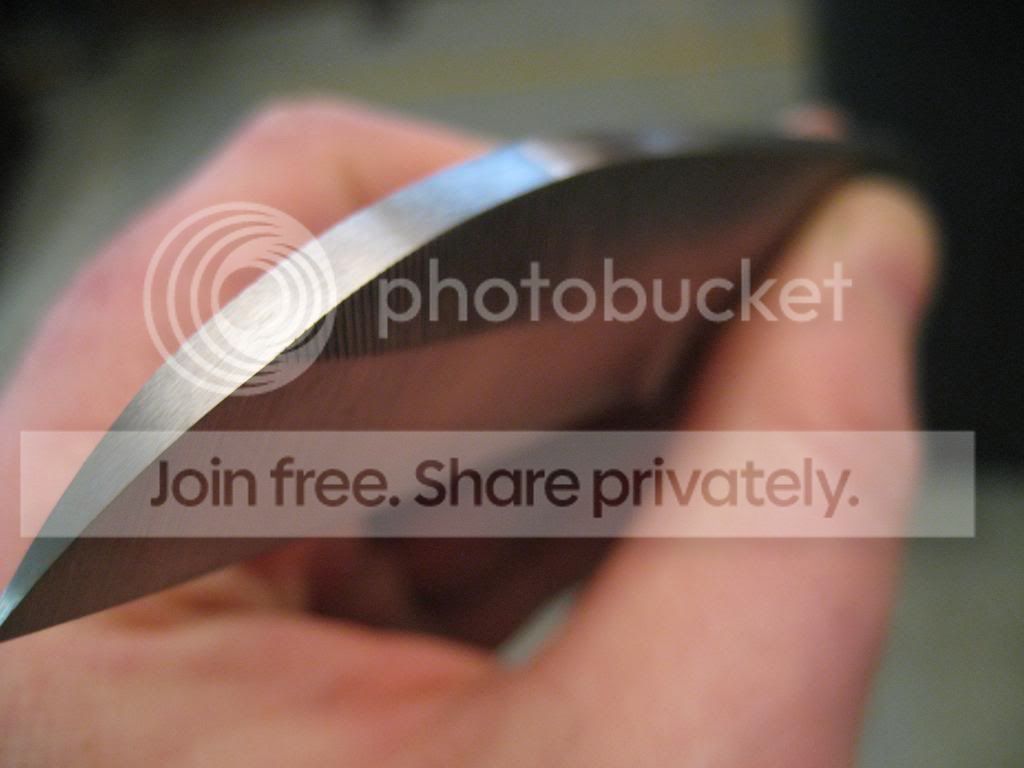

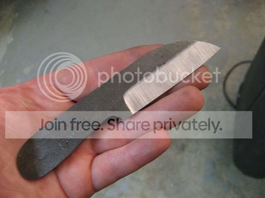

Thanks Andy. I did some more work on the knife and was going to post some pictures but my camera battery died. So I will get some up tomorrow.
Anyways I opened up the choil to a 13/32" radius which is a 13/16" size drum. I actually just used a 1/2" drum in the rotary tool and nailed a perfectly round radius. Good eye I guess. It feels better now.
Not knowing if it is 1095 or W-1 I think I will just do an oil quench and check for hardness. If it is W-1 it will not get as hard since it is a water quench steel, but it might be best to play it safe. If it does not get hard enough it might be W-1 or 2 and need to be quenched in water. I guess I wont know until I try.

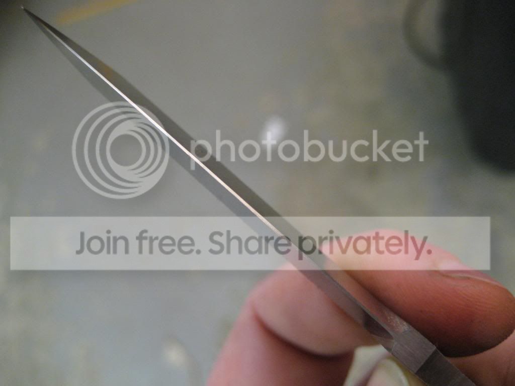

I took the file down in thickness a little bit more. I still kept the file cuts but they are a lot more shallow now. I do not no much about Michael Morris, but he makes a lot of knives like this with apparently no ill effects.
Thanks,
Dave
Oh, by the way the edge is actually ground down to .025" not whatever I said previously. :rolleyes: So I should probably be good stopping there for heat treating?

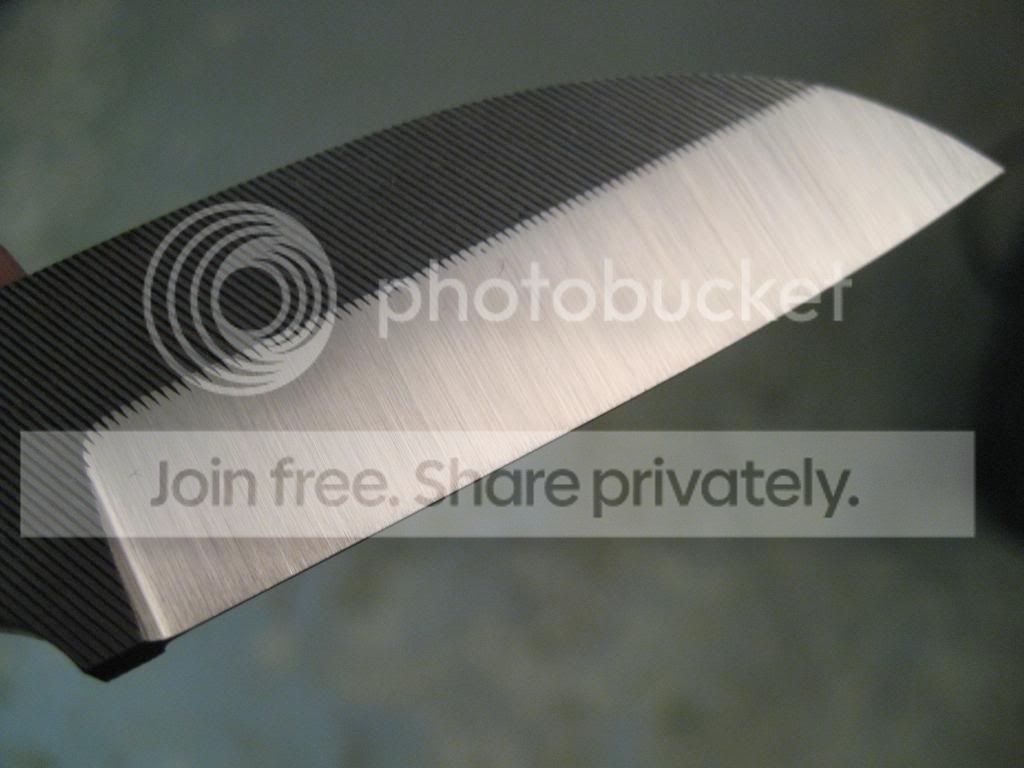

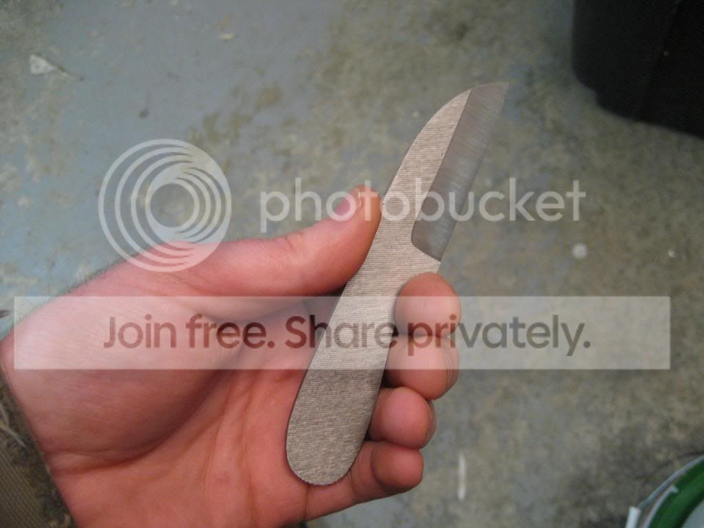

Ok so here are some updated photos. I have the bevel and edges sanded down to 400 grit and the edge thinned out even a little more. I need to drill the handle for the scales. Not sure if I just want to use pins or Loveless bolts. I am leaning towards the Loveless bolts for more durability. I was thinking of doing the opposite of what is typical and do a brass screw with stainless sleeve. Just to be different. :D
Here are a few more pictures.
Thanks again for checking it out and feedback or suggestions are more then welcome.

Dave,
I think that looks awesome. Fantastic grind lines - looks like you've done this sort of thing before. I didn't think I would, but I really like the file lines you left behind.
I have no idea on HT - but a buddy at work has done a 1/2 dozen or so file knives. I'll see if he's done any on a Nicholson and has any advice.
He generally epoxies a wrap over the tang. I think wood would look and work a bunch better, but he's resluctant to grind his own scales. (Or, maybe, buy a piece of wood?)
Your choil cleaned up nicely. In the first shot I thought the guard was a little big - flows more nicely now.
I know you were thinking r.75 on the choil is big. I tried using a 1" D drum on my BK"151" 11 Necker mod, but it didn't hit it right. I wound up using a 2" D Drum, for a 1" radius. It's a little bigger than necessary, but it looks good to my eye and feels great, if excessively roomy, to my hand. I'd love a .75" radius choil. But I have big hands, and can be a little clumsy.
Fantastic first effort. I'd be very proud of that little guy. I hope you get the HT nailed down so it serves you well for a good long time.
